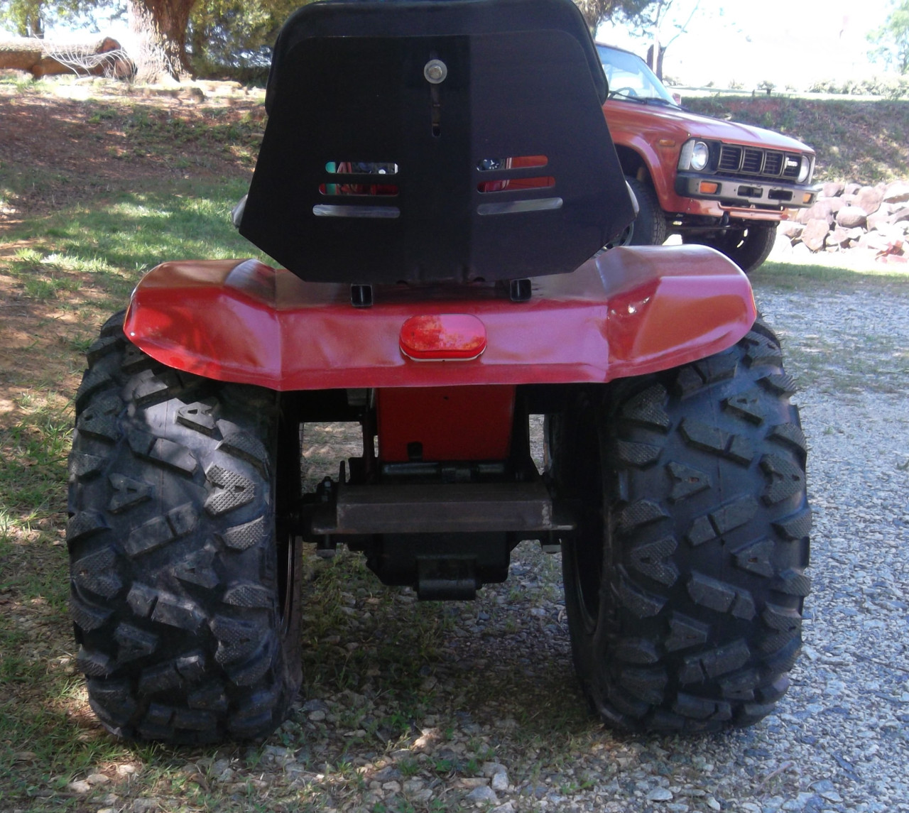

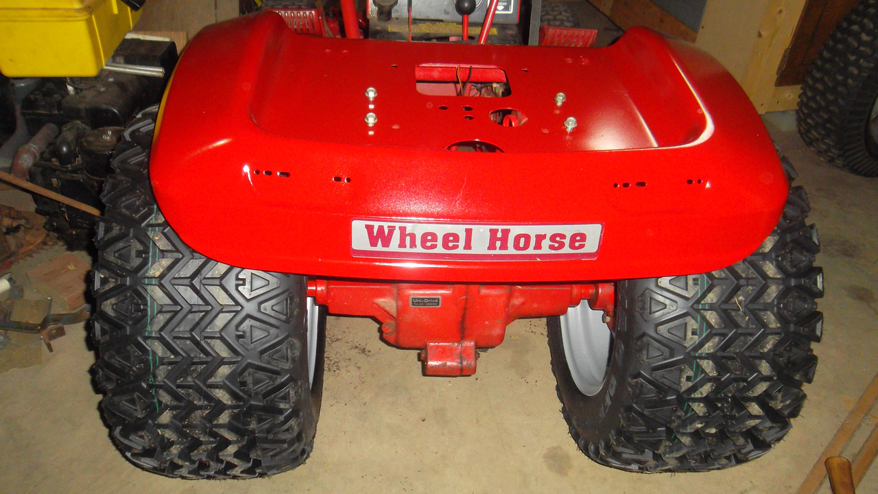

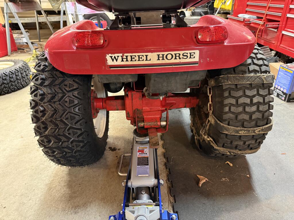

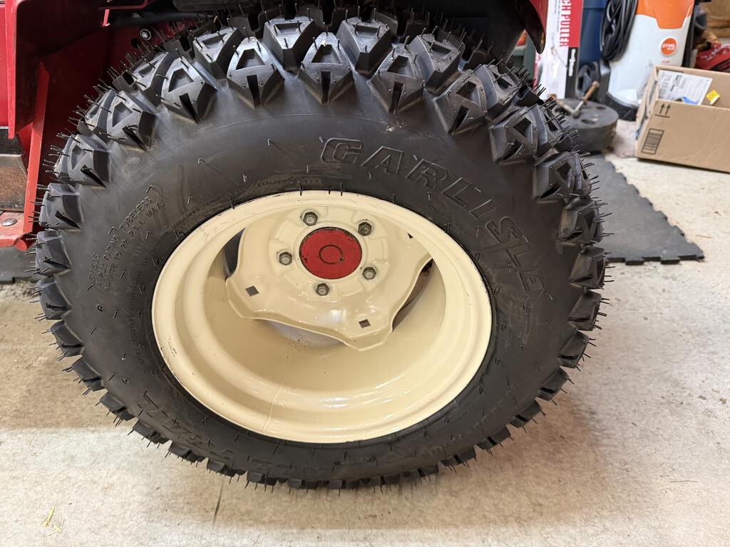

 I did the last 12" 4 ply's on the floor but took 6ply 25x10x12 to the local tire shop. He has one of thoes automatic tire machine. It does 12" to large truck tires.
$20 for two tires. No way I would have got them on.
Got the same deal on these OR 10.50's

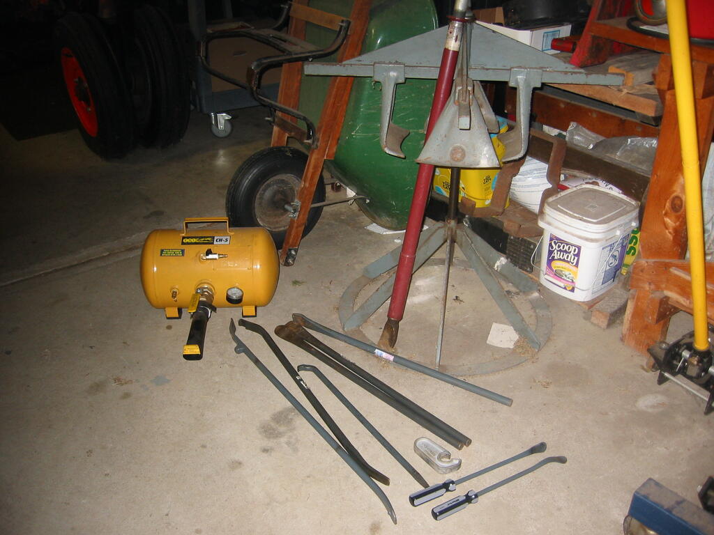

I have a piece of 3/4" threaded rod through a hole I drilled in my workbench that i can secure the rim to while changing a small 6" or 9" tire. I use the large Harbor Freight tire changer to break the bead first.

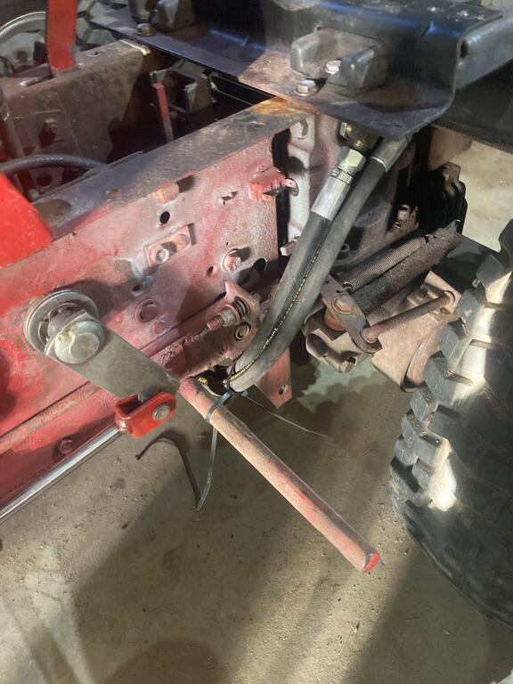

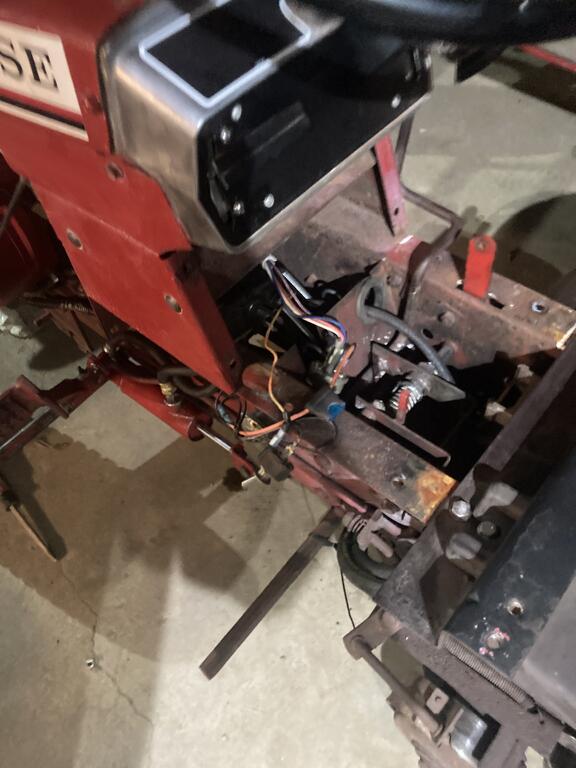

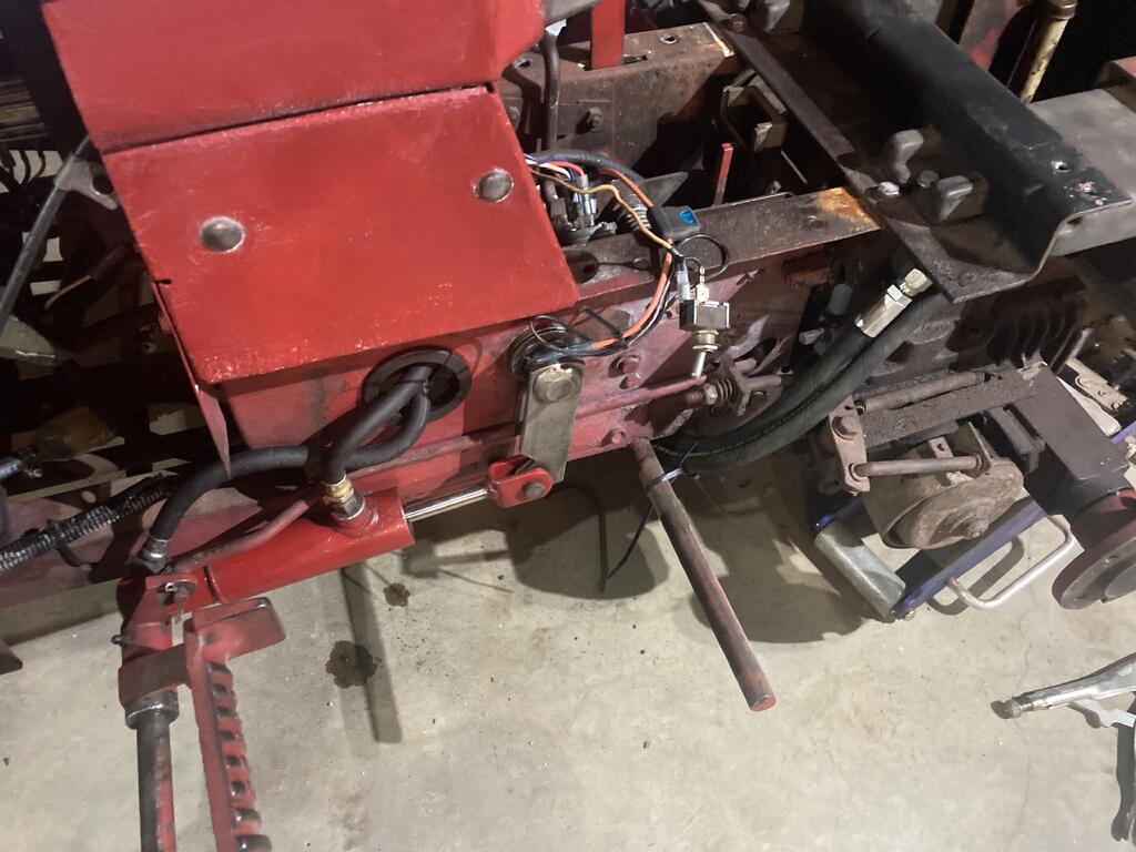

After a week and a half of parts gathering, and tons of research I got the last piece to the hydro lift. It was the 36” 3/8 JIC hoses for the main supply hoses. I had a small leak in the system and after two weeks+ of sitting I had to boost the battery to prime the tractor to test the system. I think I still need to do some tweaking and build some small parts. It was a promising first test as the ram moves.

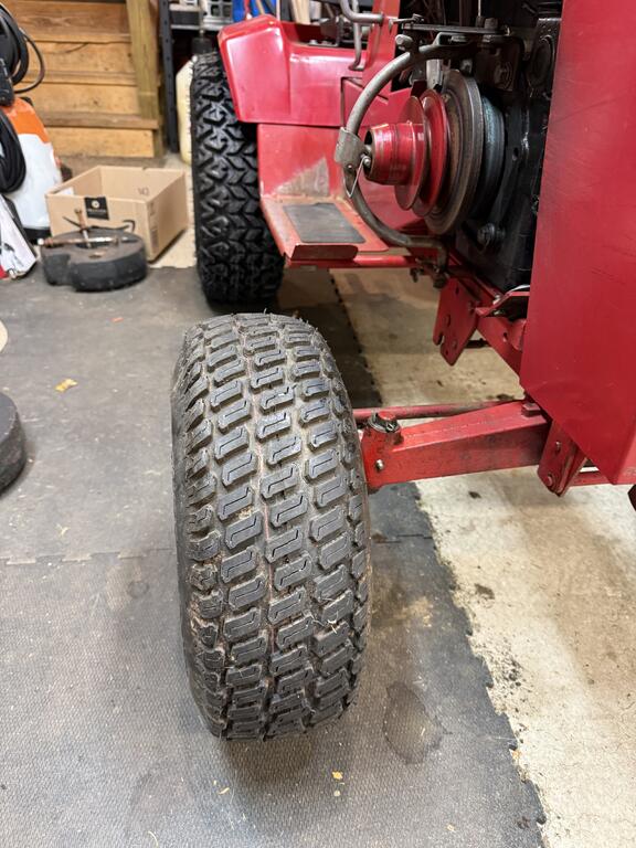

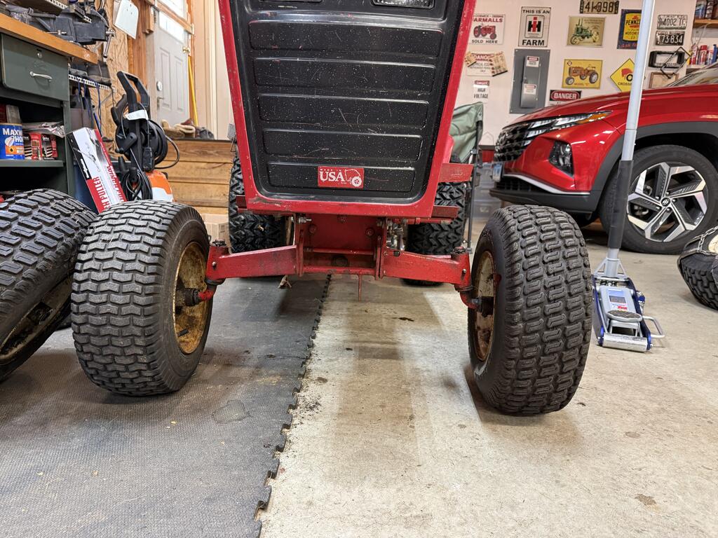

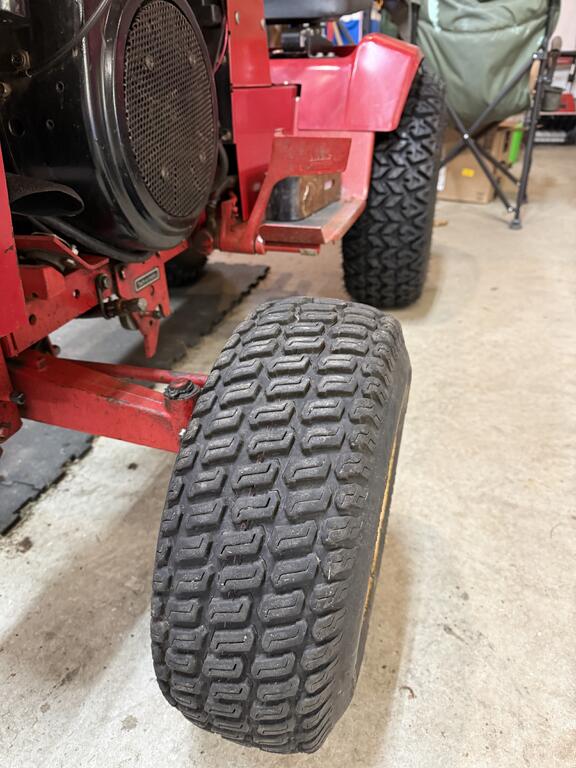

The fronts on the C-145 are severely cracked and leak down…in stock here I had a pair of 18x6.50x8’s on WH correct wheels that look great! And the extra inch of height over the stock 16x6.5’s will work well to get the plow up a bit more.

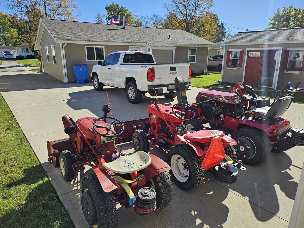

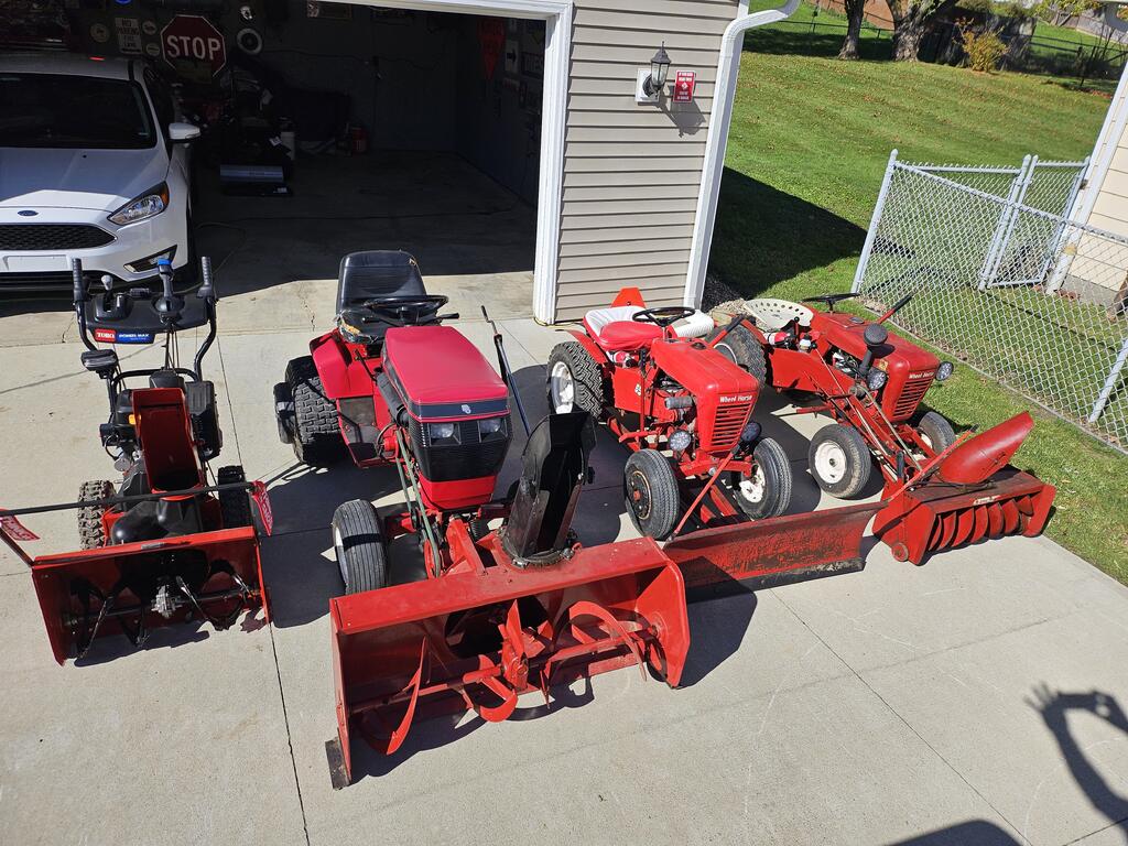

I have four blades staring at me. I can mount two onto a 520, and a C141.
Also onto a Cub Cadet and an Elec-Trak.
Thinking if I mount all four it won’t snow this winter.🥶
If I do push snow the 520 with a 48” blade is my first choice.

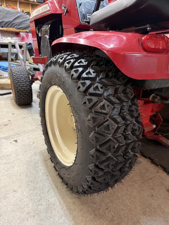

  Hung the new winter/plow tires on the rear of the C-145 Auto today.
  Can’t push snow without weights, really going to bother me to scuff up the new wheel paint but that’s life :(
Just fluid fill them. Same amount of weight without scratching the paint.

 Yes and no…I don’t want these tires “weighted” all the time. Would rather have the cast iron weights that I can remove in the spring and set this machine up for mowing.
  I suppose I could have a second set of rears without weights and swap out that way.

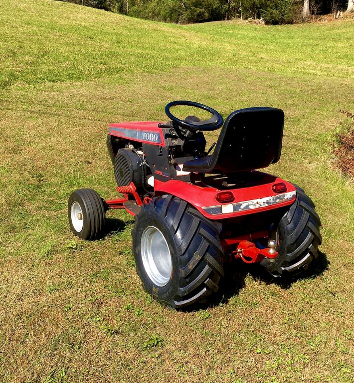

My main mowing tractor is a first gen 520H with the 23x9.5-12 rear tires and they are liquid filled.
The added weight does not cause damage to the sod but it actually prevents tire spin which could damage sod and also I have some hills and ditches to mow and the added traction helps there.
