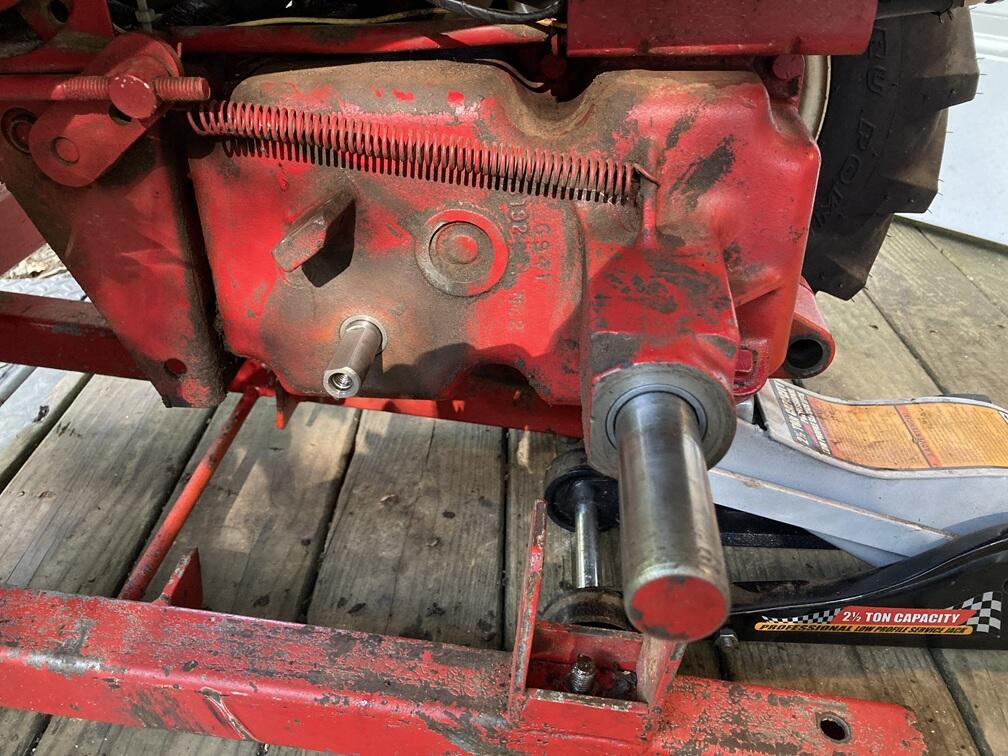

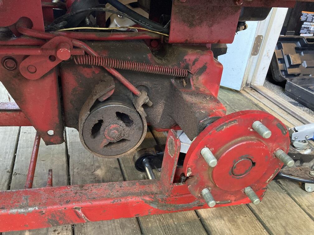

ineedanother 2,864 #26627 Posted August 21 On 8/15/2026 at 3:55 PM, ineedanother said: Did a diesel fuel flush and gear oil change on the 161 before installing the ARK for the first time. Lessons learned...black hoods are too wide to clear the hydraulic pump and a shaker plate calls for an inch or so shorter belt It's always something. Well, I said it's always something but sometimes it's a few things...brake shaft and one axle seal now leak. Replacements (and spares) will be here this weekend. I have bearings on hand but no gasket for the case so hopefully it's just seals... 4 Share this post Link to post Share on other sites
ebinmaine 80,694 #26628 Posted August 21 10 hours ago, ineedanother said: Well, I said it's always something but sometimes it's a few things...brake shaft and one axle seal now leak. Replacements (and spares) will be here this weekend. I have bearings on hand but no gasket for the case so hopefully it's just seals... Start the heat/penetrating oil cycle on those hubs now. 2 Share this post Link to post Share on other sites

ineedanother 2,864 #26630 Posted August 21 1 hour ago, ebinmaine said: Start the heat/penetrating oil cycle on those hubs now. Had them both off last month to install wheel studs and a second set screw. Probably should have had new seals on hand and done that then 2 2 Share this post Link to post Share on other sites
ebinmaine 80,694 #26631 Posted August 21 26 minutes ago, ineedanother said: Had them both off last month to install wheel studs and a second set screw. Probably should have had new seals on hand and done that then Agreed but that's why hindsight is 20/20... It's all good. 2 Share this post Link to post Share on other sites
kpinnc 18,960 #26632 Posted August 21 4 hours ago, ineedanother said: Had them both off last month to install wheel studs and a second set screw. Probably should have had new seals on hand and done that then One thing about it: they should not have had time to brown weld back on yet. Should be easier to pull them again, if you decide to. 3 Share this post Link to post Share on other sites

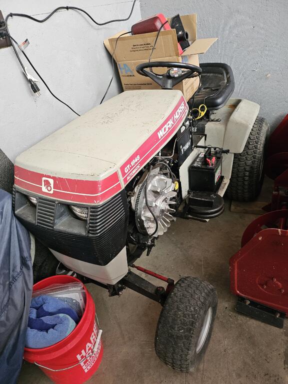

ML3 2,510 #26633 Posted August 22 Sold the Workhorse today! Guy I purchased it from bought it back. Looks like everything gonna work out, especially for me. I got the 416 now to replace it. 7 Share this post Link to post Share on other sites

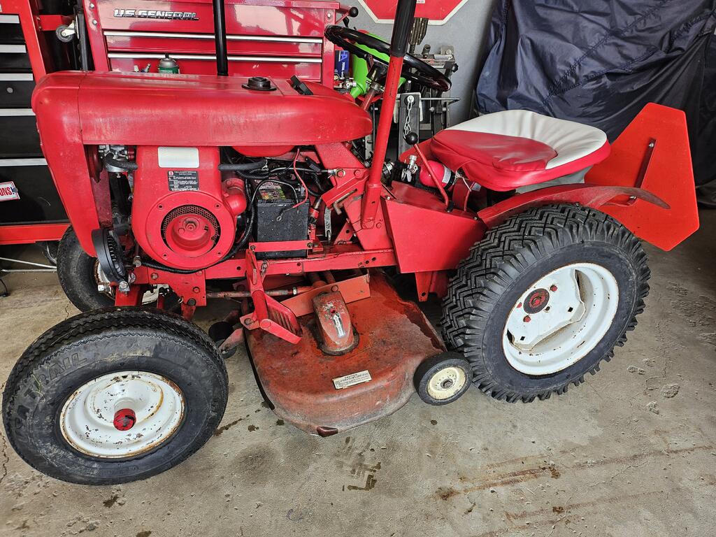

ML3 2,510 #26636 Posted August 22 Did some mid-season maint, grease, etc on 654 & mower deck. Know theres plenty haters on Teckys but mine is reliable & burns no oil. Even degreased tractor & washed it too. Its not pretty but I can count on it winter or summer. 4 5 Share this post Link to post Share on other sites
kpinnc 18,960 #26637 Posted August 23 23 hours ago, ML3 said: Know theres plenty haters on Teckys but mine is reliable & burns no oil. I'm no fan (because of the carburetors) but I think it's awesome you've been able to maintain yours. 2 Share this post Link to post Share on other sites

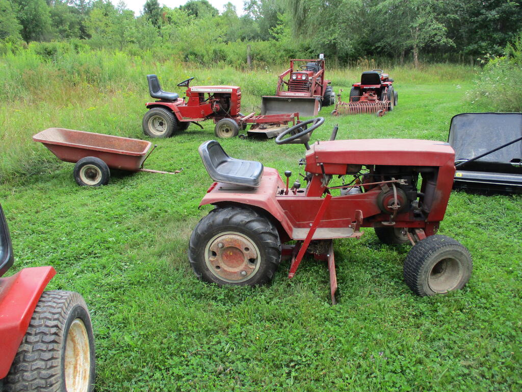

pfrederi 21,149 #26638 Posted August 23 Needed to get the york rake hooked up to work on the stump removal project. It is the only implement I have not permanently attached to a tractor. Had to move a lot to get it out and hooked up to the GT-14... Part of me says I need another 3pt tractor 9 1 Share this post Link to post Share on other sites
ebinmaine 80,694 #26639 Posted August 23 6 minutes ago, pfrederi said: need another 3pt tractor OBVIOUSLY 2 Share this post Link to post Share on other sites

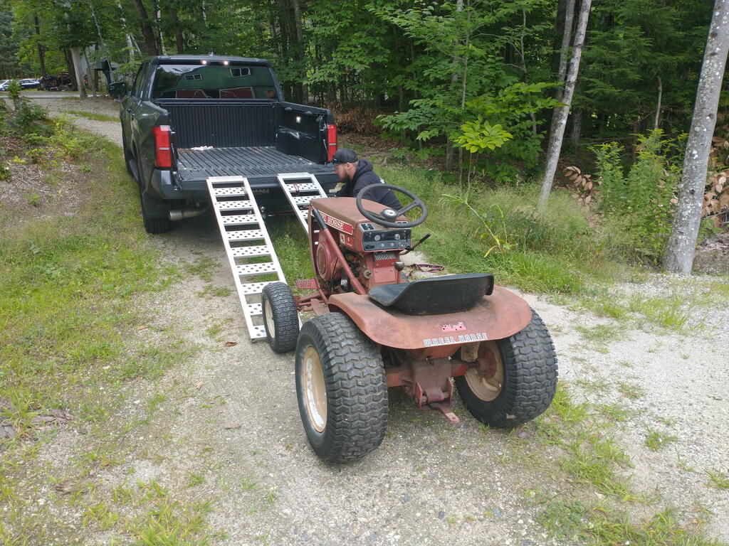

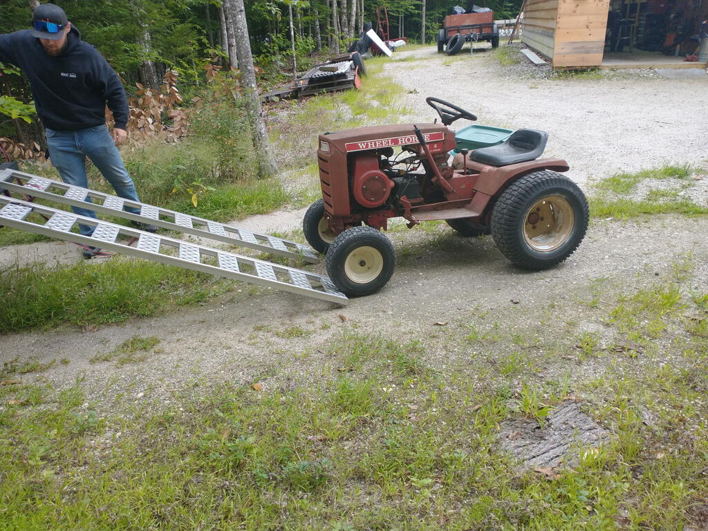

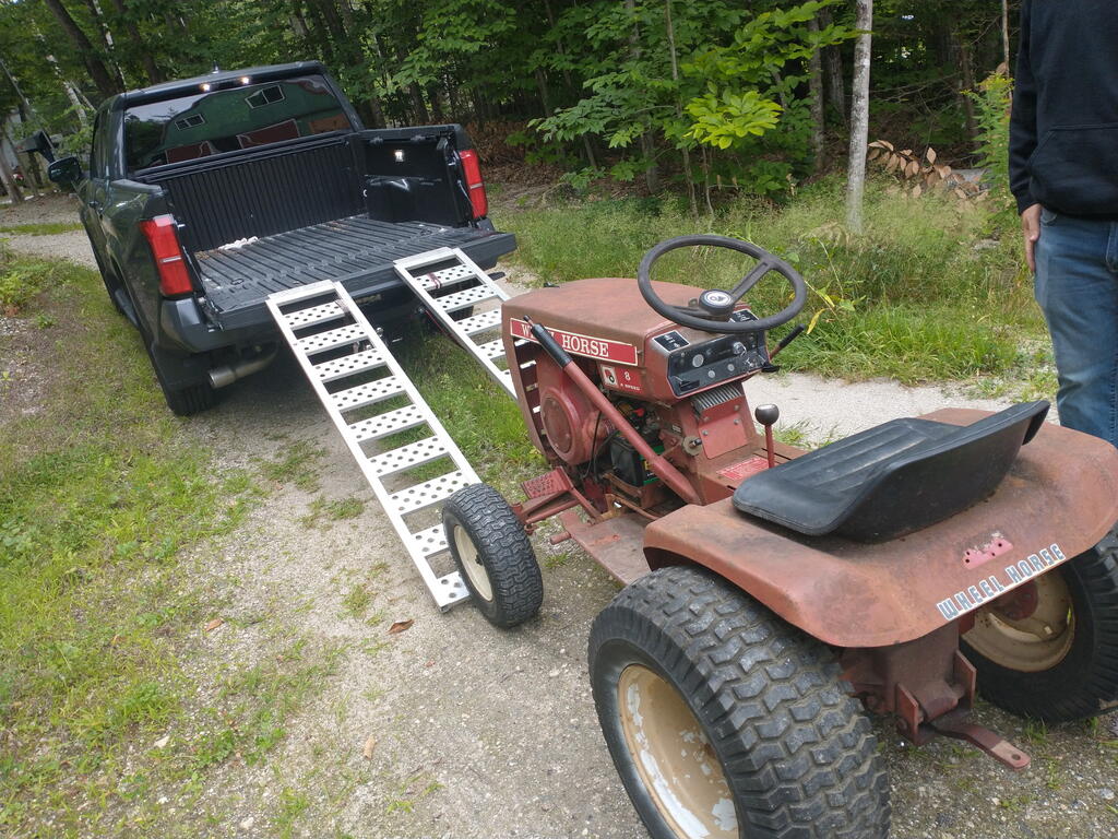

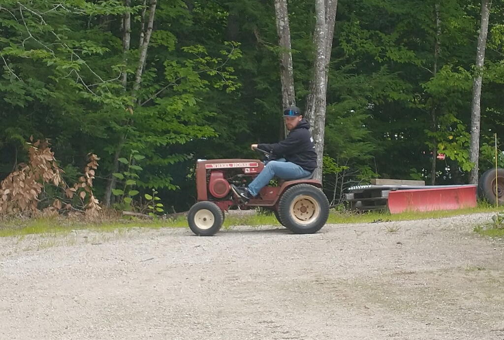

ebinmaine 80,694 #26640 Posted August 23 @Natejc_98 came by and picked up his 1973 8 HP 4 speed. He and Trina and I have been through the systems on it. Changed a bunch of stuff. Cleaned some stuff. Replaced some stuff. Today we tried to start it and immediately figured out it was getting no fuel. The original fuel pump was gunkified. Swapped for another pump but that was reeeaaally weak. OK... back to the original and clean it up. I modified a 10 to 16 HP pump rebuild kit by using a leather hole punch to change the position of the holes in the diaphragm. Reused the original internal spring. The 8 HP engine fired up and went well. We then noticed a scraping noise when the tractor was in gear. Popped the belt off and verified it against a known correct Wheelhorse 7473 belt. It was a little bit too long. Likely I has mistakenly installed a 7478 from an Automatic tractor which is an inch or whatever longer. Left the 7473 on. Nate got the chance to drive his "new" toy around here a bit and we loaded it up on his truck. Off to it's new home! 7 Share this post Link to post Share on other sites
ML3 2,510 #26641 Posted August 23 4 hours ago, kpinnc said: I'm no fan (because of the carburetors) but I think it's awesome you've been able to maintain yours. Amazon Chinese carburetor has been working fine for last 3yrs since I installed it. $14 & needed no adjustment 👍🏻 4 Share this post Link to post Share on other sites

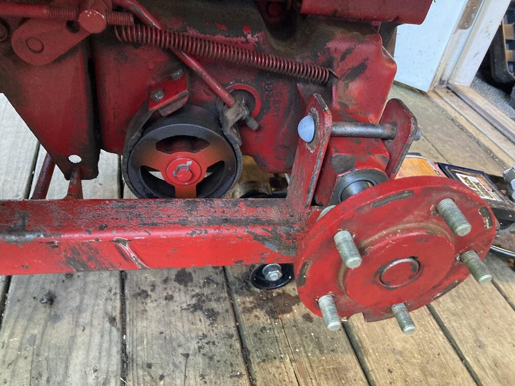

ineedanother 2,864 #26642 Posted August 23 On 8/20/2026 at 8:53 PM, ineedanother said: Well, I said it's always something but sometimes it's a few things...brake shaft and one axle seal now leak. Replacements (and spares) will be here this weekend. I have bearings on hand but no gasket for the case so hopefully it's just seals... The brake shaft seal came this morning and the bearings checked out. I had to lower the FEL sub-frame to get the brake disc off but all is well again 7 Share this post Link to post Share on other sites

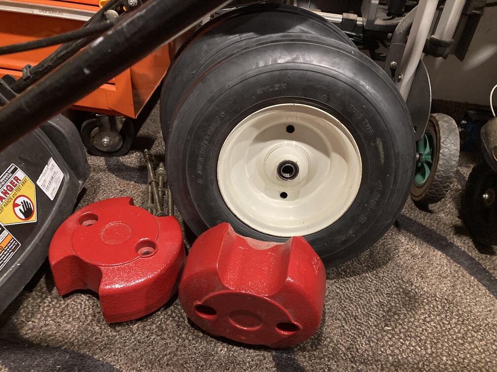

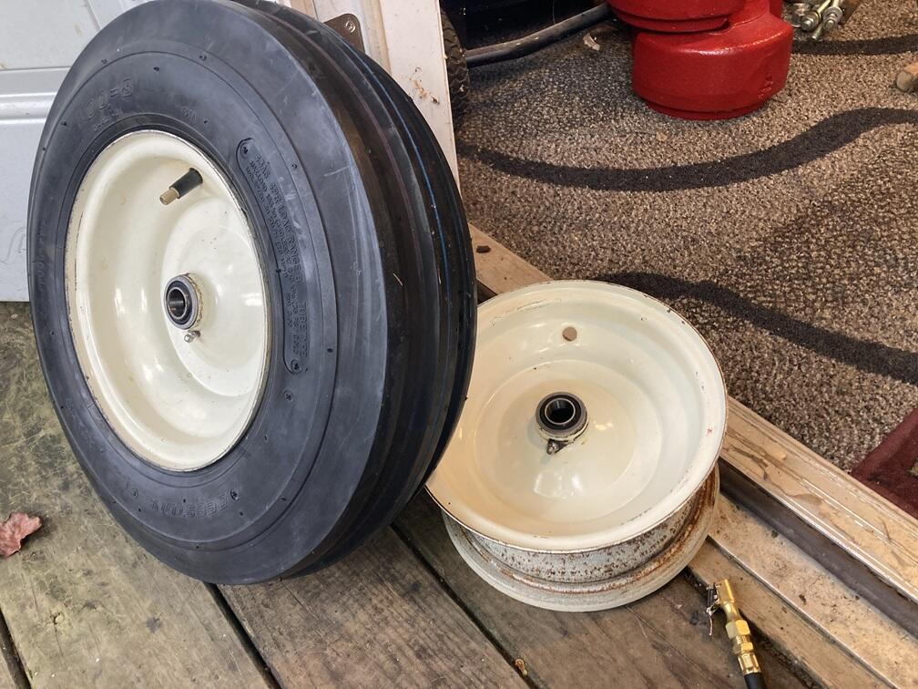

ineedanother 2,864 #26643 Posted August 24 Too much on the to-do list today to get these on a machine but did manage to drill the rims for the weights. ICYMI, these 4 x 8 rims came on an off-brand cart with bushings and dry rotted wheel barrow tires. I almost threw them on the I don't care pile but they're actually decent quality so I knocked the bushings out and put 4 ply 4 x 8 tri-ribs on them. I talked my brother out of the weights and cleaned them up. Too wide on standard rims to get through the gates on my property so I think this will work. Soon to be in service... 8 Share this post Link to post Share on other sites
ebinmaine 80,694 #26644 Posted August 24 3 minutes ago, ineedanother said: weights I have a set of those. Heavy little things. 1 Share this post Link to post Share on other sites
ineedanother 2,864 #26645 Posted August 24 4 minutes ago, ebinmaine said: I have a set of those. Heavy little things. Yes they are. I haven't weighed them but I need to get them mounted so I can stop having to move them around the shop 2 5 Share this post Link to post Share on other sites

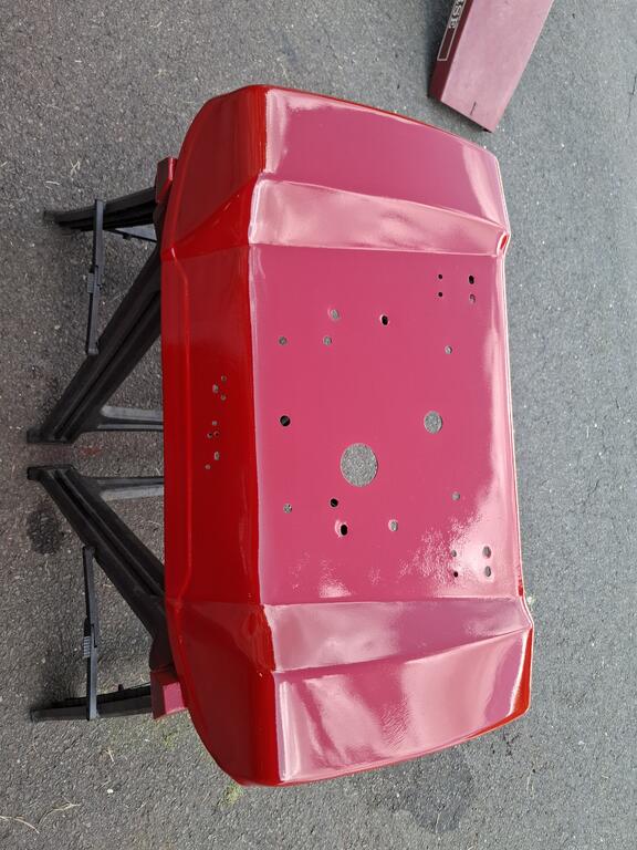

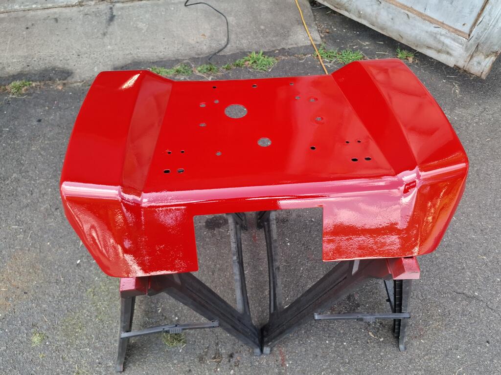

Chris689 323 #26646 Posted August 24 So I was on the fence on repainting my C120 or trying to restore the original paint. After last winter towing the tractor back and forth to help my grandparents the salt really took its toll. I decided two months ago I was just going to repaint the tractor. I started sanding the fender but life got in the way and I never finished until today. Is it perfect? nope but good enough for who its for. Fender is done and next is the hood. Haven't decided if I'm going to park it for the rest of the year or just do one piece a weekend as I did with my Simplicity turned Allis Chalmers. 3 3 Share this post Link to post Share on other sites
cleat 9,333 #26647 Posted August 24 1 hour ago, Chris689 said: So I was on the fence on repainting my C120 or trying to restore the original paint. After last winter towing the tractor back and forth to help my grandparents the salt really took its toll. I decided two months ago I was just going to repaint the tractor. I started sanding the fender but life got in the way and I never finished until today. Is it perfect? nope but good enough for who its for. Fender is done and next is the hood. Haven't decided if I'm going to park it for the rest of the year or just do one piece a weekend as I did with my Simplicity turned Allis Chalmers. Looks good to me. Red and shiny. 2 Share this post Link to post Share on other sites
ebinmaine 80,694 #26648 Posted August 24 34 minutes ago, cleat said: Looks good to me. Red and shiny. Agreed ! Share this post Link to post Share on other sites
sqrlgtr 3,927 #26649 Posted August 24 2 hours ago, Chris689 said: Is it perfect? nope but good enough for who its for I will give you this @WHX?? famous quote "good enough for the girls we go out with" 5 Share this post Link to post Share on other sites

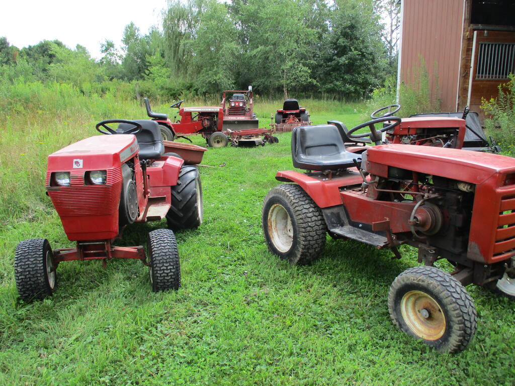

kpinnc 18,960 #26650 Posted August 25 Nothing special, but I moved a couple out to the barn until the house is done. It was nice to drive them around for a bit. You can see some of the debris pile behind the 523H. The contractor has removed over a dozen tandem dump truck loads so far. 6 3 Share this post Link to post Share on other sites
