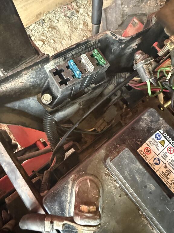

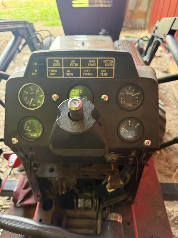

Desko 686 #26503 Posted July 28 Did some work on the 520 today which included replacing the bent/busted dash and bezel along with a new light switch from A-Z, and a new vacuum gauge, I don’t know if you can get a new one that says toro anymore but Stewart Warner still makes the style that came on the older 520s which works for me. Still need to get new bulbs for the rest of the gauges though. While I had everything out of the way I also fixed the wiring and replaced the fuse box which took care of most of the electrical issues but still need to address the 9 pin. It was also charging all over the place so I threw a new regulator on and that seems to be working good now so hopefully it’ll be a solid worker when it’s all back together 7 2 Share this post Link to post Share on other sites

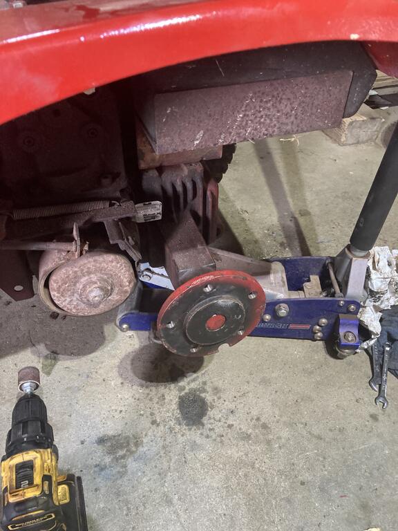

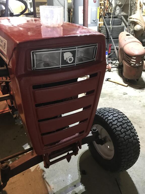

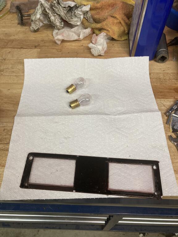

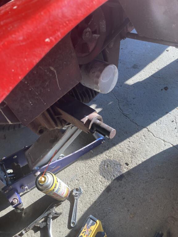

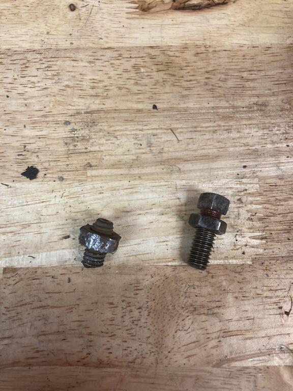

MainelyWheelhorse 3,129 #26504 Posted July 28 (edited) Today after a Zoom meeting I had in the morning. I worked on the C-141’s loose hub, and accidental red oversprayed headlight lens. After a paint thinner wipe on the clear part of the lens, and a wipe of the bulbs it was all set. the old setscrew (left) and the new (right) After a clean off with some PB Blaster and a skim of high temp wheel bearing grease I was going to put the old hub back but it still wobbled so…. 3 hours later… I robbed one off the trailer I have. I swapped the old warped hub for the identical and in better condition good hub on the trailer. Once that was on, I put the tire back on, I was done. It seemed to be much more solid feeling. Edited July 28 by MainelyWheelhorse 7 1 Share this post Link to post Share on other sites

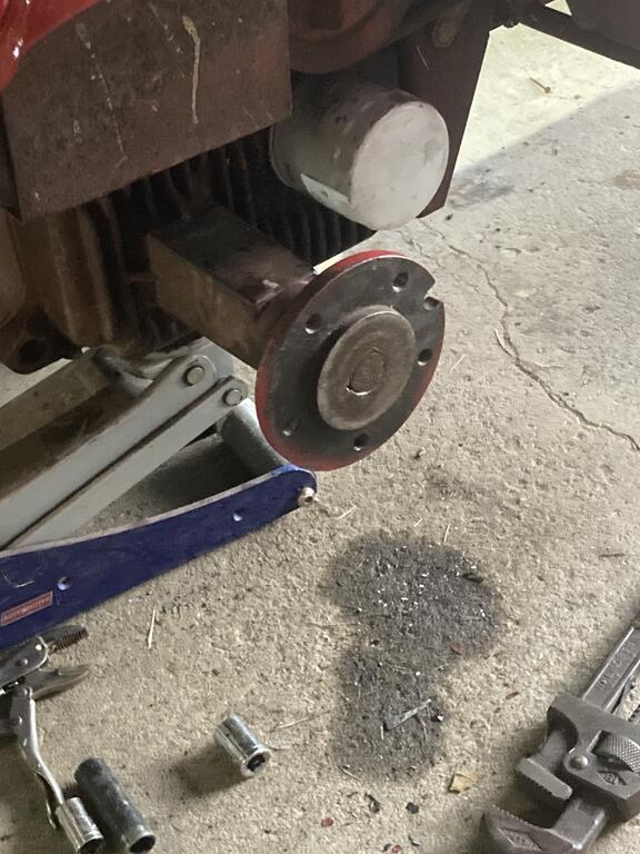

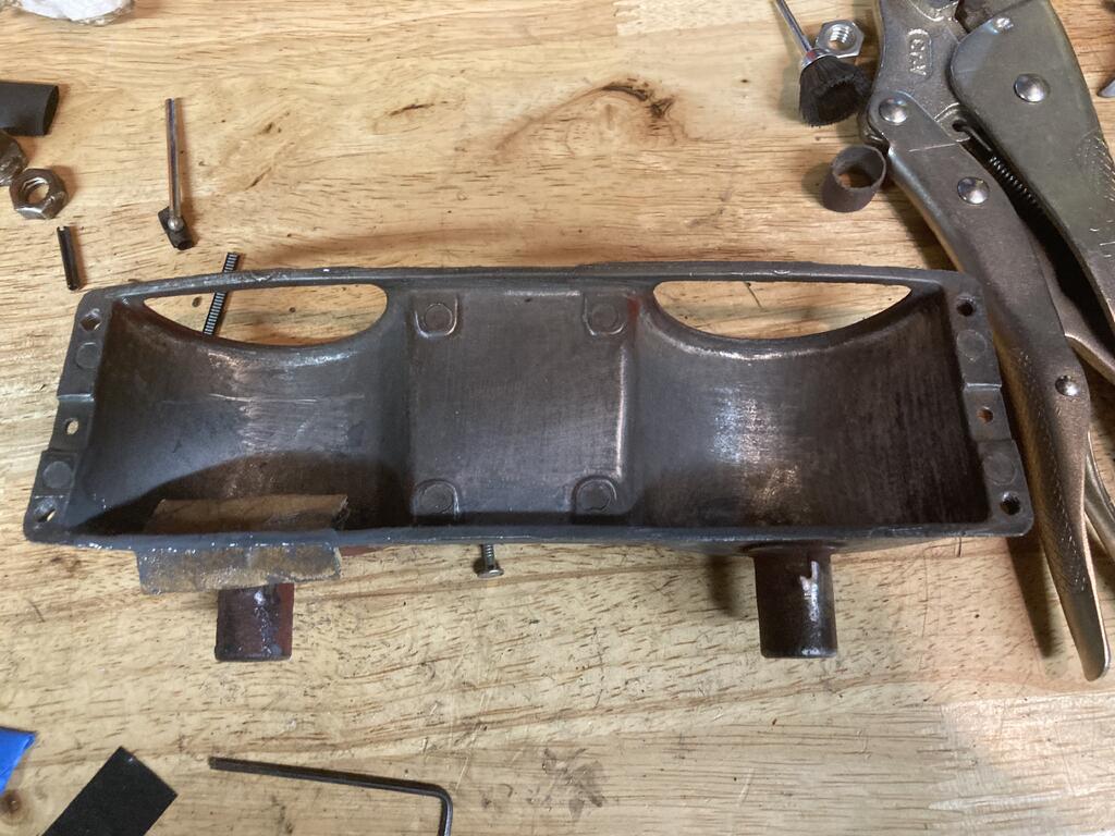

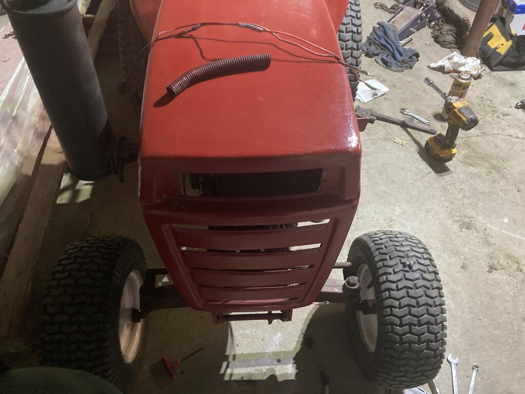

MainelyWheelhorse 3,129 #26505 Posted July 29 After an uneventful and slow day at work, I got to work on the C-141 again. I checked out the other rear hub and gave it the same treatment as yesterday minus the swapping out of parts. It turns out I swapped the hub when I built the tractor last year. A bit of a clean and that went back together like the other side. I also after being inspired by @sqrlgtr‘s post decided to drill out and spruce up the headlight bucket on my tractor. It came off great but in the course of cleaning out and polishing up, I broke out the vent on the right side. A little JB weld and a few hours and I’ll be back in business. The black on the lens should hide it so it won’t be noticeable unless you take the lens off. i plan on spraying the bucket with some bright semi reflective silver paint I have, to brighten it up. I plan on replacing the rivets with flat head bolts so if I need to do maintenance etc.., I can pull it all out with two bolts. Back at it tomorrow after work to finish it up. 3 1 Share this post Link to post Share on other sites

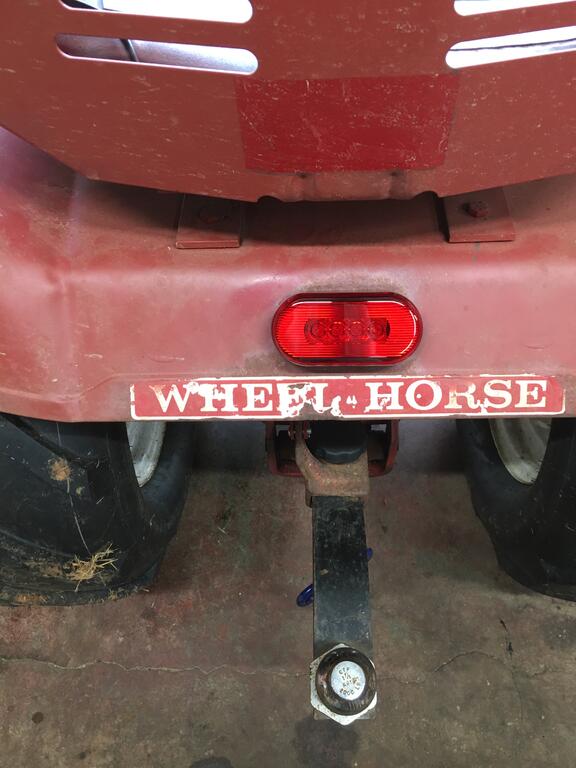

sqrlgtr 3,860 #26506 Posted July 29 Caught a few minutes and installed led tail light on C -160 to match the new LED headlights I installed yesterday. I got these from the jungle site and like them because they have a black base and the lens closely matches the old WH lens. 8 2 Share this post Link to post Share on other sites
ebinmaine 80,600 #26507 Posted July 29 51 minutes ago, sqrlgtr said: and like them because they have a black base and the lens closely matches the old WH lens Pretty slick 1 Share this post Link to post Share on other sites
Handy Don 17,461 #26508 Posted July 29 On 7/27/2026 at 9:27 PM, Desko said: I threw a new regulator on Intermittent regulator function is nearly always due to a poor ground between the regulator and the battery negative. Regulator to shroud, shroud to engine block, engine block to battery. Paint, rust, and crud are the enemy here. 5 Share this post Link to post Share on other sites

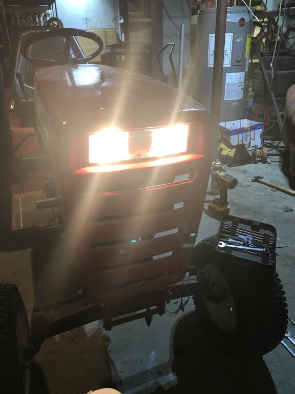

MainelyWheelhorse 3,129 #26510 Posted July 30 Tonight I finished up the C-141 headlight project. Sometimes it pays to have different hobbies as I had a bunch of 1/4 20 bolts to mount the bucket back in after a spruce up with some semi reflective silver paint. This was a test to see if everything was hooked up right. I scuffed up,where the bulbs mounted to give them a good ground. It still needed tweaking. . The final product. I put some of the fuzzy side of some stick on Velcro to act as a cushion. Now, the paint I spent a significant amount of time on shouldn't get rubbed off the lens. Don’t mind the stuff in the background 😁 This is the paint I used. It’s reflective but not overkill. The overall end result was definitely an improvement. 4 5 Share this post Link to post Share on other sites

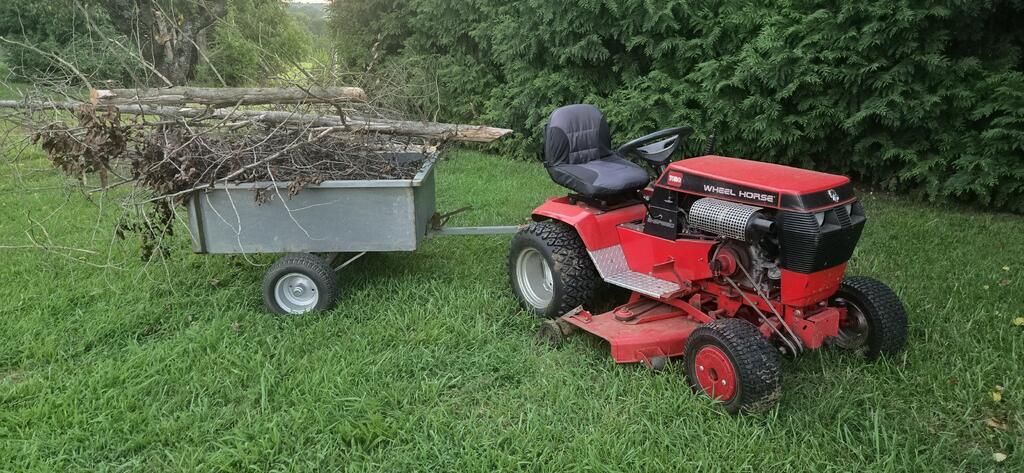

kpinnc 18,939 #26511 Posted July 31 I finally got some seat time today. Cut a dead tree down and hauled it to the burn pile. Maybe one day it will be safe again to burn it. 3 Share this post Link to post Share on other sites
cleat 9,324 #26512 Posted July 31 39 minutes ago, kpinnc said: I finally got some seat time today. Cut a dead tree down and hauled it to the burn pile. Maybe one day it will be safe again to burn it. The problem here is getting a dry enough day to burn. We just got 3.5" of rain over the last two days and the entire summer has been this way. 2 1 Share this post Link to post Share on other sites
ineedanother 2,861 #26513 Posted July 31 (edited) 2 hours ago, kpinnc said: I finally got some seat time today. Cut a dead tree down and hauled it to the burn pile. Maybe one day it will be safe again to burn it. You probably won't want the smell of it for a while, but that will pass. Time really does heal but some things take longer than others. Been there and done that. Edited July 31 by ineedanother 1 Share this post Link to post Share on other sites
kpinnc 18,939 #26514 Posted July 31 (edited) 9 hours ago, ineedanother said: You probably won't want the smell of it for a while, but that will pass. Time really does heal but some things take longer than others. Been there and done that. Agreed. I've grown quite annoyed with the "burnt" smell of my house, and since no repairs have happened yet it definitely lingers. I'm hoping the brush pile burning won't be anything like the smells in and around my house. Insulation, wiring, and the glue in plywood most definitely stinks! Either way you are correct: in time these things will pass! Edited July 31 by kpinnc 1 Share this post Link to post Share on other sites

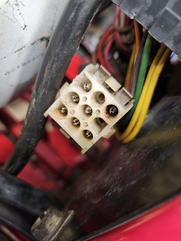

ML3 2,504 #26515 Posted August 1 Making headway on the 416H. So far everything going pretty well but of course now its time to address the dreaded 9pin...... 3 Share this post Link to post Share on other sites
sqrlgtr 3,860 #26516 Posted August 1 7 minutes ago, ML3 said: the dreaded 9pin...... That 9 pin doesn't look to healthy. 1 Share this post Link to post Share on other sites
953 nut 69,133 #26517 Posted August 1 10 hours ago, ML3 said: now its time to address the dreaded 9pin. Now it is time to GET RID OF the nine pin. If you repair the nine pin you will have the same problem on down the line. Just connect the appropriate wires with good watertight electrical connectors of your choosing and have a good life. The pins on the 12 volt connector were too small for the load and in many cases have melted down the adjacent wires when they fail. 3 Share this post Link to post Share on other sites
ML3 2,504 #26518 Posted August 1 1 hour ago, 953 nut said: Now it is time to GET RID OF the nine pin. If you repair the nine pin you will have the same problem on down the line. Just connect the appropriate wires with good watertight electrical connectors of your choosing and have a good life. The pins on the 12 volt connector were too small for the load and in many cases have melted down the adjacent wires when they fail. Thats what I'm doing. Watertight heat shrink connectors for each individual wire. 3 Share this post Link to post Share on other sites

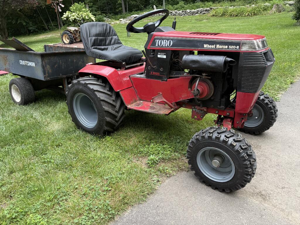

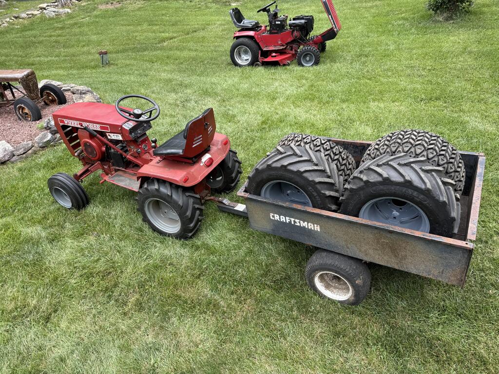

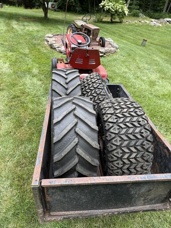

Sparky-(Admin) 26,299 #26521 Posted August 2 Tire/wheel swaps on the 520 today…B-80 used to haul it all away. 10 1 Share this post Link to post Share on other sites
Goldnboy 1,154 #26522 Posted August 3 Changed hydraulic oil filter on the C161 that seems to have been neglected on anything maintenance related... Found out it was quite past due 4 3 Share this post Link to post Share on other sites
c-series don 12,421 #26523 Posted August 3 @Sparky I would not put those 23x10.50-12 ag tires back on your 520. You have a nice lawn and I’d hate to see you mess it up. Instead of you having to worry about storing those rims and tires I’d be more than happy to come and get them. This way it will help you with storage space. I’m just trying to help you out here Mike!😂 Work with me 🤣🤣🤣🤣 1 4 Share this post Link to post Share on other sites
Sparky-(Admin) 26,299 #26524 Posted August 3 10 minutes ago, c-series don said: @Sparky I would not put those 23x10.50-12 ag tires back on your 520. You have a nice lawn and I’d hate to see you mess it up. Instead of you having to worry about storing those rims and tires I’d be more than happy to come and get them. This way it will help you with storage space. I’m just trying to help you out here Mike!😂 Work with me 🤣🤣🤣🤣 It’s good to have friends in this hobby Don! Actually the reason I had to remove the ag’s was because the wheels on the 42” deck wouldn’t clear. 2 1 Share this post Link to post Share on other sites
