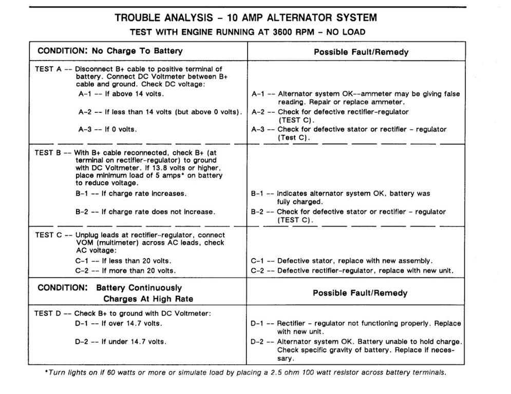

Blaine 275 #26477 Posted July 19 1 hour ago, Lee1977 said: With that much aluminm bolted to it will be insterting to see if it survives. Battery was 11.6v yesterday when i bolted it on and before i mowed for about an hour. It barely started on that 11.6 but the voltage went up after it was running, so that’s all i needed to see. Just checked it. Battery was 11.9v with the key off and went up to 12.0v with some throttle after i started it. Not my favorite number, but it appears juice is going in and not out, so as long as it starts….but 12.0v probably isn’t the greatest for battery life. I think this has the small 10A stator. Share this post Link to post Share on other sites
ebinmaine 80,600 #26478 Posted July 19 59 minutes ago, Blaine said: Battery was 11.6v yesterday when i bolted it on and before i mowed for about an hour. It barely started on that 11.6 but the voltage went up after it was running, so that’s all i needed to see. Just checked it. Battery was 11.9v with the key off and went up to 12.0v with some throttle after i started it. Not my favorite number, but it appears juice is going in and not out, so as long as it starts….but 12.0v probably isn’t the greatest for battery life. I think this has the small 10A stator. That's definitely not enough. Static reading should be 12.45 or higher. Running reading should be more in the range of 13.5 to low 14s. 2 Share this post Link to post Share on other sites
pfrederi 21,145 #26479 Posted July 19 (edited) 10 amp systems work just fine. Have you load tested the battery??? Assume you have a good ground for the regulator have you checked your stator output AC voltage. Edited July 19 by pfrederi 2 1 Share this post Link to post Share on other sites
Blaine 275 #26480 Posted July 19 5 minutes ago, pfrederi said: 10 amp systems work just fine. Have you load tested the battery??? Assume you have a good ground for the regulator have you checked your stator output AC voltage. I have not load tested it. I just bought a few weeks ago just for the raider and this is the first any charge has gone into the battery from the kohler. I did have a battery charger on it maybe 2 weeks ago to top it up because it was low from tinkering with the ignition and electrical. How is the stator AC checked and what can I expect to see? Connected at the regulator or open circuit AC? Share this post Link to post Share on other sites

Blaine 275 #26483 Posted July 20 13 hours ago, pfrederi said: I put the battery on a 1 amp charger for a few hours while i replaced the front brakes and changed the oil on my car. With the battery at 12.7v, it would only hit 13.0v when throttled up, but it would hold that with the lights on. Test C open stator voltage was 21.2vac. I tried adding an extra ground from the battery to a mounting bolt of the regulator but it made no difference. It was getting late and i didn’t do test A correctly, but with B+ disconnected at the regulator and checking B+ terminal of the regulator and ground, i was seeing -2.4v, which didn’t make sense. Thanks Paul. Share this post Link to post Share on other sites

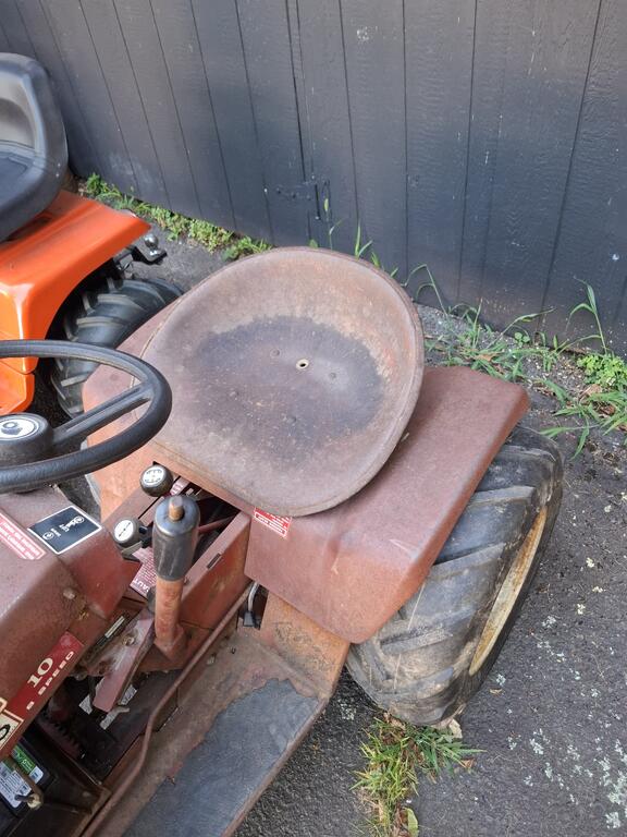

Chris689 323 #26486 Posted July 21 Well I went ahead and put a Farmall cub seat on my 10-8. Old seat was trashed and rotted so I had this. And I can put an aftermarket cover on it at some point. 8 3 Share this post Link to post Share on other sites

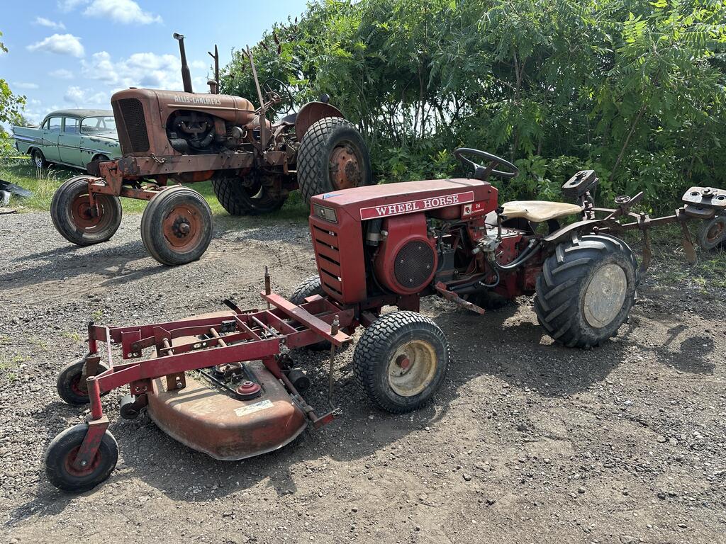

Pullstart 71,207 #26489 Posted July 22 Snapped this cool picture today! 1445 Auto, Allis Chalmers WD45, and 57 Pontiac Star Chief I call it “Generational Wealth” 14 Share this post Link to post Share on other sites

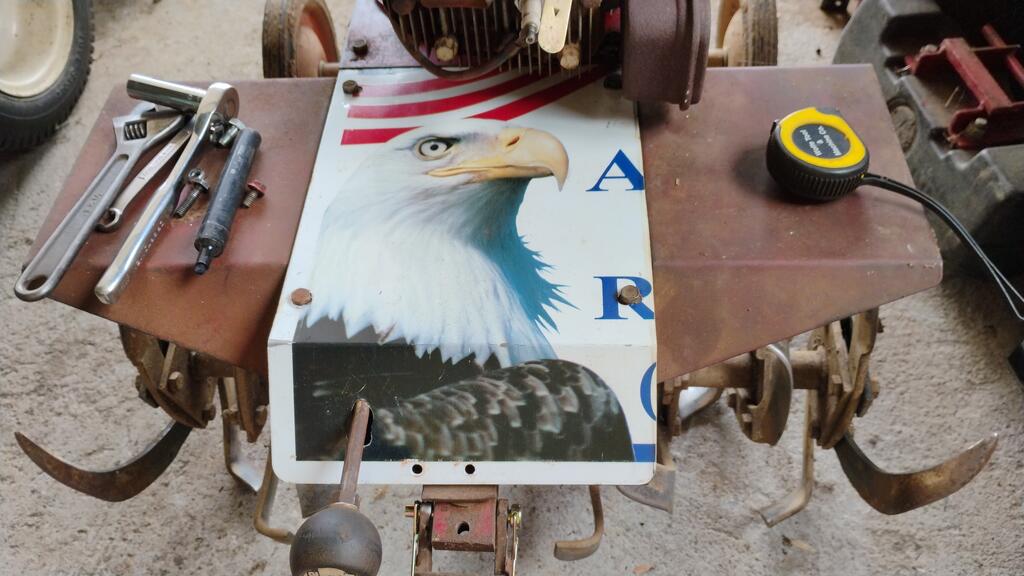

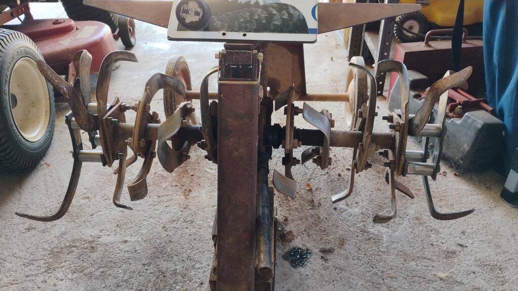

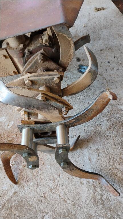

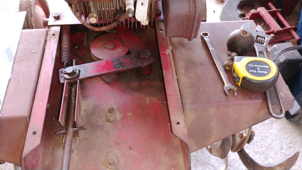

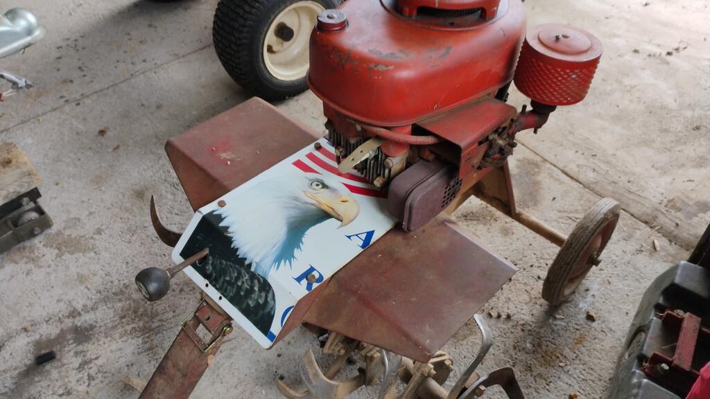

Ed Kennell 47,255 #26490 Posted July 23 Made a couple mods to the Wheel Horse tiller. The front cover plate was missing, so I scrounger a piece of steel from an old real estate sign with the intension of sanding it and using the red primer method of creating a matching patina. When I got it installed, I just couldn't sand off the eagle. The tiller was only 22 inches wide, so I added two pairs of tines to each side to make it as wide as the rear tires. 3 10 Share this post Link to post Share on other sites
sqrlgtr 3,860 #26491 Posted July 23 1 hour ago, Ed Kennell said: I just couldn't sand off the eagle. Pretty sure they are still on the endangered list so right call Ed 1 1 1 Share this post Link to post Share on other sites

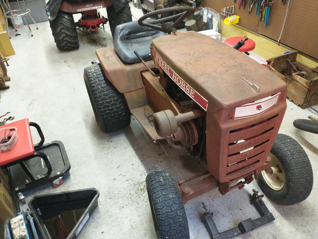

nyquil junkie 333 #26492 Posted July 23 I drug home a 520HC engine-less roller the other day, I'm contemplating on putting an engine on it and making it a cow field maintenance buggy. Its in good shape, except for the no engine thing. Because... why not. 4 Share this post Link to post Share on other sites
sqrlgtr 3,860 #26493 Posted July 24 23 hours ago, nyquil junkie said: I drug home a 520HC engine-less roller the other day, I'm contemplating on putting an engine on it and making it a cow field maintenance buggy. Its in good shape, except for the no engine thing. Because... why not. Yeah I was wanting @cafoose HC after he blew her up, (he went for a BS Vangaurd swap instead) but couldn't trade him out of it, was wanting a little more ground speed fer running around the back 40 . Share this post Link to post Share on other sites

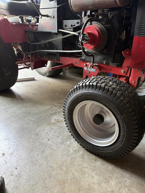

Sodaking27 1,348 #26495 Posted July 25 Little work on the 314H today. New front rims, bearings, tires and tie rods. Quick touch up of some of the body parts. 10 3 Share this post Link to post Share on other sites
ineedanother 2,861 #26496 Posted July 25 12 minutes ago, Sodaking27 said: Little work on the 314H today. New front rims, bearings, tires and tie rods. Quick touch up of some of the body parts. @Sodaking27 where did you source the rims? You like? 1 Share this post Link to post Share on other sites
Sodaking27 1,348 #26497 Posted July 25 54 minutes ago, ineedanother said: @Sodaking27 where did you source the rims? You like? @ineedanother They are wheel horse rims. I purchased one off flea bay and the other I picked up from a friend of mine. 2 Share this post Link to post Share on other sites

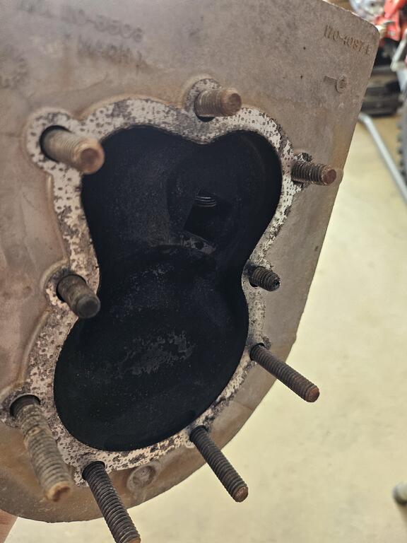

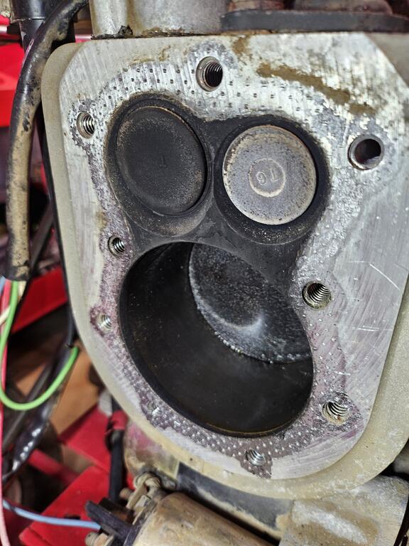

ML3 2,504 #26498 Posted July 25 Worked on 416H. Started w/decarbon & valve adjustment. Neither of which were really too bad. Since that all went well it looks like its gonna be worth putting some time & money into it. Glad to see cooling fins, especially on back cylinder were clean. 9 pin looks good also but I'll still do some preventive repairs to avoid any issues. 2 Share this post Link to post Share on other sites
ebinmaine 80,600 #26499 Posted July 25 41 minutes ago, ML3 said: do some preventive repairs to avoid any issues This IS the way. Share this post Link to post Share on other sites
