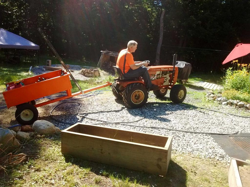

ZXT 2,402 #2626 Posted July 2, 2019 On 6/30/2019 at 2:46 PM, Lane Ranger said: Put the 1958 Wheel Horse RJ through a work out today in 88 degree heat cutivating the garden. This is a late planted, water soaked garden that may not produce much but we are going to give it a try! Planted some other lettuce, zucchini and squash. 88 degrees? Pffft.. that's nothing! Great looking tractor in its work clothes, and a great looking garden! Your friend has a great looking old house. I'm sure it's still running off of 100 year old knob and tube wiring, too. 2 Share this post Link to post Share on other sites
Pullstart 71,359 #2627 Posted July 2, 2019 3 minutes ago, ZXT said: Man, that tractor is gorgeous! Looks like it was painted yesterday. Who was the source of the paint? Looks like It's held up extremely well. if that’s original you’ve done great at keeping it up to snuff! 1 Share this post Link to post Share on other sites
76c12091520h 4,290 #2628 Posted July 2, 2019 (edited) 15 minutes ago, ZXT said: Man, that tractor is gorgeous! Looks like it was painted yesterday. Who was the source of the paint? Looks like It's held up extremely well. Dad and I rebuilt it all back in 92-93, engine was blown, years of neglect and poor storage; we put on a brand new 42" recycler deck, took it down to the bare chassis, sandblasted most of it, PPG DBC r4 base with 2042 clear; been using it ever since up until this year. This is the one I never sell; I grew up on a 61 701, dad sold that one and bought a 78 c140 in 1981 and sold the 78 in 1992 when he took a new one for himself. This is the tractor he traded in on our c140. Edited July 2, 2019 by 76c12091520h 4 2 Share this post Link to post Share on other sites

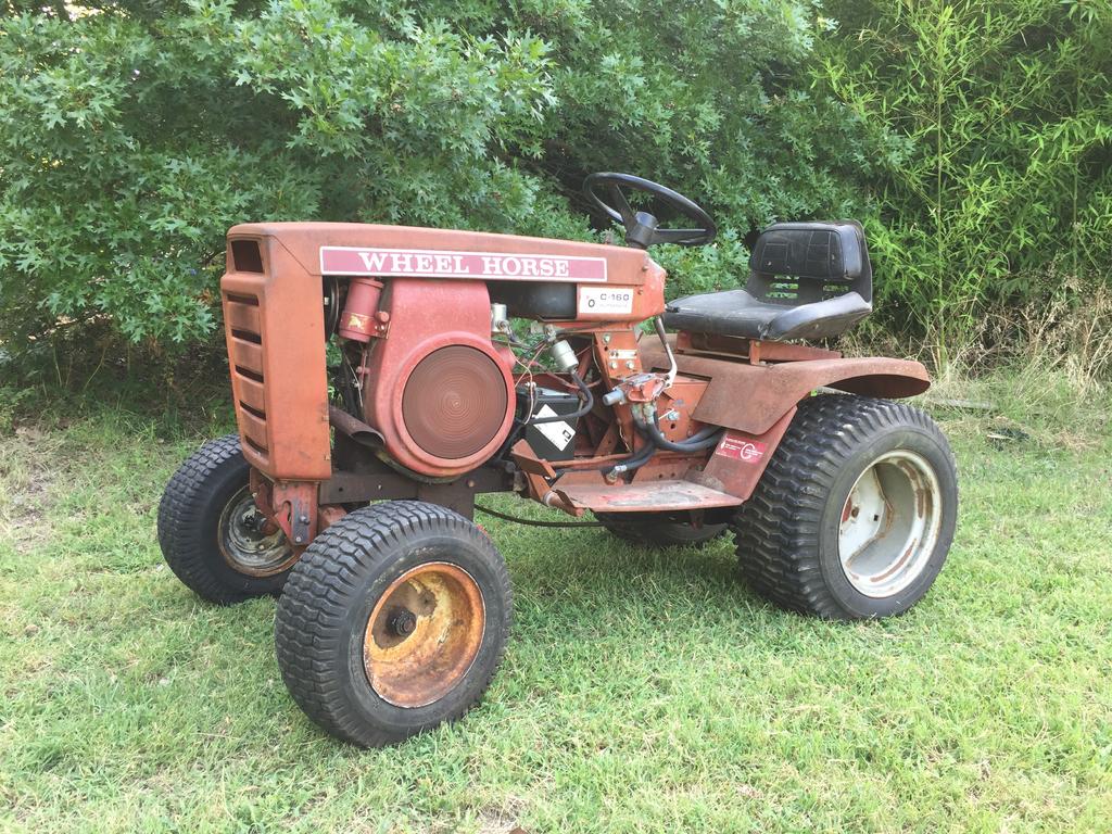

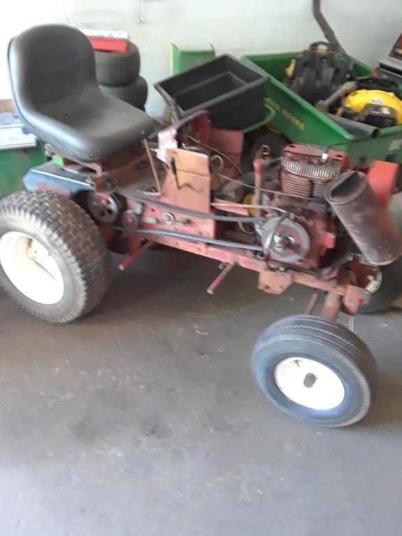

ZXT 2,402 #2630 Posted July 3, 2019 (edited) Tore some of the sheet metal off of my new-to-me C160 in order to access the drive belt. For some reason the belt is still grabbing when I have the pump disengaged and the tractor tries to take off. Had to mow first and it got dark before I could tell much. I'm guessing that maybe there's some rust buildup on the crank pulley grabbing the belt. Edited July 3, 2019 by ZXT 1 Share this post Link to post Share on other sites

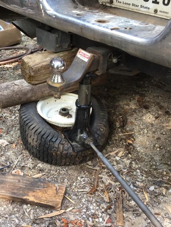

ZXT 2,402 #2634 Posted July 5, 2019 (edited) Unloaded the C160 out of the truck today. Stole the wheels off of an old Murray that I used to mow with, since it had 8" fronts. Dismounted them (Like my method? Lol! The high-lift jack I usually use wasn't at my place) and mounted them with tubes on the C160 front wheels. It had one good WH rear wheel with a good ag tire on it, and one really wide wheel with a weird offset and a bad tire. Put those on my Sears GT 19.9 and stole its rear wheels for the time being. Next, I changed the rear end oil, which was incredibly clean, but it only had around 1.5 QT. in it. Wouldn't start due to the points being completely ate up, so I replaced those. After that, I reinstalled the foot rest, belt guard, and seat pan, and put the seat off of my GT 14 on it. I haven't changed the engine oil yet, but it looks brand new even after running. It had a Napa oil filter on it, good oil in the trans, and every greaseable place pushed grease out after 1/2 pump from the grease gun, so I think this thing was relatively well maintained before it was parked. Doesn't appear to have ever had anything but a tiller on it. I think I might be beginning to like this thing! Now all I need to do is find a set of rear wheels, another mower deck, and fix the loose steering gear and I'll be set! Edited July 5, 2019 by ZXT 3 3 Share this post Link to post Share on other sites
Lee1977 7,805 #2635 Posted July 5, 2019 2 hours ago, ZXT said: Unloaded the C160 out of the truck today. Stole the wheels off of an old Murray that I used to mow with, since it had 8" fronts. Dismounted them (Like my method? Lol! The high-lift jack I usually use wasn't at my place) and mounted them with tubes on the C160 front wheels. It had one good WH rear wheel with a good ag tire on it, and one really wide wheel with a weird offset and a bad tire. Put those on my Sears GT 19.9 and stole its rear wheels for the time being. Next, I changed the rear end oil, which was incredibly clean, but it only had around 1.5 QT. in it. Wouldn't start due to the points being completely ate up, so I replaced those. After that, I reinstalled the foot rest, belt guard, and seat pan, and put the seat off of my GT 14 on it. I haven't changed the engine oil yet, but it looks brand new even after running. It had a Napa oil filter on it, good oil in the trans, and every greaseable place pushed grease out after 1/2 pump from the grease gun, so I think this thing was relatively well maintained before it was parked. Doesn't appear to have ever had anything but a tiller on it. I think I might be beginning to like this thing! Now all I need to do is find a set of rear wheels, another mower deck, and fix the loose steering gear and I'll be set! I used that method on one that I could break loose, ending up cutting it off. 1 1 Share this post Link to post Share on other sites
ZXT 2,402 #2636 Posted July 5, 2019 10 minutes ago, Lee1977 said: I used that method on one that I could break loose, ending up cutting it off. Cool! I tried using my red '80 Toyota pickup first but it wasn't heavy enough! 2 Share this post Link to post Share on other sites
adsm08 5,194 #2637 Posted July 5, 2019 6 hours ago, ZXT said: Cool! I tried using my red '80 Toyota pickup first but it wasn't heavy enough! I have a special arbor plate I made up for my 20T press for when that happens. It's nothing fancy, just a crescent cut out of weld plate with a curve about the same as a tractor wheel. 2 Share this post Link to post Share on other sites
Lee1977 7,805 #2638 Posted July 5, 2019 7 hours ago, ZXT said: Cool! I tried using my red '80 Toyota pickup first but it wasn't heavy enough! It was heavy enough I had both back tires off the garage floor. It worked on the other three tires and the back side of that one. The front side was glued on with some thing. After removing the tire I had to cut the bead on the front side with the side grinder to get that ring off. Then I had to sand off what they used to glue it on. Sometimes you just have to get it done what ever it takes. I have had to cut a 24 x 11.5 tire off a farm tractor the same way. 1 Share this post Link to post Share on other sites

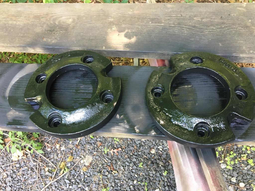

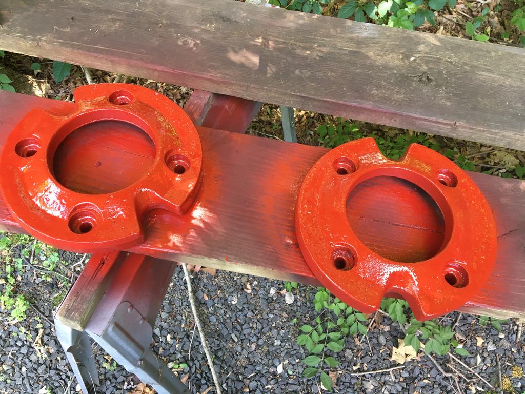

Sparky-(Admin) 26,492 #2639 Posted July 5, 2019 Painted up these cast weights I bought last week. 25#’s each and fit nicely on the INSIDE of a Wheel Horse rim. 2 2 Share this post Link to post Share on other sites

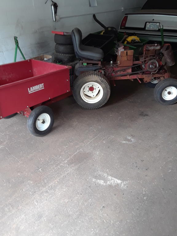

Goldann520 242 #2641 Posted July 6, 2019 (edited) Got the steering wheel nut off the bomb today after a week or so. The wheel crumbled apart while I was turning around in the shop a while back And I almost ran into the wall.😑And picked up a trailer for it. Swap out those decals with wh and voila Edited July 6, 2019 by Goldann520 1 Share this post Link to post Share on other sites
TonyToro 1,190 #2642 Posted July 7, 2019 On 7/5/2019 at 1:49 PM, Sparky said: Painted up these cast weights I bought last week. 25#’s each and fit nicely on the INSIDE of a Wheel Horse rim. They look really nice! So these can mount against the hub? 1 Share this post Link to post Share on other sites

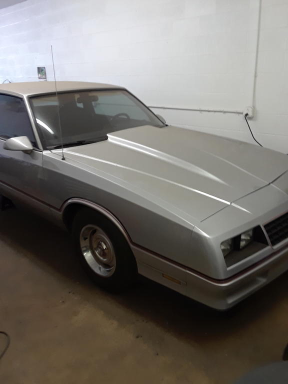

TonyToro 1,190 #2643 Posted July 7, 2019 17 hours ago, Goldann520 said: Got the steering wheel nut off the bomb today after a week or so. The wheel crumbled apart while I was turning around in the shop a while back And I almost ran into the wall.😑And picked up a trailer for it. Swap out those decals with wh and voila Do I see a Monte Carlo back there?? 1 Share this post Link to post Share on other sites

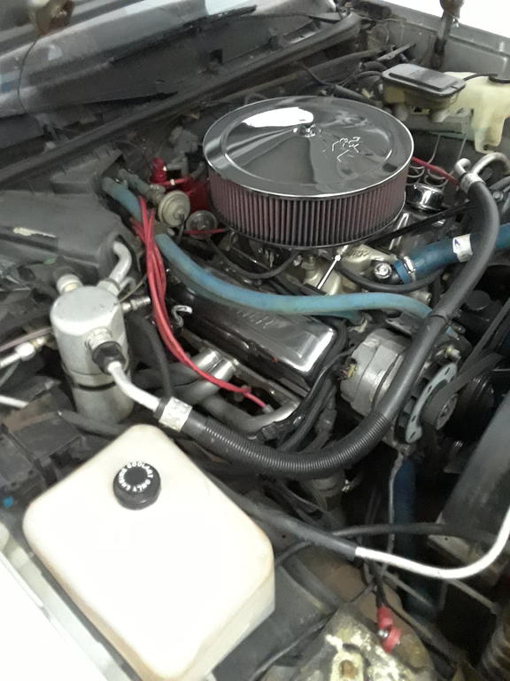

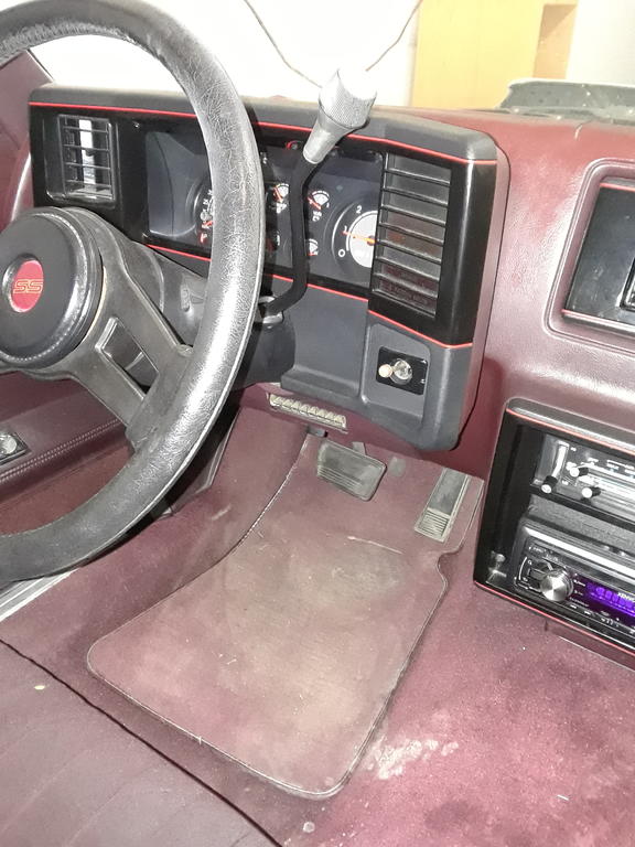

Goldann520 242 #2644 Posted July 7, 2019 (edited) 4 hours ago, TonyToro said: Do I see a Monte Carlo back there?? 86 ss. 105k super rare bench seat column shift. Original 305 and drive train hopped up a bit. Still not a world beater obviously, but won't embarrass you either. Pics do no justice, especially in the interior, it's really nice. Edited July 7, 2019 by Goldann520 3 Share this post Link to post Share on other sites

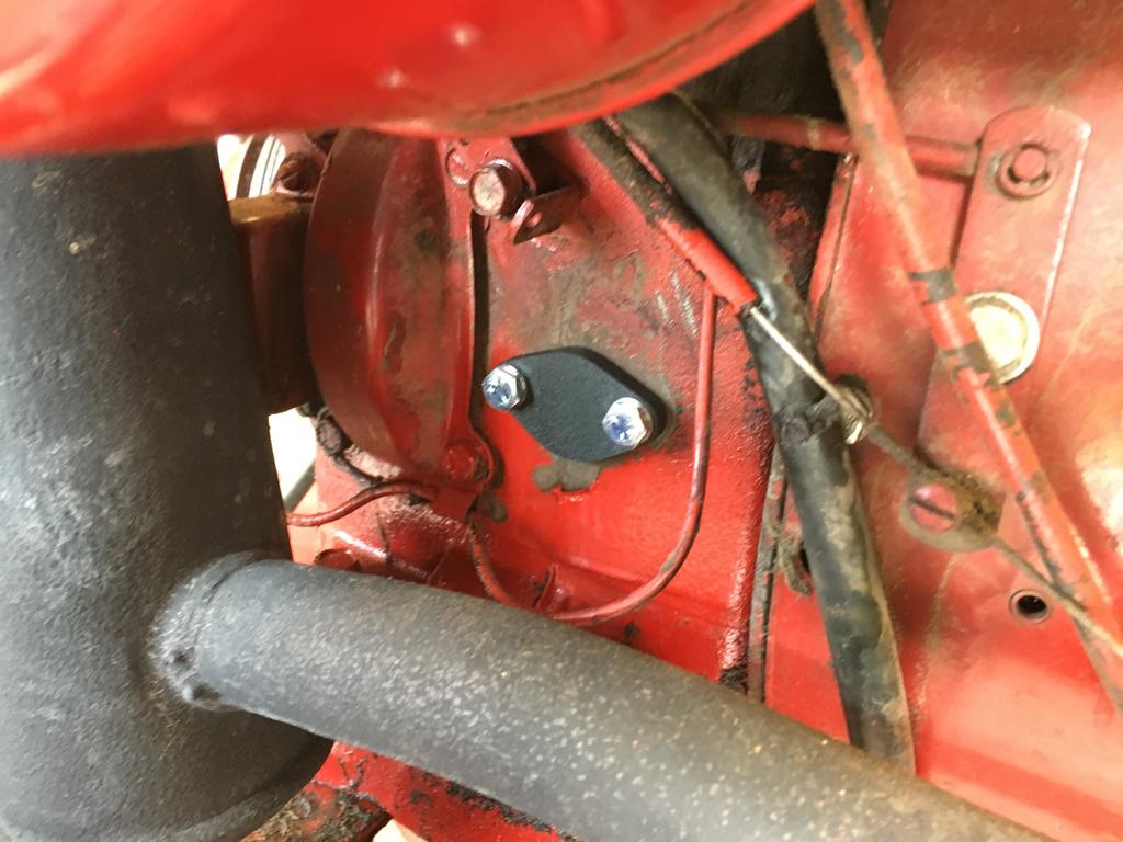

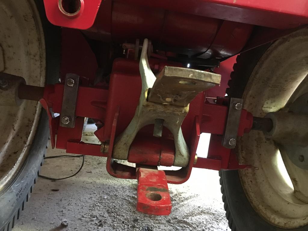

squonk 48,212 #2646 Posted July 7, 2019 Got the plow hitch and trailer hitch on "Big Oly" Finally put the fuel pump block off plate I got from Kirk Engines on the C-160 before mowing. cleaned the deck and noticed all the black hair hanging under the C so a power wash was next. 7 Share this post Link to post Share on other sites
