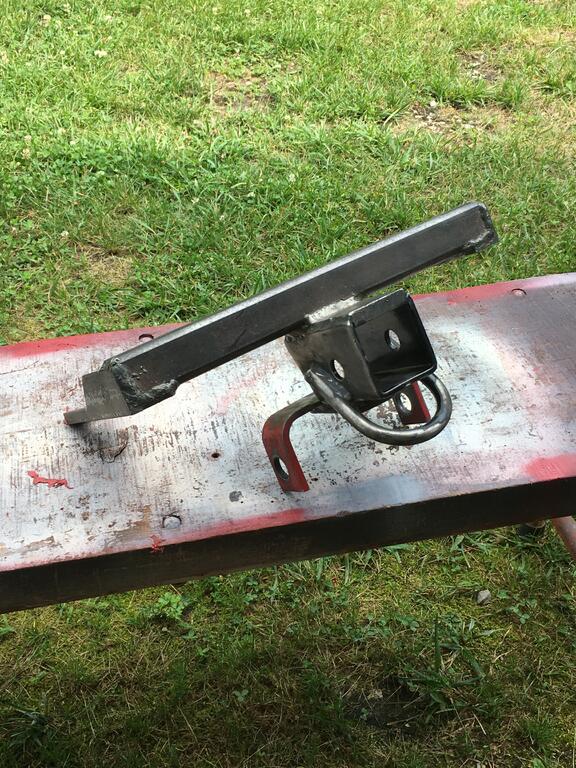

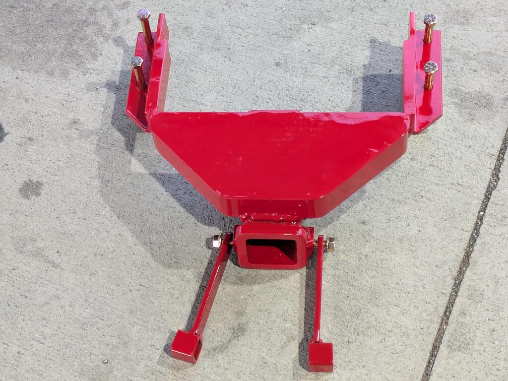

sqrlgtr 4,192 #26281 Posted June 25 Made a trailer hitch for my 520H. I did get it painted but will have to wait on paint to dry b4 getting it mounted to tractor . I made this out of stuff I had laying around but if I would have had to buy all my metal new I would just order one from wheelhorsepartsandmore, I don’t believe you could build one much cheaper if you had to purchase the metal. 10 Share this post Link to post Share on other sites

sqrlgtr 4,192 #26289 Posted June 26 13 minutes ago, ebinmaine said: Nice I had seen those hitches before but didn't realize he made some to sell. I noticed the angle iron is turned different than mine and don't know if it would have worked with the hydro filter, but it might not make any difference but that is the reason I turned mine the way I did. Like I mentioned above it would be hard to build one yourself if you had to buy all the materials and come out much cheaper than buying one already made and probably be going in the hole if you figured your time in it. Share this post Link to post Share on other sites
ebinmaine 81,183 #26290 Posted June 26 3 minutes ago, sqrlgtr said: Like I mentioned above it would be hard to build one yourself if you had to buy all the materials and come out much cheaper than buying one already made and probably be going in the hole if you figured your time in it. That's why I bought... instead of building. I do still need to modify one sometime though. Cinnamon Horse has a very high front end so the hitch points down. 1 Share this post Link to post Share on other sites

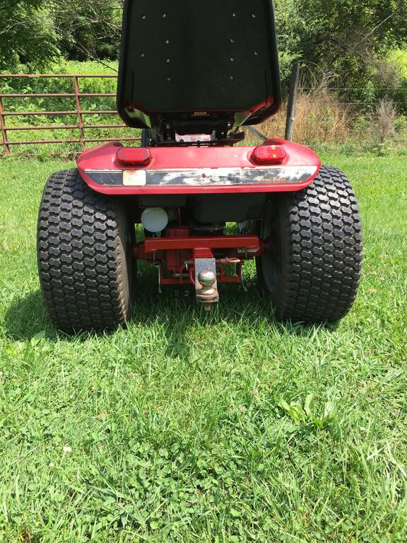

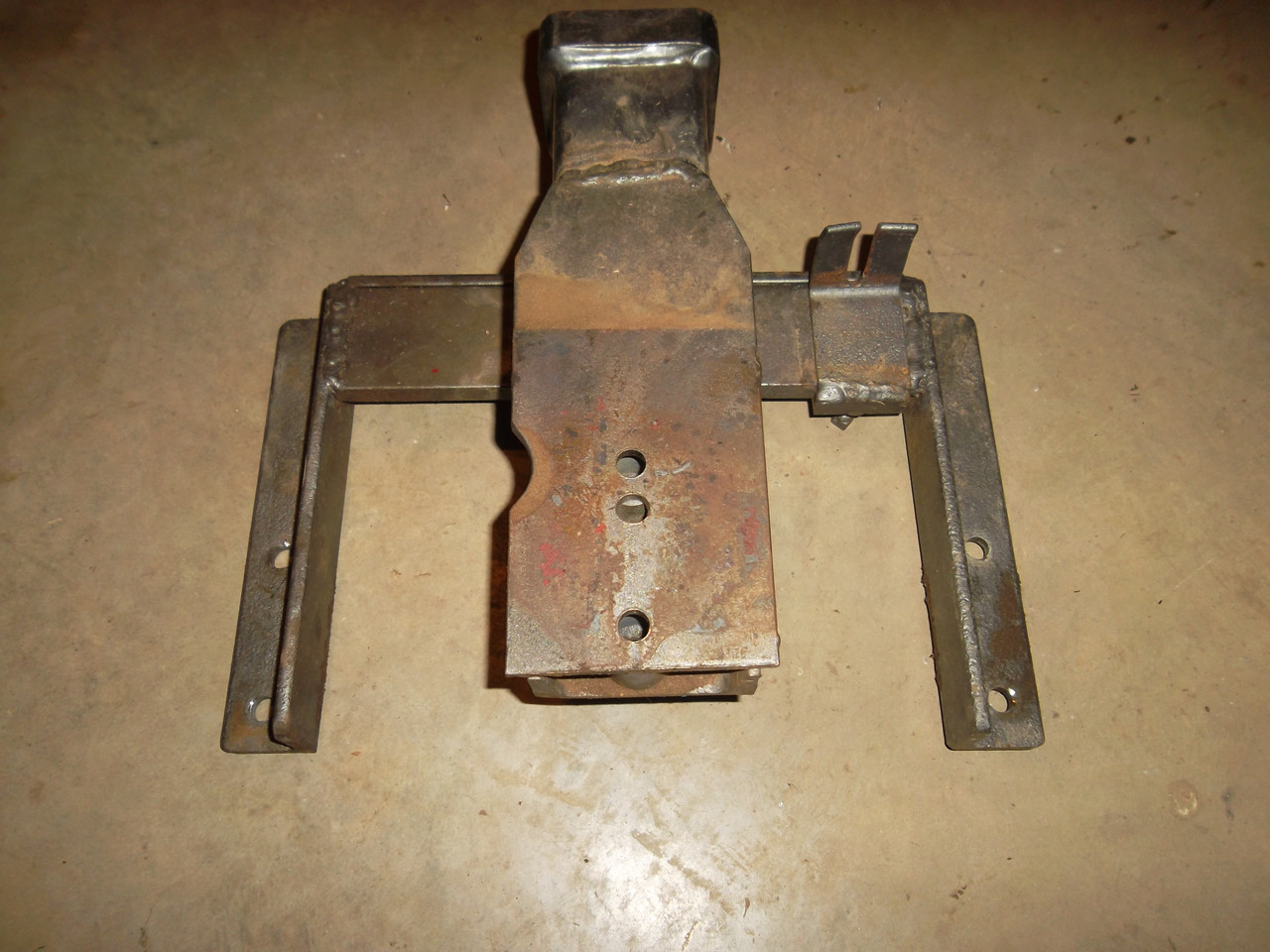

rjg854 13,427 #26291 Posted June 26 (edited) @sqrlgtr Probably got the pictures already but I wasn't going through all those pages to find out so here's what I just took Edited June 26 by rjg854 Add 1 3 Share this post Link to post Share on other sites
76c12091520h 4,292 #26292 Posted June 26 1 hour ago, sqrlgtr said: K & B section of the vendors classifieds, about the 10th item down on the first page 3 Share this post Link to post Share on other sites

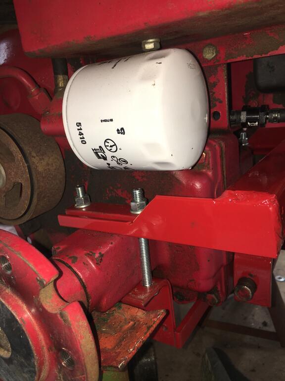

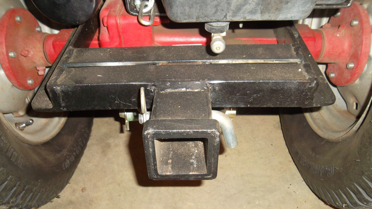

sqrlgtr 4,192 #26294 Posted June 26 (edited) 20 hours ago, 76c12091520h said: K & B section of the vendors classifieds, about the 10th item down on the first page Finished and mounted receiver hitch today. Worked out great. Will flip hitch over and it will be just about perfect height for my trailers. . I had mentioned having angle iron turned differently then the one @76c12091520h Brian Badman sells but pretty sure either way will work with the hydro filter on the Eaton 1100 rear. Edited June 26 by sqrlgtr 3 3 Share this post Link to post Share on other sites
8ntruck 9,409 #26295 Posted June 27 if you flip that hitch over, the hitch ball will probably ABOVE the axle centerline. Pulling something attached to a tractor above the drive axle centerline encourages the tractor to flip over backwards. Be very very careful if you use it this way. Leave the toung jack an inch or two above the ground - that will act as a wheelie bar to help prevent a back flip. The hitch I built for my 14-8 places the hitch ball above the axle. The front end gets really light, really quick. This is encouraging me to make a hitch to mount to the front of the tractor. 2 Share this post Link to post Share on other sites
ebinmaine 81,183 #26296 Posted June 27 1 minute ago, 8ntruck said: if you flip that hitch over, the hitch ball will probably ABOVE the axle centerline. Pulling something attached to a tractor above the drive axle centerline encourages the tractor to flip over backwards. Be very very careful if you use it this way. Leave the toung jack an inch or two above the ground - that will act as a wheelie bar to help prevent a back flip. The hitch I built for my 14-8 places the hitch ball above the axle. The front end gets really light, really quick. This is encouraging me to make a hitch to mount to the front of the tractor. I've used at least four different garden tractor hitches. All four have the ball mount on the high side. To counteract the light front end I have the big chipper on the Cinnamon Horse. I've also used a 100 lb plus home made weight. 1 Share this post Link to post Share on other sites
8ntruck 9,409 #26297 Posted June 27 1 minute ago, ebinmaine said: I've used at least four different garden tractor hitches. All four have the ball mount on the high side. To counteract the light front end I have the big chipper on the Cinnamon Horse. I've also used a 100 lb plus home made weight. Yup. That will work - up to a point. But usually that point is farther into the crazy zone of tractor operation than we dare to go...... 1 1 Share this post Link to post Share on other sites
ebinmaine 81,183 #26298 Posted June 27 8 minutes ago, 8ntruck said: Yup. That will work - up to a point. But usually that point is farther into the crazy zone of tractor operation than we dare to go...... Not me. I ain't set quite right. I've pulled loads of firewood up outta the forest that were well over 1000 lbs. Many times. 1 Share this post Link to post Share on other sites
sqrlgtr 4,192 #26299 Posted June 27 me thinks the ball/tongue will still be even to top of axle and I tried making the hitch as tight as possible to tractor. Actually going to drill a new hole for the hitch pin and slid ball in another inch or so that will help also, I hope. .. This is going to be my firewood hauler at least thats the plan anyhow. Ive pulled some pretty heavy loads with a hitch that I made that goes on the sleeve type hitch and this one isn't much taller if any at all, just hated putting all that tongue weight on my lift cables . 1 Share this post Link to post Share on other sites
