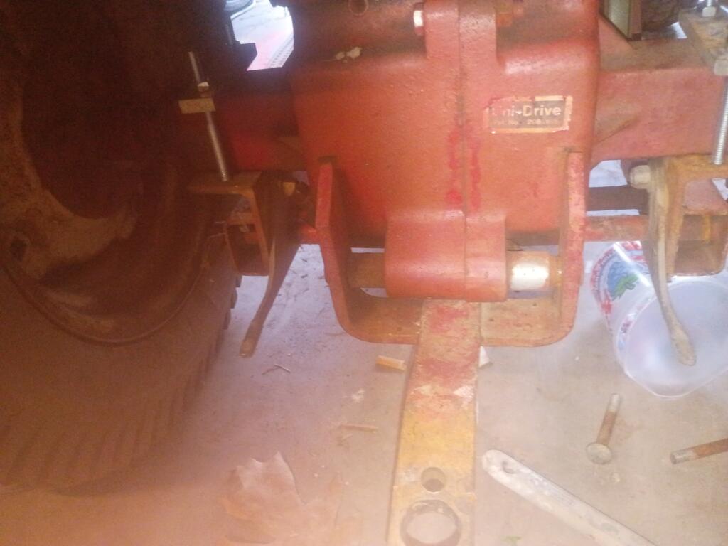

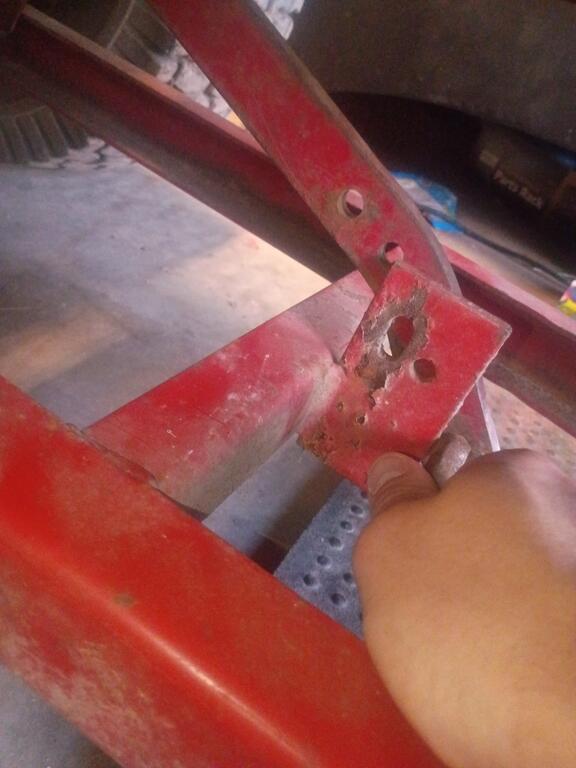

C100guy94 126 #26201 Posted June 4 Solid link no chain. But I feel like between the lift bar and plow there should be a few links of chain bc they don't line up exactly. But I can't cor the life of me remember how my 410-8 was. Share this post Link to post Share on other sites
ebinmaine 80,600 #26202 Posted June 4 Just now, C100guy94 said: Solid link no chain. But I feel like between the lift bar and plow there should be a few links of chain bc they don't line up exactly. But I can't cor the life of me remember how my 410-8 was. Solid link is angled some. It's around 11 inches total with the pins approximately 10.5" apart. I believe we attached the link to the outermost rock shaft hole. Share this post Link to post Share on other sites
C100guy94 126 #26203 Posted June 4 What links the rock shaft to plow? Share this post Link to post Share on other sites
ebinmaine 80,600 #26204 Posted June 4 2 minutes ago, C100guy94 said: What links the rock shaft to plow? The 11" link is a solid metal bar. One end to rock shaft. Other end to the cross bar of the plow frame. That should have an eye hole for the lower pin. 1 Share this post Link to post Share on other sites

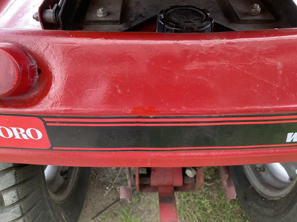

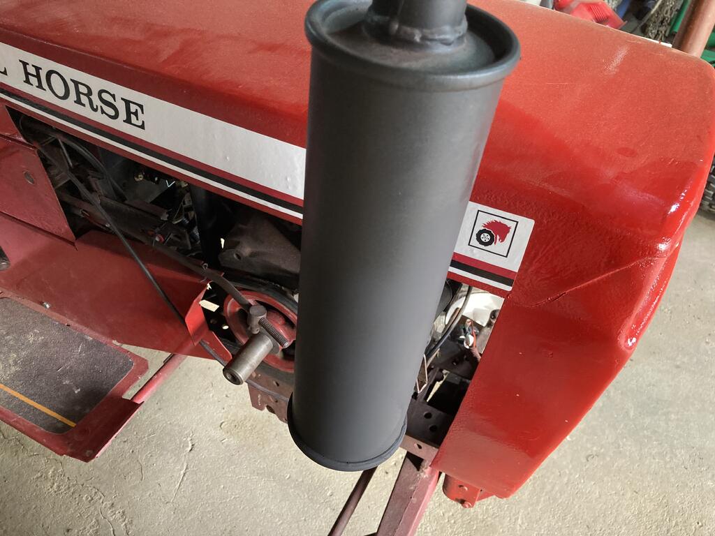

MainelyWheelhorse 3,129 #26206 Posted June 4 Today as it was 80 degrees outside it was wash day. The other two were just dusty, The 312 was the dirtiest and got the full treatment. A pressure wash, Armor All and tire cleaner and it looked almost new.😁 I even fixed a big chip I got in on the 312 a few weeks ago when I backed it into the winch on my ATV. A small brush and a small can of paint and it disappeared. If you ever change out stickers or have extra save them. When I chipped the paint it also messed up the sticker. I had an old one that was the same color and design so a small piece of that and its much less noticeable. I also gave the muffler on the C-141 a touch up as the high heat paint was coming off where the exhaust turned and went up the pipe. It’s been a productive day. 2 3 Share this post Link to post Share on other sites

C100guy94 126 #26209 Posted June 5 1 minute ago, ebinmaine said: The 11" link is a solid metal bar. One end to rock shaft. Other end to the cross bar of the plow frame. That should have an eye hole for the lower pin. Correct except it's not lining up. Idk if somethings bent Share this post Link to post Share on other sites
ebinmaine 80,600 #26210 Posted June 5 9 minutes ago, C100guy94 said: Correct except it's not lining up. Idk if somethings bent They don't go straight up & down. Which rear bracket are you using? Share this post Link to post Share on other sites
C100guy94 126 #26211 Posted June 5 3 minutes ago, ebinmaine said: They don't go straight up & down. Which rear bracket are you using? Share this post Link to post Share on other sites
ebinmaine 80,600 #26212 Posted June 5 8 minutes ago, C100guy94 said: You're rear bracket is correct. That other bar is for a mower. Not a plow. You can use it with different links. Never done it that way here. Share this post Link to post Share on other sites
C100guy94 126 #26213 Posted June 5 (edited) 4 minutes ago, ebinmaine said: You're rear bracket is correct. That other bar is for a mower. Not a plow. You can use it with different links. Never done it that way here. I'll be honest I knew something was not right. But I'll also add not to say your lieing but I can relate because this tractor to best of my knowledge has never had anything but a mower on it and maybe a ball on the sleeve hitch that was it which I did get with the tractor and the mule drive it needs new belts button pretty good condition Now would I use this link if I'm not mistaken directly to the plow Edited June 5 by C100guy94 Share this post Link to post Share on other sites

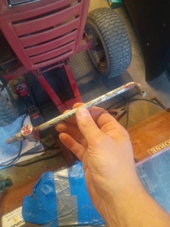

ebinmaine 80,600 #26214 Posted June 5 11 minutes ago, C100guy94 said: this link The bar for connecting that should be a flat piece. ..something like 5 or 6 inches long. The ones we use are maybe 1.25 wide by the 11" Not sure if or how that round rod would/ could be connected. Share this post Link to post Share on other sites
C100guy94 126 #26215 Posted June 5 15 minutes ago, ebinmaine said: The bar for connecting that should be a flat piece. ..something like 5 or 6 inches long. The ones we use are maybe 1.25 wide by the 11" Not sure if or how that round rod would/ could be connected. From a rock shaft bar to the long link for mower deck Share this post Link to post Share on other sites
C100guy94 126 #26216 Posted June 5 Thinking being id still like to use the mower deck wondering if a small winch would be a solution Share this post Link to post Share on other sites

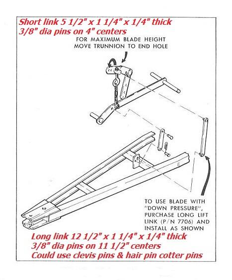

MainelyWheelhorse 3,129 #26217 Posted June 5 @C100guy94 something like this mounts to the deck lift, this lifts the plow. The shorter one is to make it float over rocks etc… the longer one is to make it push like a bull dozer. 1 Share this post Link to post Share on other sites
C100guy94 126 #26218 Posted June 5 (edited) 2 minutes ago, MainelyWheelhorse said: @C100guy94 something like this mounts to the deck lift, this lifts the plow. The shorter one is to make it float over rocks etc… the longer one is to make it push like a bull dozer. Yes sir. I remember now ok. So look like I need a piece of steel and cut two wholes with 2 pins. Any idea cost on a bar like this ? Edited June 5 by C100guy94 Share this post Link to post Share on other sites
c-series don 12,421 #26219 Posted June 5 @C100guy94If you want down pressure you need the solid lift link that Eric was talking about. If you don’t then you need a trunnion with a threaded eye bolt to a chain to the mower deck lift bar. Then from the lift bar to the plow frame with a piece of flat bar with holes for bolts or a few links of chain. This way you can still use the mower deck lift when you need it. I can post pictures of these items tomorrow. You don’t need a winch, the original setups are very simple and work well. Share this post Link to post Share on other sites
C100guy94 126 #26220 Posted June 5 5 minutes ago, c-series don said: @C100guy94If you want down pressure you need the solid lift link that Eric was talking about. If you don’t then you need a trunnion with a threaded eye bolt to a chain to the mower deck lift bar. Then from the lift bar to the plow frame with a piece of flat bar with holes for bolts or a few links of chain. This way you can still use the mower deck lift when you need it. I can post pictures of these items tomorrow. You don’t need a winch, the original setups are very simple and work well. Yea my thinking isent right bc best part and whole reason I wanted another one of these is because the downforce but yet so simple to swap things. Yea if you could send me some visuals so I can remember and see. I'm sure I can moch something up. Share this post Link to post Share on other sites
MainelyWheelhorse 3,129 #26221 Posted June 5 @C100guy94 The reference pictures came from Wheel Horse Parts and More’s website. They sell both on there. The short one is $24.00, the long one’s $28.00. You could with a saw, material, a tape measure and drill make it pretty cheaply. Home Depot or any Hardware store should have the material. Share this post Link to post Share on other sites

squonk 48,064 #26224 Posted June 5 Or bolt a short chain ( about 3 links) to the curved mower bar and and the other end to the plow lift hole. 1 Share this post Link to post Share on other sites
ohiofarmer 3,475 #26225 Posted June 5 13 hours ago, ebinmaine said: The bar for connecting that should be a flat piece. ..something like 5 or 6 inches long. The ones we use are maybe 1.25 wide by the 11" Not sure if or how that round rod would/ could be connected. That round bar connects to the bar that lifts to the lawn mower deck in my case. Share this post Link to post Share on other sites
