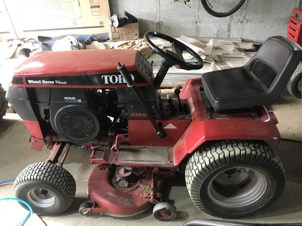

sqrlgtr 3,931 #26106 Posted May 24 (edited) Tried on a set of Carlisle 23x9.50’s on the 312-8, had 8.50 Dicos on it to start with. Kinda digging the looks so may keep them on but will diffidently have to paint the wheel's silver to match. I cant even remember what these came off of. Also took the blades off of the 42” RD deck but didnt get around to sharpening them. They looked like they were turned up on the ends but checked pretty flat on welding table. Forgot to take pics of blades........... Edited May 24 by sqrlgtr 2 Share this post Link to post Share on other sites

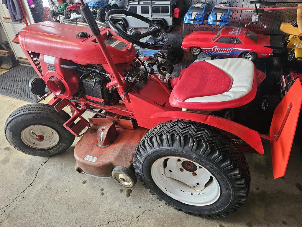

ML3 2,510 #26112 Posted May 24 Last one to get running after winter storage. 753 wouldn't start. Ignition issues. New coil, condenser, spark plug & wire. Changed oil also after repeated engine cranking & flooding. Runs good now. 3 5 Share this post Link to post Share on other sites

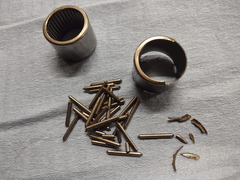

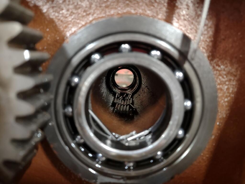

Achto 32,693 #26116 Posted May 25 (edited) My recently acquired B100 was leaking fluid from the right axle seal. Took the tranny apart today in order to investigate why. Think I may have found the issue. Managed to get the tranny washed out & cleaned up. All ready to put it back together as soon as my parts arrive. Edited May 25 by Achto 10 3 Share this post Link to post Share on other sites
ineedanother 2,864 #26117 Posted May 25 23 minutes ago, Achto said: My recently acquired B100 was leaking fluid from the right axle seal. Took the tranny apart today in order to investigate why. Think I may have found the issue. Managed to get the tranny washed out & cleaned up. All ready to put it back together as soon as my parts arrive. Looks like years of ignoring an obvious problem. I'm surprised the axle is usable. 2 Share this post Link to post Share on other sites
kpinnc 18,963 #26118 Posted May 25 28 minutes ago, Achto said: Took the tranny apart today in order to investigate why. Think I may have found the issue Yes sir, that'll do it. Glad you found it early! 1 1 Share this post Link to post Share on other sites
Achto 32,693 #26119 Posted May 25 3 minutes ago, ineedanother said: I'm surprised the axle is usable. Axle looks in good shape yet 3 1 Share this post Link to post Share on other sites

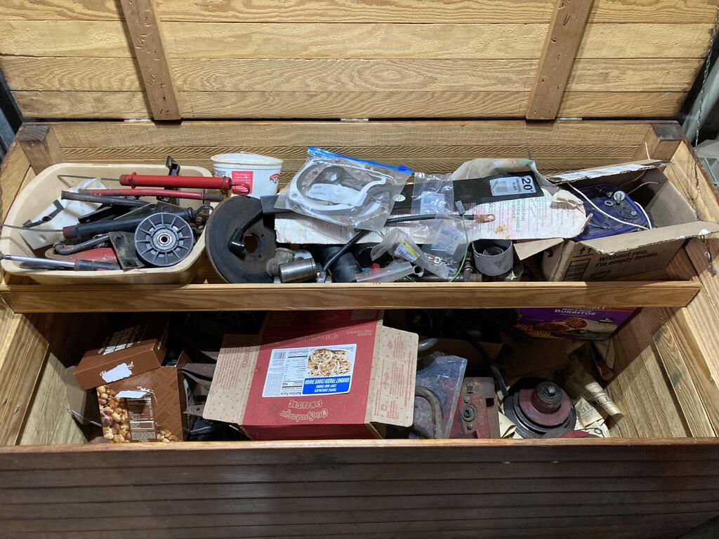

MainelyWheelhorse 3,133 #26120 Posted May 25 Yesterday, after work I tried out the 42" RD on the 308 needless to say it wasn't a fan so I swapped the 42" to the 312 and the 37"SD mostly to the 308. the 37" is physically on the 308 except for the belt which is loose no matter what you do. after swapping one of the decks in 15-20 min I mowed the rest of my test area yesterday with the 312. I left the 308 deck issues for today. I think I need a belt as it was routed right and the deck didn't seem bent anywhere. I'd say its about time for a belt as its been at least four years since i got one. Today's other project was parts storage. I got a wood box from my parents. Four cardboard boxes of parts later, it still has room. I freed up a lot of space doing that. It's been a rather productive day. 1 2 Share this post Link to post Share on other sites

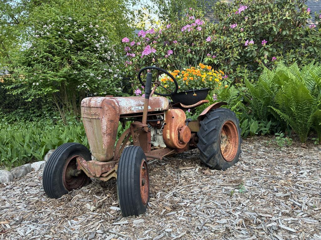

SylvanLakeWH 32,505 #26121 Posted May 25 Mrs Sylvan once again adorned the yard art with spring flowers... looks a lot better than when I'm sitting on it... 6 5 1 Share this post Link to post Share on other sites
CasaytheMann 265 #26122 Posted May 26 The flowers would grow faster if a wheel alignment was done.😉 6 Share this post Link to post Share on other sites
