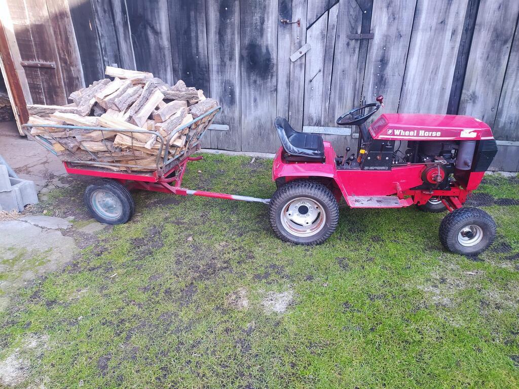

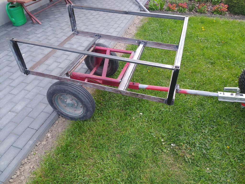

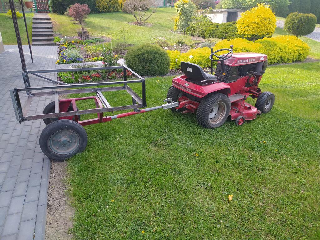

Stan50 212 #25901 Posted May 5 Some work on new steel box for WH trailer (dump trailer). Undercarriage needed some work,but that is the base for new "dump box" , aside original platform for hauling wood (2 in 1). Materials: old 2 wheel wheelbarrow, old bed frame, scrap metal and some new metal pieces. Fit for wooden pallet 120x80 cm. My original modified patform for hauling wood, hay, grass,branches etc 16 3 Share this post Link to post Share on other sites

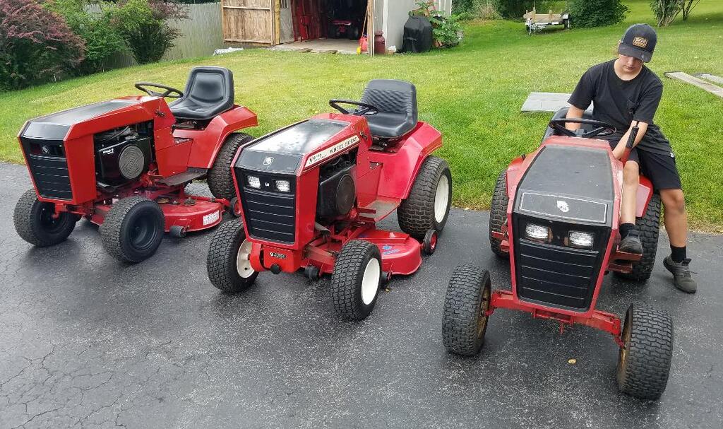

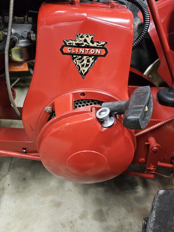

ML3 2,442 #25902 Posted May 5 On 5/3/2026 at 1:09 PM, ML3 said: . I have manuals on all of them if you need. Thanks for the manuals. Pretty sure I got the recoil fixed🤞 6 Share this post Link to post Share on other sites
lynnmor 8,957 #25903 Posted May 5 7 hours ago, Stan50 said: Some work on new steel box for WH trailer (dump trailer). Undercarriage needed some work,but that is the base for new "dump box" , aside original platform for hauling wood (2 in 1). Materials: old 2 wheel wheelbarrow, old bed frame, scrap metal and some new metal pieces. Fit for wooden pallet 120x80 cm. My original modified patform for hauling wood, hay, grass,branches etc A couple of vertical pieces on each side would strengthen the frame considerably since both top and bottom would work in tandem. Many store bought utility trailers use this idea. 2 Share this post Link to post Share on other sites

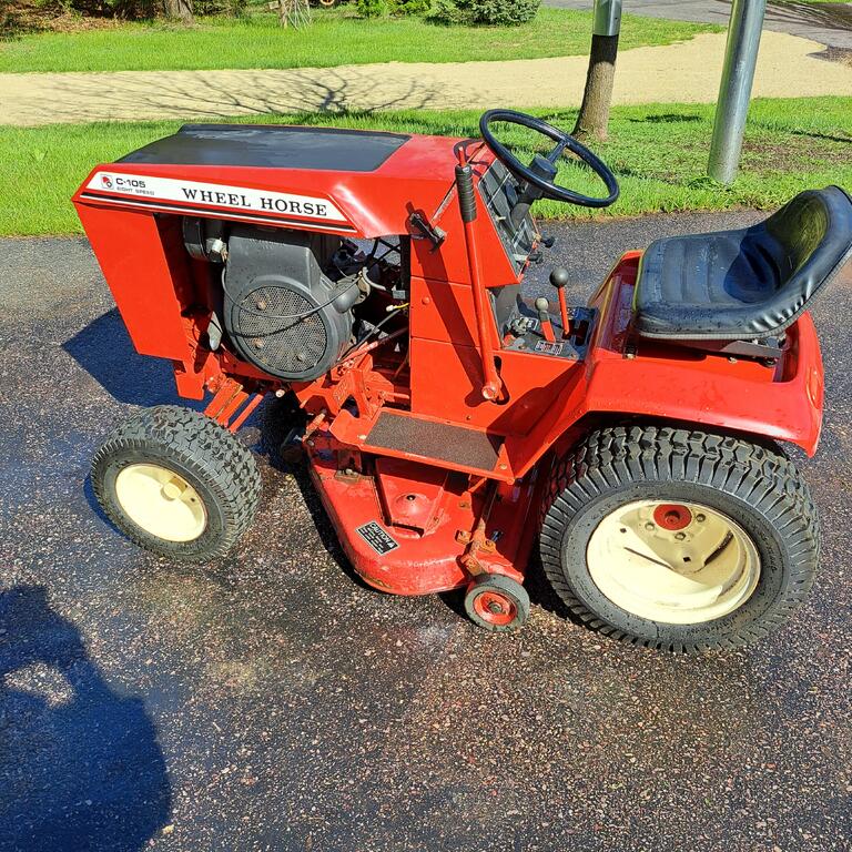

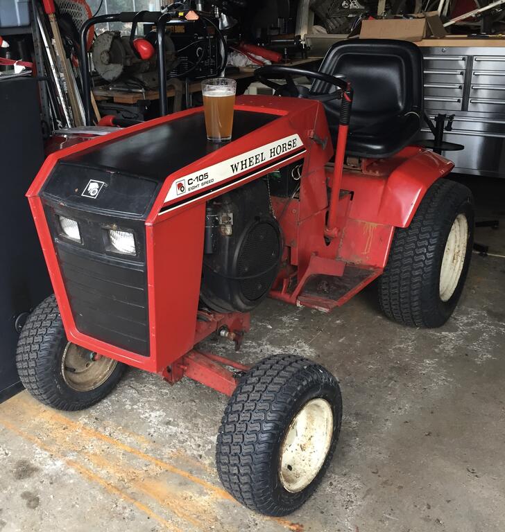

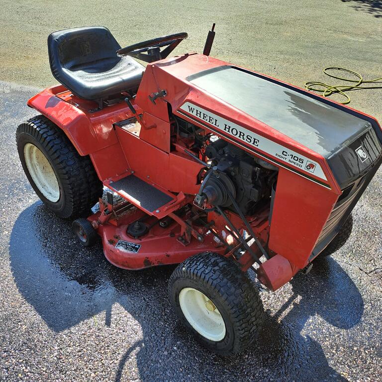

WHX?? 57,601 #25904 Posted May 5 (edited) Not mine but a customer's. Sharpen blades & change oil & check over kind of thing. Repair a busted coil bracket. Real nice '82 C-105 all original. So nice his one may not leave the ranch. The mafia may have to make an offer he can't refuse... First step was a bath. Edited May 6 by WHX?? 6 8 Share this post Link to post Share on other sites
SylvanLakeWH 31,911 #25905 Posted May 6 @WHX?? tell your C-105 his Michigan cousin says "Cheers"... You know you need a Black Hood in the stable... 5 6 Share this post Link to post Share on other sites
Brockport Bill 2,439 #25906 Posted May 6 1 hour ago, SylvanLakeWH said: @WHX?? tell your C-105 his Michigan cousin says "Cheers"... You know you need a Black Hood in the stable... gotta luv the Blackhoods 5 6 2 Share this post Link to post Share on other sites

Stan50 212 #25908 Posted May 6 7 hours ago, lynnmor said: A couple of vertical pieces on each side would strengthen the frame considerably since both top and bottom would work in tandem. Many store bought utility trailers use this idea. Yes, I will do that, just I had some fun with driving in circles yesterday 5 1 Share this post Link to post Share on other sites

WHX?? 57,601 #25913 Posted May 6 15 hours ago, Brockport Bill said: gotta luv the Blackhoods I thought they was a red headed step child. Then I got one and it grew on me. Then I put solid motor mounts on and it was all over. 3 3 2 Share this post Link to post Share on other sites

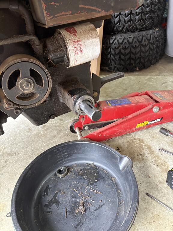

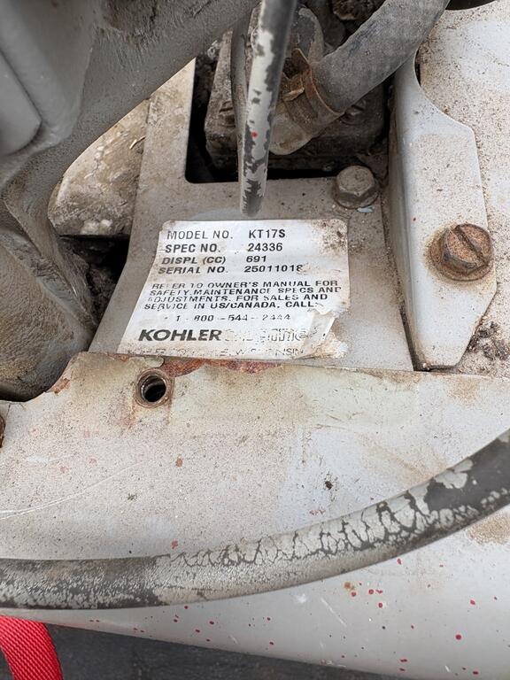

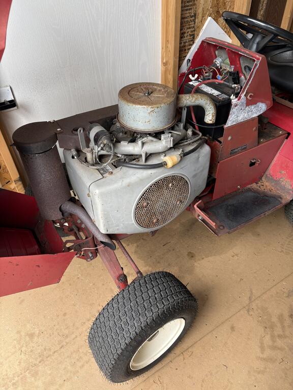

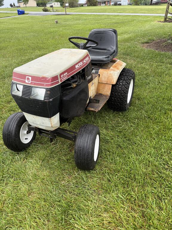

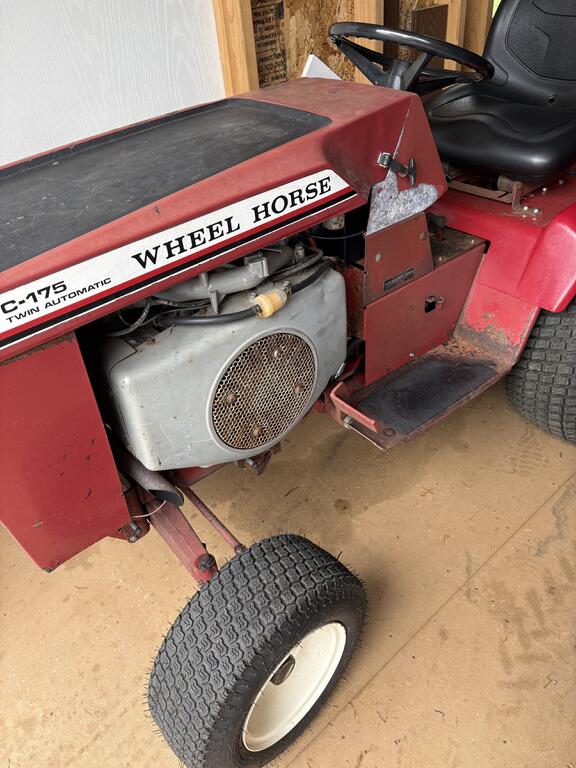

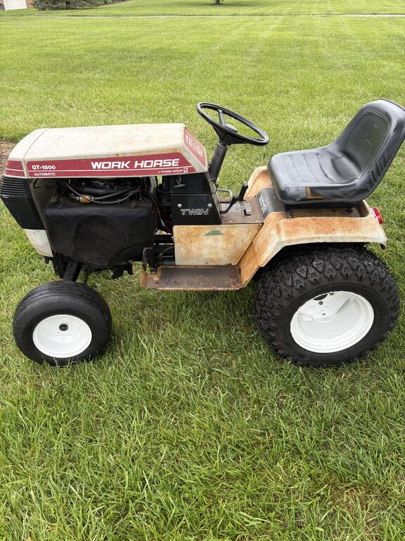

Sodaking27 1,310 #25914 Posted May 6 Lots of progress over the last couple days. Got the replacement motor installed in the C175. Runs like a top. Replaced the leaking axle seal on the GT1800 and finally installed its new shoes that I’ve had settling for 2 years. 6 9 Share this post Link to post Share on other sites
pfrederi 20,964 #25915 Posted May 6 8 minutes ago, Sodaking27 said: Lots of progress over the last couple days. Got the replacement motor installed in the C175. Runs like a top. Replaced the leaking axle seal on the GT1800 and finally installed its new shoes that I’ve had settling for 2 years. Is the spec number on that KT-17 24336?? It is a series 2 service engine that WH ordered I guess to replace the failed series 1 in a lot of C-175... 4 Share this post Link to post Share on other sites
Sodaking27 1,310 #25916 Posted May 6 33 minutes ago, pfrederi said: Is the spec number on that KT-17 24336?? It is a series 2 service engine that WH ordered I guess to replace the failed series 1 in a lot of C-175... Yes it is. 5 2 1 Share this post Link to post Share on other sites

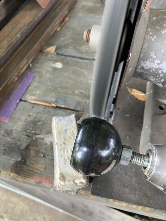

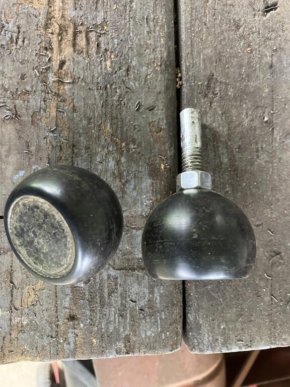

oliver2-44 11,654 #25918 Posted May 6 Polished some transmission shifter balls. No before pictures, but these were really rough and faded gray. Sanded them in drill press 180, 320, 600, 1000, 1500, 2000. Polished them on a buffing wheel with white rouge. I have the drill turn the opposite of the buffing wheel. 7 Share this post Link to post Share on other sites

ebinmaine 79,951 #25921 Posted May 6 59 minutes ago, oliver2-44 said: Polished some transmission shifter balls Slick! 1 Share this post Link to post Share on other sites
WHX?? 57,601 #25922 Posted May 7 4 hours ago, pfrederi said: spec number on that KT-17 24336?? Does that S after 17 mean a series 2 service motor? 1 Share this post Link to post Share on other sites

pfrederi 20,964 #25924 Posted May 7 1 hour ago, WHX?? said: Does that S after 17 mean a series 2 service motor? Spec # is Series 2 Higher than 24300 Gray color indicates service motor 1 1 Share this post Link to post Share on other sites
