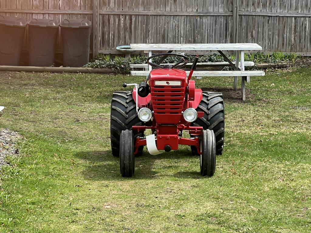

Chris689 355 #25676 Posted April 8 On 4/6/2026 at 5:14 PM, ebinmaine said: Niiiiice work! Thank you. I’ve been looking for a front hitch for a couple years now. I found a few on eBay a while ago but haven’t seen em on there since. I ran across the thread on here a few days ago and remembered I got a seized up mule drive with my 73 and figured it was the perfect candidate. 1 1 Share this post Link to post Share on other sites

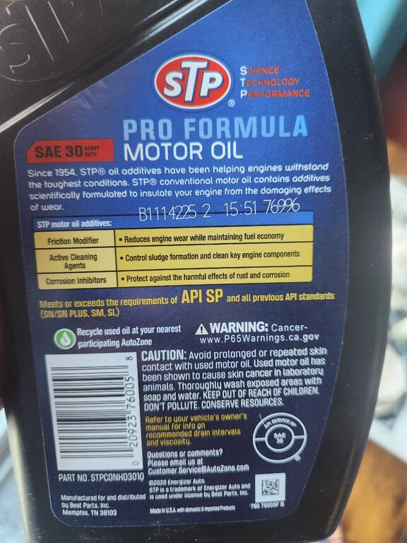

CasaytheMann 288 #25678 Posted April 9 I changed the oil and oil filter, and greased all 4 zircs. The recycler deflector had both bottom corners broken off, which sent grass all over the place, so I installed a piece of flooring and metal retainer to block it off. Buying a new deflector and parts for $75+ isn't in my budget at the moment. On a side note, I went down to the local Autozone to buy some sae30 oil. I didn't see any on the shelf so I asked an employee if they had any in the back warehouse. I told him I needed 2 qts. He came back with 2. When they rung it up, it showed it was 1 cent a qt. The manager said it was discontinued and they just wanted to get rid of it. I told them I'd buy whatever they had left. Walked out with 7 qts for 8 cents (sales tax was 1 cent). 5 6 1 1 Share this post Link to post Share on other sites

squonk 48,427 #25685 Posted April 9 21 hours ago, CasaytheMann said: I changed the oil and oil filter, and greased all 4 zircs. The recycler deflector had both bottom corners broken off, which sent grass all over the place, so I installed a piece of flooring and metal retainer to block it off. Buying a new deflector and parts for $75+ isn't in my budget at the moment. On a side note, I went down to the local Autozone to buy some sae30 oil. I didn't see any on the shelf so I asked an employee if they had any in the back warehouse. I told him I needed 2 qts. He came back with 2. When they rung it up, it showed it was 1 cent a qt. The manager said it was discontinued and they just wanted to get rid of it. I told them I'd buy whatever they had left. Walked out with 7 qts for 8 cents (sales tax was 1 cent). Are you sure it's DETERGENT SAE 30? Seems to cheap even of they aren't going to carry it anymore. I bought a gallon of Rotella 30W at the WaWa today . 2 Share this post Link to post Share on other sites

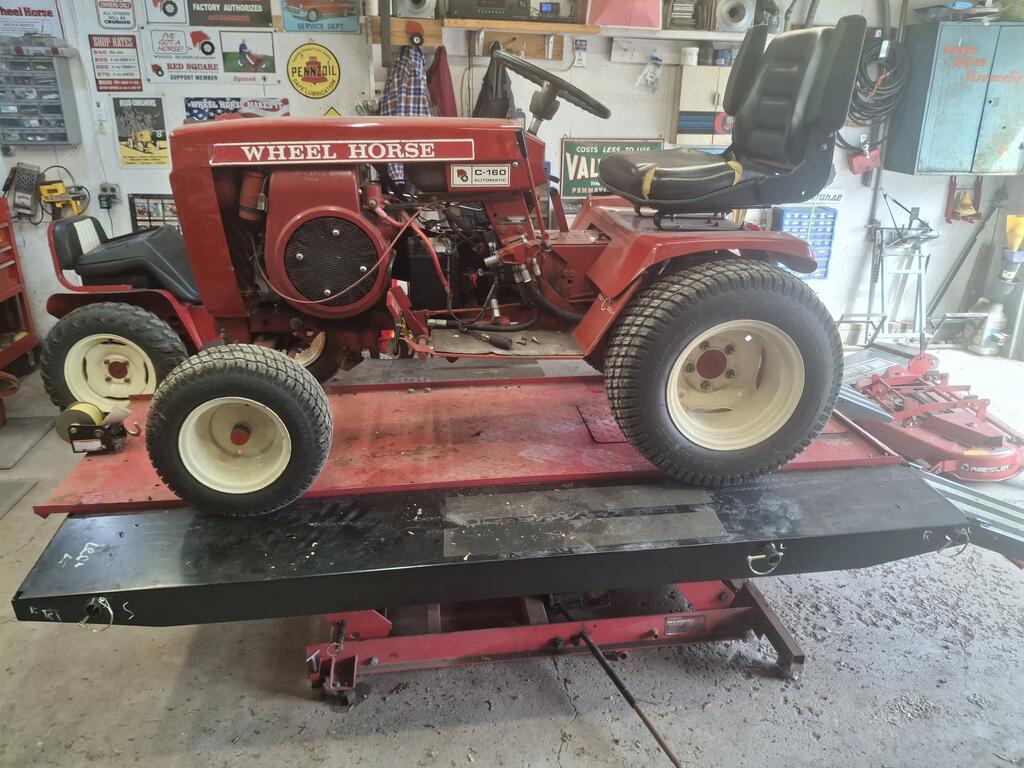

squonk 48,427 #25686 Posted April 9 Today was "Get the tractors ready to mow day" Went to the WaWa to get some Rotella 30W and a couple tubes of Red n Tacky Engine Oil change, added EZ oil drain valve ,grease and blade sharpening on the 875 Engine Oil change, Trans oil (Mobil 1 10W40 Napa 1410 filter) grease. New battery and blade sharpening on the C-160 6 3 Share this post Link to post Share on other sites
CasaytheMann 288 #25687 Posted April 10 2 hours ago, squonk said: Are you sure it's DETERGENT SAE 30? Seems to cheap even of they aren't going to carry it anymore. I bought a gallon of Rotella 30W at the WaWa today . 3 Share this post Link to post Share on other sites

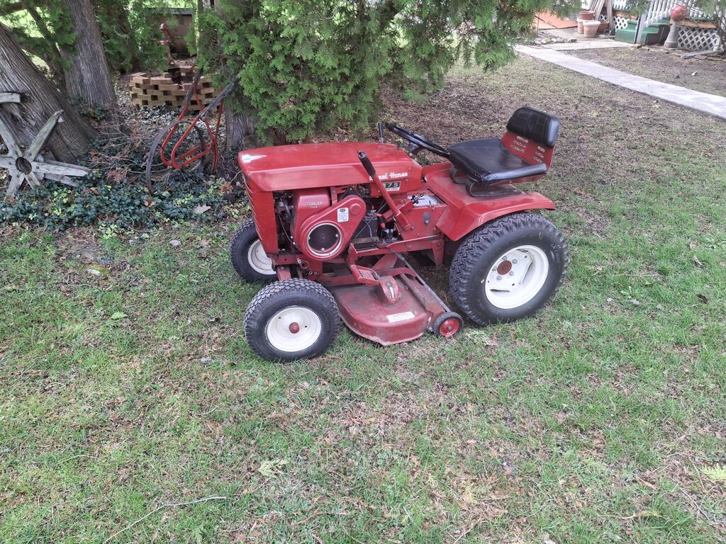

rjg854 13,454 #25689 Posted April 10 (edited) 20 hours ago, WHX?? said: No but the red porn that dirtys that oil is... Here you go then The line up 73 16 Auto & C160 68 Raider 12 68 Commando 854 Edited April 10 by rjg854 Sp 1 14 1 Share this post Link to post Share on other sites

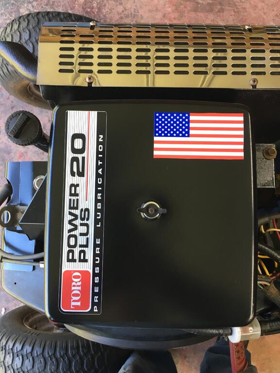

sqrlgtr 4,225 #25690 Posted April 10 (edited) Put a little bling bling on that came from Vinyl Guy. Changed engine and hydro oil and filters and added oil filter cooling tin gasket. Edited April 10 by sqrlgtr 8 2 Share this post Link to post Share on other sites

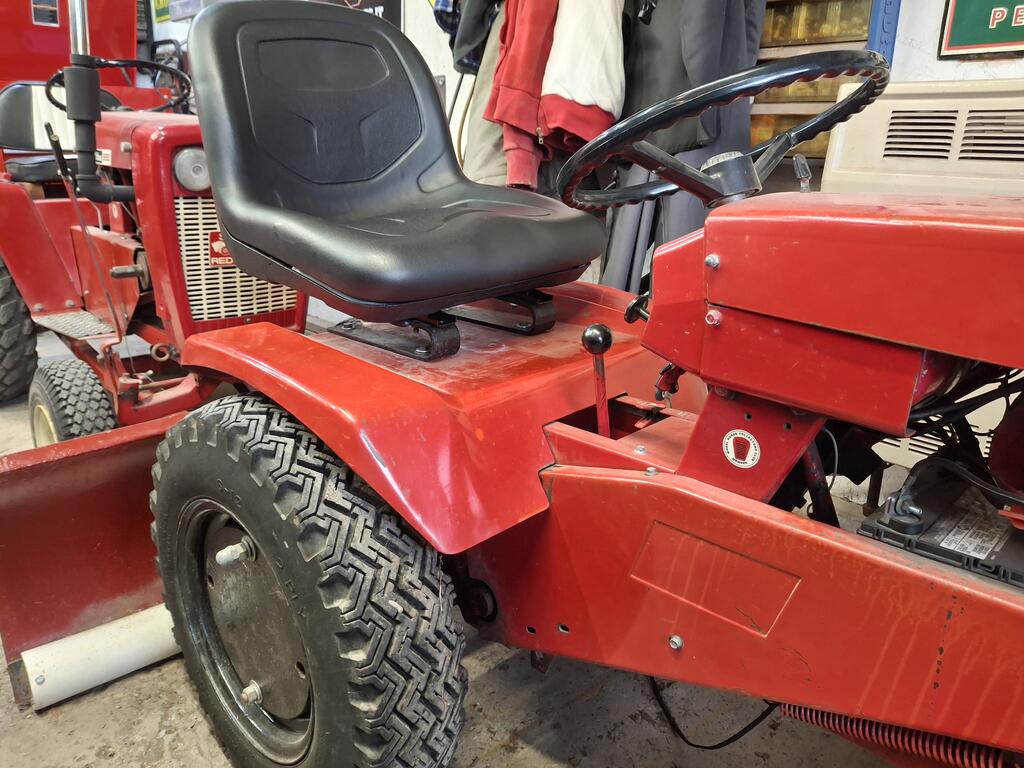

squonk 48,427 #25692 Posted April 10 Added adjustable seat tracks to HHHOOOWWWAAARRRDDD!!! 5 3 Share this post Link to post Share on other sites
ebinmaine 81,281 #25693 Posted April 11 13 hours ago, squonk said: Added adjustable seat tracks Are the seat tracks able to go further back? 13 hours ago, squonk said: to HHHOOOWWWAAARRRDDD!!! Is there a specific regulation dictating the count volume of each given letter? Was "3 per" a conscious 🤔 decision? 1 Share this post Link to post Share on other sites
squonk 48,427 #25694 Posted April 11 20 minutes ago, ebinmaine said: Are the seat tracks able to go further back? Is there a specific regulation dictating the count volume of each given letter? Was "3 per" a conscious 🤔 decision? Seat can go back farther and if you want to drill or elongate some holes even farther back yet. 3 HHHOOOWWWAAARRRDDD!!! letters sounded about right! ( If you'd come to the show and hear me yell that at him you'd agree!) 1 1 Share this post Link to post Share on other sites
Sparky-(Admin) 26,898 #25695 Posted April 11 1 hour ago, squonk said: Seat can go back farther and if you want to drill or elongate some holes even farther back yet. Hmmm…I have a set of those out in the shed. Been sitting there for years attached to a seat I’ve never used. I’ll have to go out and find em and see how they operate. I love extra leg room. 3 1 Share this post Link to post Share on other sites

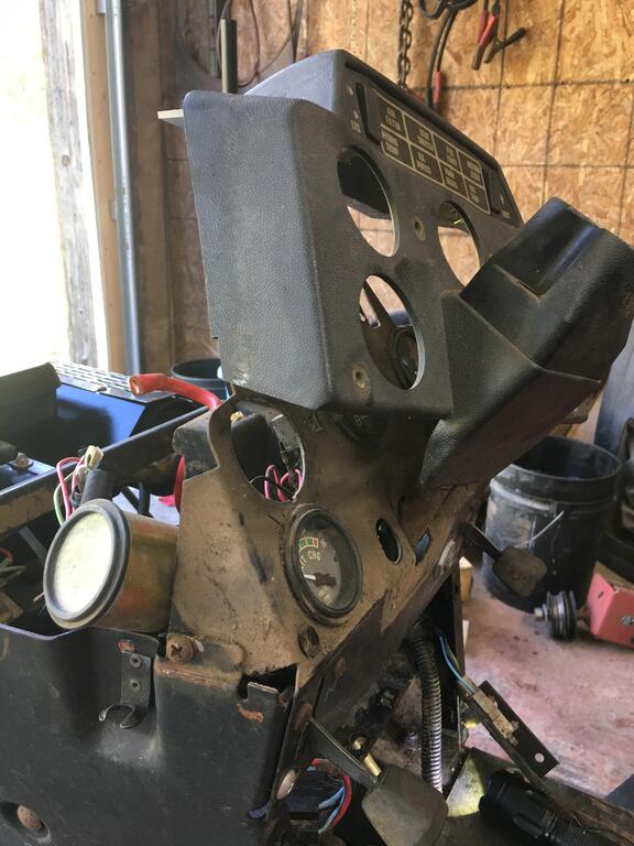

sqrlgtr 4,225 #25696 Posted April 11 (edited) Installed vacuum gauge on 520 today. Not going lie was kinda dreading getting steering wheel off but was easiest one Ive ever tackled . Had to take lift control lever off but the hydro control got to stay just loosened up to allow dash to move out of way. The harder tractor pulls the lower reading number on gauge, I had it in my mind it would read the other way. Also does anyone know if someone makes/sells steering wheel center cap for the 520? BTW big thanks to @Bow_Extreme for vacuum gauge. Edited April 11 by sqrlgtr 1 3 Share this post Link to post Share on other sites
cleat 9,450 #25697 Posted April 11 (edited) 32 minutes ago, sqrlgtr said: Installed vacuum gauge on 520 today. Not going lie was kinda dreading getting steering wheel off but was easiest one Ive ever tackled . Had to take lift control lever off but the hydro control got to stay just loosened up to allow dash to move out of way. The harder tractor pulls the lower reading number on gauge, I had it in my mind it would read the other way. Also does anyone know if someone makes/sells steering wheel center cap for the 520? BTW big thanks to @Bow_Extreme for vacuum gauge. Here is the link to wheel horse parts and more. He is a vendor on this site as well and great to deal with. https://wheelhorsepartsandmore.com/product/square-steering-wheel-insert-wheel-horse-logo/ Edited April 11 by cleat 1 3 1 Share this post Link to post Share on other sites
76c12091520h 4,299 #25698 Posted April 12 22 hours ago, cleat said: Here is the link to wheel horse parts and more. He is a vendor on this site as well and great to deal with. https://wheelhorsepartsandmore.com/product/square-steering-wheel-insert-wheel-horse-logo/ 22 hours ago, sqrlgtr said: Installed vacuum gauge on 520 today. Not going lie was kinda dreading getting steering wheel off but was easiest one Ive ever tackled . Had to take lift control lever off but the hydro control got to stay just loosened up to allow dash to move out of way. The harder tractor pulls the lower reading number on gauge, I had it in my mind it would read the other way. Also does anyone know if someone makes/sells steering wheel center cap for the 520? BTW big thanks to @Bow_Extreme for vacuum gauge. Correct size and texture, no logo, available here 1 2 1 Share this post Link to post Share on other sites

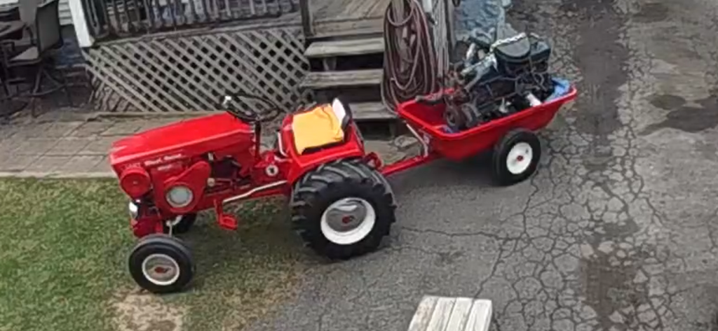

Thegearhead0324 1,902 #25700 Posted April 12 (edited) I used the 1257 and dump cart to haul 2 truck engines (one at a time) from the back shed to the driveway so I can sell them. They’ve been taking up room in the shed for years. Edited April 14 by Thegearhead0324 5 Share this post Link to post Share on other sites
