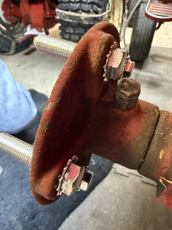

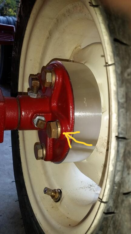

Sparky-(Admin) 26,299 #25363 Posted February 5 My sons bought small spacers for his tractor, last night I installed one side. Had to remove the hub set screw and replace with a 1/4” shorter one so that the two bolts heads wouldn’t hit. The 7/16 x 20 x 2” bolts can be a pain to find. 6 6 Share this post Link to post Share on other sites
702854boy 1,139 #25364 Posted February 5 5 minutes ago, Sparky said: Looks like he needs to change out his brake drum seal. 6 Share this post Link to post Share on other sites

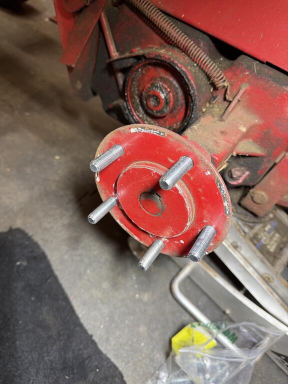

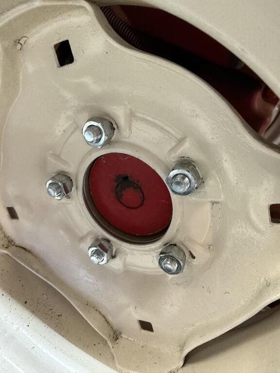

19richie66 17,932 #25365 Posted February 5 I put studs on all of my tractors. Best mod ever. I got a box of 25 off of ebay a while back. 7/16x20 Tap bolts. I need to order some more for my last project. 6 Share this post Link to post Share on other sites
WHX?? 58,052 #25366 Posted February 5 (edited) 11 hours ago, 702854boy said: Did you get your shorts, tang top, and flip flops out? Left that wardrobe for Pullstart... 2 hours ago, Sparky said: remove the hub set screw and replace with a 1/4” shorter one Mine just fit with the square heads. Mighta had to grind a smidge off the stud head. All depends on the hardware store to find them. I lucked out and found one that had them in all lengths but yes not full threads past 1 1/2. What's your theory with the star washers? I used thick flat washers to get them to seat flush. I like those spacers Mike ... source? Yes as Boy said looks like you might have a brake shaft seal issue there?? Edited February 5 by WHX?? 4 3 Share this post Link to post Share on other sites
Ed Kennell 47,254 #25367 Posted February 5 4 minutes ago, WHX?? said: I used thick flat washers to get them to seat flush. Looks like a lock washer to me. 4 1 Share this post Link to post Share on other sites
rjg854 13,341 #25368 Posted February 5 5 minutes ago, Ed Kennell said: Looks like a lock washer to me. Take it easy on Jim, you remember where he's from don't you ? 1 6 Share this post Link to post Share on other sites

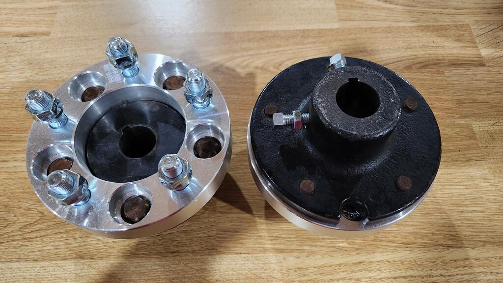

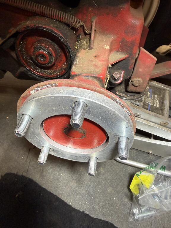

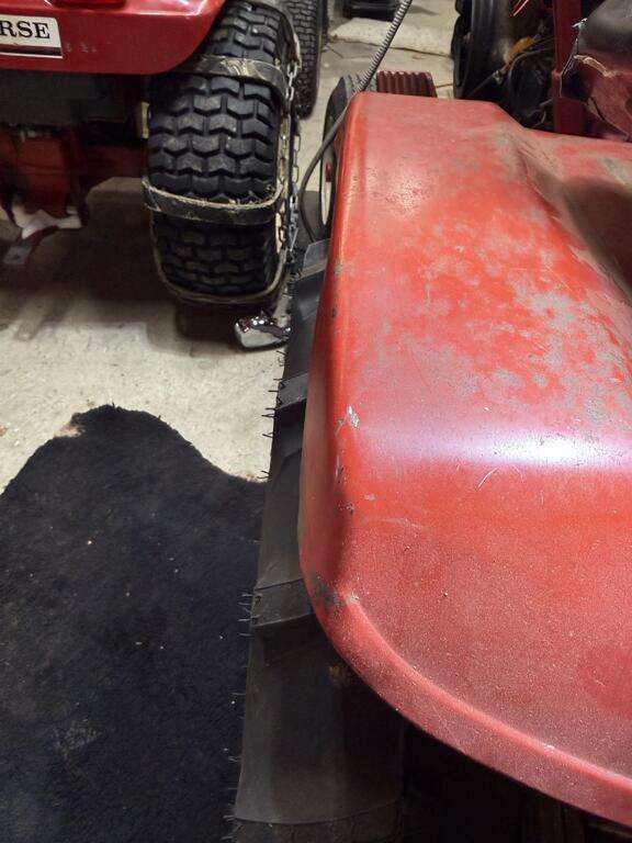

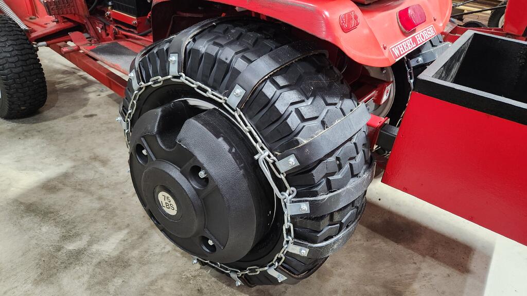

Racinbob 13,135 #25369 Posted February 5 Once I out the chains on the 23-10.50's on my Reborn B-80 I felt there should be a little more clearance. I moved the hubs out a bit to get by but I don't like it like that. Found these on Ebay for pretty cheap and tried them out on the hubs I just saved. I was just able to get a socket the stock lug bolts to mount them. 2 6 Share this post Link to post Share on other sites
lynnmor 9,037 #25370 Posted February 5 10 minutes ago, Ed Kennell said: Looks like a lock washer to me. Unless they have both internal and external teeth it appears they aren't locking anything. 3 Share this post Link to post Share on other sites
WHX?? 58,052 #25371 Posted February 5 (edited) 14 minutes ago, Ed Kennell said: Looks like a lock washer to me. On mine Ed? They might have been on that tractor. 7 minutes ago, Racinbob said: Ebay for pretty cheap Same ones I got Bob ... flea bay for less than 25 shipped. The studs are 1/2" tho. Shoulda got another pair right away can't find them now. Really a nice lookin setup there Bob Edited February 5 by WHX?? 6 Share this post Link to post Share on other sites
Ed Kennell 47,254 #25372 Posted February 5 5 minutes ago, lynnmor said: Unless they have both internal and external teeth it appears they aren't locking anything. s I was looking at Jims washers Lynn. 3 Share this post Link to post Share on other sites
Racinbob 13,135 #25373 Posted February 5 14 minutes ago, WHX?? said: On mine Ed? They might have been on that tractor. Same ones I got Bob ... flea bay for less than 25 shipped. The studs are 1/2" tho. Shoulda got another pair right away can't find them now. Really a nice lookin setup there Bob Pretty close. They were $16 but with tax and shipping $25 and a few pennies. I'm sure they are out there but I've never come across spacers with 7/16" studs. I'm thinking the lock washers are more for getting around that little taper on the bolt. I've countersank them in the past. 4 Share this post Link to post Share on other sites
WHX?? 58,052 #25374 Posted February 5 1 minute ago, Racinbob said: never come across spacers with 7/16" studs. Because they are for automotive ... Jeeps 2 minutes ago, Racinbob said: lock washers are more for getting around that little taper on the bolt. I've countersank them in the past. Yep ... good idea on the slight counter sink. 4 Share this post Link to post Share on other sites
WHX?? 58,052 #25375 Posted February 5 (edited) 21 minutes ago, Ed Kennell said: was looking at Jims washers Lynn The thick flats can be hard to find too. Really no need for locks other than a spacer. Once the nut is on they ain't going nowhere. If one can find the thicks in 3/8 they work great for head bolts. Edited February 5 by WHX?? 5 Share this post Link to post Share on other sites
