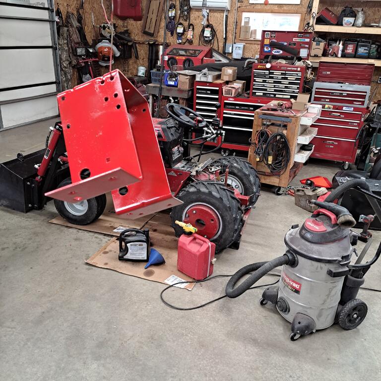

cafoose 3,847 #25302 Posted January 19 The steering on my GT-14 FEL I got from @fast88pu a few years ago at the Big Show was skipping teeth and unpredictable I investigated and found the housing support for the steering shaft was broken. I have a parts GT-14 that had a good support on it so I "borrowed" it Top one in picture is broken. Bottom one is the good one. It came off the donor easily but it's a tight fit getting it on the FEL tractor. I found the starter shield on the shroud is in the way. I started to remove it for better access and it won't come off I removed all the bolts I found that held it on and it wiggles but won't pull off 3 1 Share this post Link to post Share on other sites

cafoose 3,847 #25304 Posted January 19 14 hours ago, Bar Nuthin said: Did you try pulling harder? 14 hours ago, cafoose said: I started to remove it for better access and it won't come off I removed all the bolts I found that held it on and it wiggles but won't pull off Dummy me didn't realize I needed to remove the flywheel screen for it to come off Got the new steering tower in place and started reassembling everything 2 2 2 Share this post Link to post Share on other sites

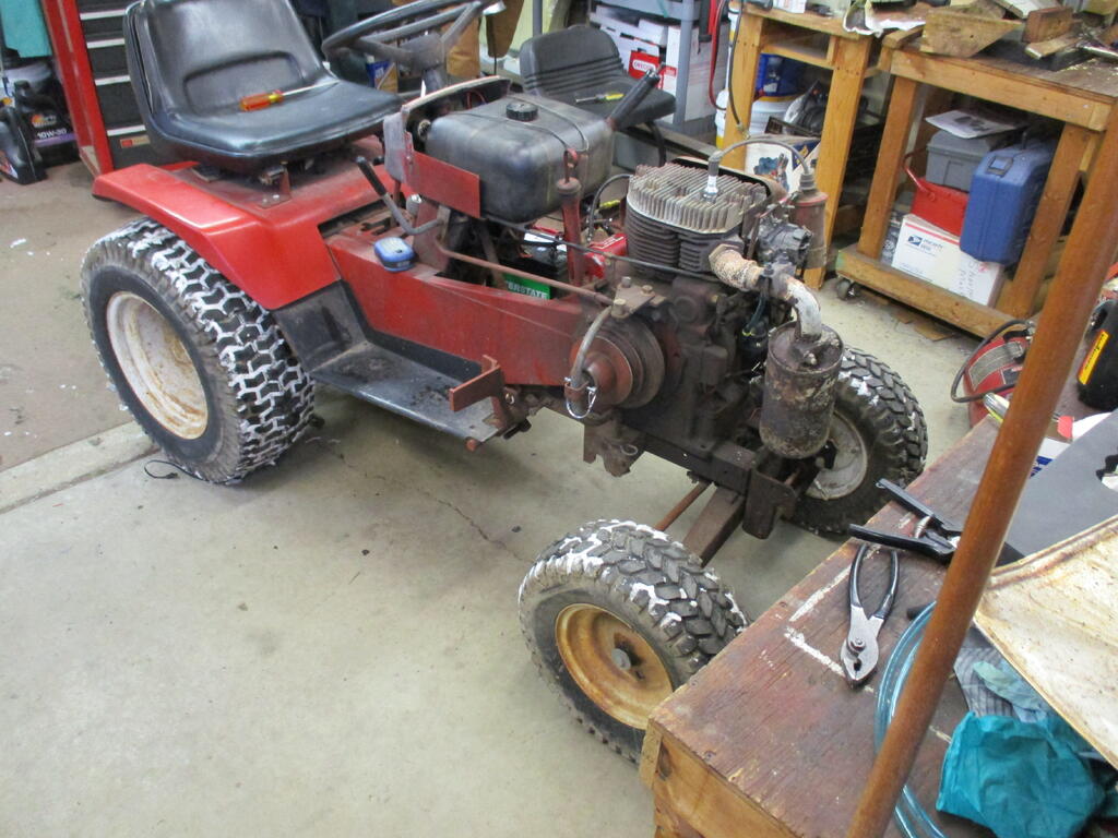

pfrederi 21,150 #25305 Posted January 19 Finished the fuel system today for testing purposes. New pump lines filter. Starts and runs well at full throttle still a little pop at idle but it is too cold out to spend much time fine tuning,. Ran in all gears Hi/Lo. up and down the drive way (see snow on tires, there are no pics of the test run. Ass't camera person doesn't come out when it is this cold ). Really wondering about the one rear axle it sticks out just over an inch from the hub. The hub is up against the tranny housing just like the other side. Wonder if some PO replaced the axle with a longer one from a 6 spd and if so why??? 7 1 Share this post Link to post Share on other sites

cafoose 3,847 #25307 Posted January 19 6 hours ago, cafoose said: Dummy me didn't realize I needed to remove the flywheel screen for it to come off Got the new steering tower in place and started reassembling everything All back together and steering like new 3 3 Share this post Link to post Share on other sites
ebinmaine 80,709 #25308 Posted January 19 2 hours ago, pfrederi said: Really wondering about the one rear axle it sticks out just over an inch from the hub. The hub is up against the tranny housing just like the other side. Wonder if some PO replaced the axle with a longer one from a 6 spd and if so why??? A 6 or 8 speed transmission should have a good inch of axle shaft showing between the back of the hub and the transmission case. If the other side is flush to the outside of the hub AND touching the transmission case... that's the short axle. Not original. 4 Share this post Link to post Share on other sites
kpinnc 18,965 #25309 Posted January 19 3 minutes ago, ebinmaine said: Not original. Probably the original got chewed up at the bearing and the PO replaced with the wrong part. There are a bunch of different ones that can (obviously) be made to work. PO may have checked the Toro price and just used what he had instead- once he woke up and got up off the floor... 1 4 Share this post Link to post Share on other sites

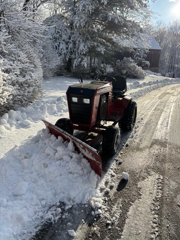

Skwerl58 843 #25316 Posted January 25 Today I got the 414-8 ready to move the snow and sleet that is forecast for tonight and tomorrow. Have chains if needed and the rear tires are filled with rv antifreeze and have a mule drive weight bracket with twenty pounds. Hopefully all is ready. Be safe! 7 5 Share this post Link to post Share on other sites

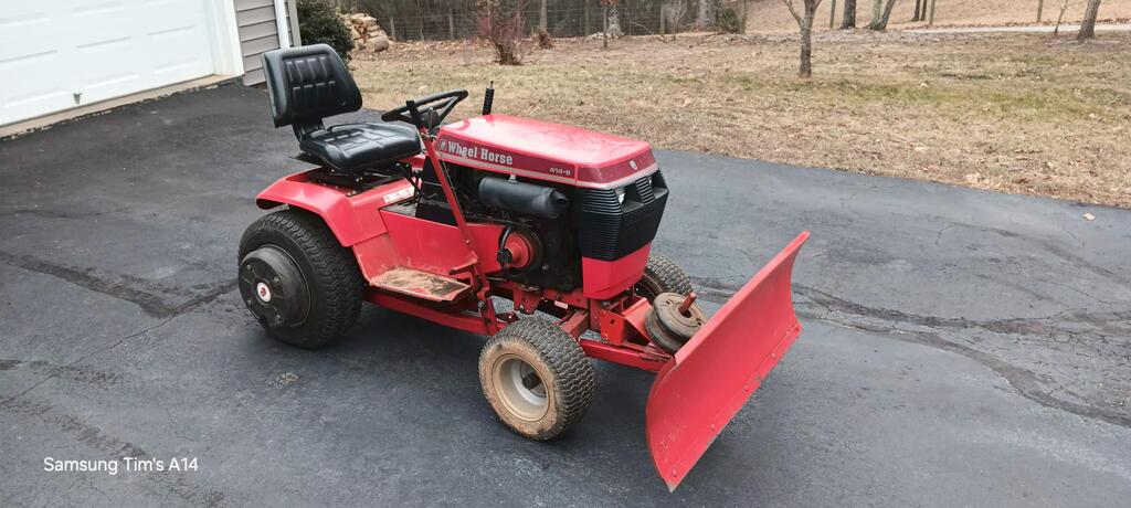

Jimmy66 47 #25317 Posted January 25 Finally put the snow blade on. We got a good layer of ice here in Georgetown, Texas last night. Blade just gliding on the top. Maybe I'll try putting a wheel weight on the blade and see if that makes a difference. Adjusted the angle and got a little bit of a bite but I I suppose it's a lot to ask for this little tractor to break through the ice. Maybe I can try low gear with the heavy weight on the blade, on my first attempt I was on high 1. 5 1 Share this post Link to post Share on other sites
