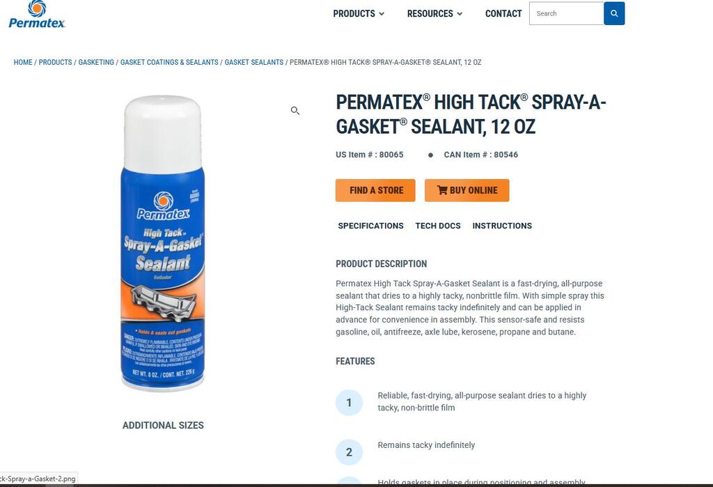

Hope that RTV doesn't come back to bite you by getting into acceleration valves.   I have good results spraying this stuff on the paper gasket.

I used that sealant on my second attempt. Improved but not cured my woes. This time I took particular care to lay a nice bead to minimize squeeze out from the RTV. Looking at the outside, I'd say I'm in good shape.  Now that I've had the hydro-pump and motor apart, I wouldn't be afraid to tackle it again, if needed. Much in part to some of your excellent posts.
