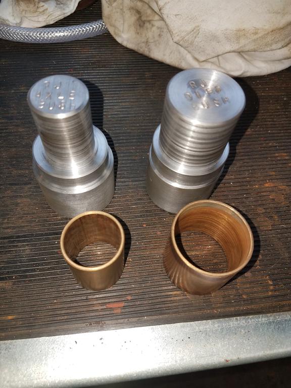

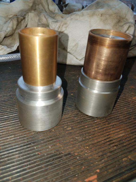

prondzy 3,889 #1 Posted January 14, 2018 Played around on the lathe today and turned out some dies for pressing bronze bushings into 3pc differentials and axle tubes. This way i minimize the amount of mushrooming when i press them in vs beating them in with a hammer and socket. Going to use them on my upcoming suburban transmission rebuild. 16 14 Share this post Link to post Share on other sites
Daddy Don 911 #2 Posted January 14, 2018 A lot of guys would like to have a set of these. Great job. 1 2 1 Share this post Link to post Share on other sites
Achto 30,228 #4 Posted January 15, 2018 Those look awesome!! Should make the job go much easier. Share this post Link to post Share on other sites
