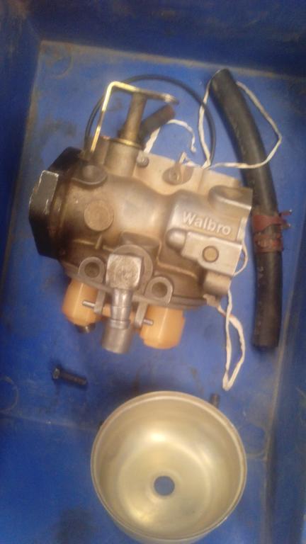

Carlos VB 14 #42 Posted May 18, 2018 Still problems, once I got the spark plug was in place, WH worked for one day, next one didn´t want to start. Now I need to finde the carburator bowl gasket. It is a WALBRO, could I know the Kohler part number, well the point is to find the carburator model and try to find the proper bowl gasket. Share this post Link to post Share on other sites

formariz 12,381 #45 Posted May 20, 2018 Carlos, can you post a good photo of your carburetor? Those kits are easy to get here. I have family here again going back in two weeks if you want to. They can mail it to you from there it is very small. 1 Share this post Link to post Share on other sites

Carlos VB 14 #48 Posted May 22, 2018 I would like to have a picture of the original one and try to find it here, please could somebody post one... Share this post Link to post Share on other sites
formariz 12,381 #49 Posted May 23, 2018 Carlos, that engine came with two different carburetors, a Walbro with a fixed jet which is what you have, and a Kohler with adjustable jet. Changing the engine because of the carburetor is a bit drastic and you will just be just getting into all kinds of trouble over there. Below is a link on eBay to the parts you need for what you have. Its a simple job and a routine maintenance issue.Let me know if you need help with it. https://www.ebay.com/itm/KOHLER-CARB-REBUILD-Walbro-M8-M10-M12-M14-M16/140892169040?hash=item20cdd3e350:g:kvEAAOxygo9Q5~OM:sc:USPSFirstClass!07009!US!-1 1 Share this post Link to post Share on other sites
