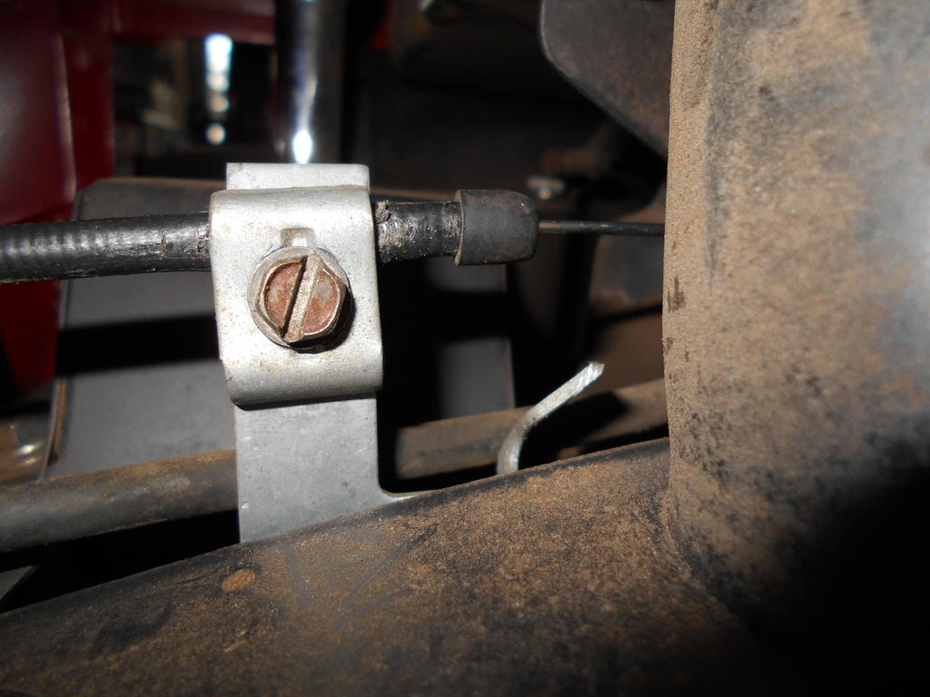

cleat 8,715 #14 Posted January 15, 2018 (edited) Do you have the little end seal ? Is it in the proper pushed on position as shown ? These do tend to fall off. Also, the cable outer sheathing can get damaged. I slip on heat shrink tubing then shrink it on tight. 2 layers of this will work best for added abrasion resistance. You can just make out the start of one on a throttle cable on my 520HC just forward of the battery. Cleat Edited January 15, 2018 by cleat 1 Share this post Link to post Share on other sites
