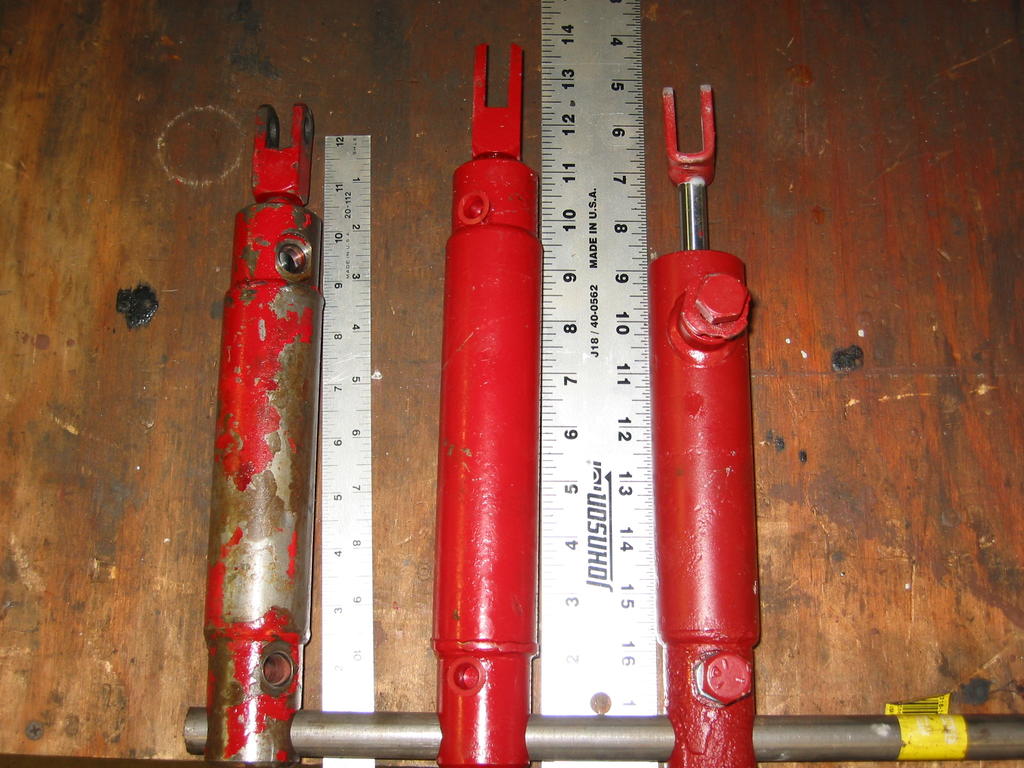

pfrederi 19,278 #1 Posted January 13, 2018 (edited) Can any one identify the center cylinder in the picture?? The housing is 10-1/2 inches long a full inch longer than the type of welded cylinder used on Chargers (left) and the reparable type used later on C series etc (right). The ports on the center one are tilted relative to the mount but an opposite tilt of the type used on Chargers. Edited January 13, 2018 by pfrederi Share this post Link to post Share on other sites
R. L. Addison 299 #2 Posted January 13, 2018 Add on kit for the 1257 type Machine? Share this post Link to post Share on other sites
daveoman1966 3,881 #3 Posted January 13, 2018 That middloe cylinder is part # 6618. Used on 1971 - 74 models. Charger, Bronco 14, 12 hp no-name year, etc. Both ends of it are welded shut and can be cut open to replace O-ring, then re-welded. The other two have snap-rings to open one end for rebuild. I need a good one for my Bronco 14...is it for sale? 1 Share this post Link to post Share on other sites
pfrederi 19,278 #4 Posted January 13, 2018 Dave: I just went out and measured the cylinders on 3 charger/electros in the shop (Snow horses). The cylinder housings are about 9.5 long. That is the same as the one on the left it is also a welded cylinder and is I think a 6618. I tried to put the center one on a Charger 10 that I was upgrading to hydro lift and it would not fit. The housing on it is about 10.5 " Share this post Link to post Share on other sites
pfrederi 19,278 #6 Posted January 13, 2018 3 minutes ago, Shynon said: 953/1054 Do you need one??? Share this post Link to post Share on other sites
953 nut 63,072 #7 Posted January 13, 2018 1 hour ago, pfrederi said: Do you need one??? how much, PM sent. Share this post Link to post Share on other sites
daveoman1966 3,881 #8 Posted January 14, 2018 MY BAD....I stand CORRECTED..... and agree that the one on left is # 6618. No idea what the center one is, or even if it a Wheelhorse product. YES>>> I do need on...as on the LEFT.... only if it is a 'non-leaker' that is. If so, what is your price? Share this post Link to post Share on other sites
pfrederi 19,278 #9 Posted January 14, 2018 6 hours ago, daveoman1966 said: MY BAD....I stand CORRECTED..... and agree that the one on left is # 6618. No idea what the center one is, or even if it a Wheelhorse product. YES>>> I do need on...as on the LEFT.... only if it is a 'non-leaker' that is. If so, what is your price? The left one (6618) is going on a tractor sometime this winter ,,,sorry. Share this post Link to post Share on other sites
