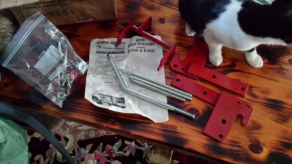

Thegearhead0324 1,547 #1 Posted January 10, 2018 I recently just purchased a 8-5551 hitch for my 1257. Do I have to trim the hood bracket on the bottom? Share this post Link to post Share on other sites
520hC-120 136 #2 Posted January 10, 2018 On all 5 of my s I don’t see any sort of trimming, and installing one on my 520 didn’t require anything it just went right on Hope it helps Nice cat 🐈 1 Share this post Link to post Share on other sites
Thegearhead0324 1,547 #3 Posted January 10, 2018 Hmm.... I saw I'm the manual that the sides had to be trimmed on the earlier long frames like mine I didn't know if there was another way. Share this post Link to post Share on other sites
WHX?? 56,847 #4 Posted January 10, 2018 Looks NOS ...where did score that been looking for one myself. Share this post Link to post Share on other sites
Thegearhead0324 1,547 #5 Posted January 10, 2018 Fleabay. Caught it on first day lol. Very reasonable as well. 1 Share this post Link to post Share on other sites
pfrederi 20,675 #6 Posted January 10, 2018 Bolted on to an Electro and a Charger and Lawn Ranger without mods. Have a problem with another charger. Wheel horse didn't center the hood hinge when they welded it to the frame, Welder must have had a hang over Nice Tuxedo 1 Share this post Link to post Share on other sites

prondzy 3,889 #10 Posted January 11, 2018 Yes you are suppose to cut the hood brackets per the instructions that came with it. Share this post Link to post Share on other sites
Thegearhead0324 1,547 #11 Posted January 11, 2018 My next question I'm prolly just not seeing it but from the pic above where does that threaded angled rod go? Share this post Link to post Share on other sites
pfrederi 20,675 #12 Posted January 11, 2018 (edited) That is a replacement lift rod needed if your tractor ddin't have one It goes between the implement lift rock shaft and whatever mower deck, or plow you are lifting. Edited January 11, 2018 by pfrederi Share this post Link to post Share on other sites
Thegearhead0324 1,547 #13 Posted January 11, 2018 Ahh... that makes more sense now. I was looking all over the diagram for the front hitch thinking where does this go. Thank you for clearing that up. Share this post Link to post Share on other sites
