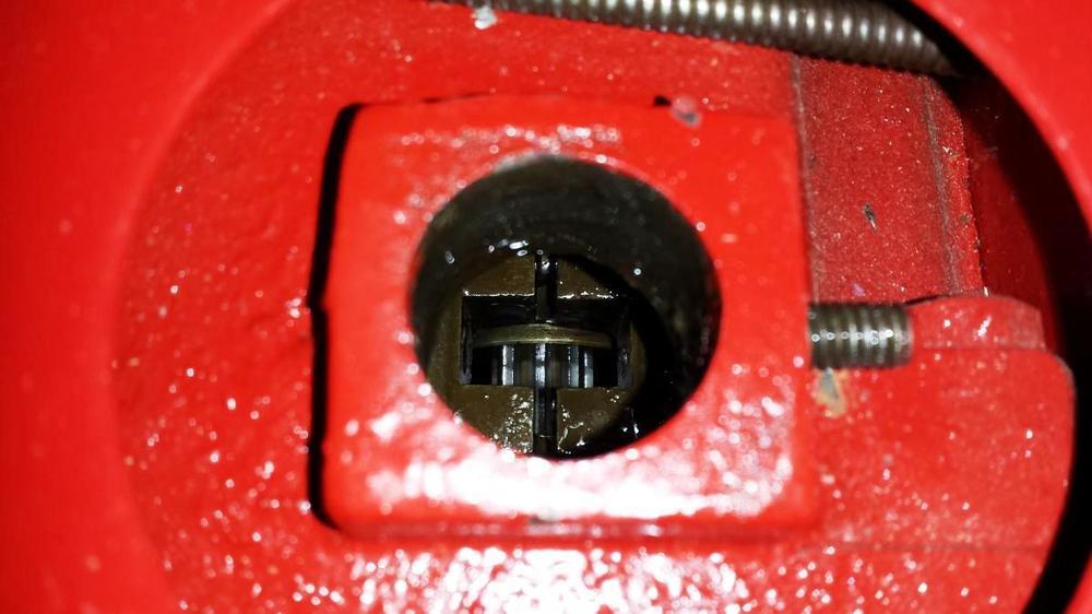

wallfish 18,353 #4 Posted January 9, 2018 30 minutes ago, Oldman said: I had this trouble with it getting caught between gears two or three times already This can be caused by a worn shifter, the ball on the end of the shifter or loose doughnut piece where the dog point screw holds it Loose dogpoint set screw The forks should form a square opening when in neutral. Use a screwdriver through the hole to try and find the one you can't see. It should slide back to neutral. If your trans is freezing it's because there's water contamination in there. Oil doesn't freeze solid. 1 3 Share this post Link to post Share on other sites
953 nut 60,705 #5 Posted January 9, 2018 4 minutes ago, wallfish said: The forks should form a square opening when in neutral. Use a screwdriver through the hole to try and find the one you can't see. It should slide back to neutral 1 2 Share this post Link to post Share on other sites
"Manic-Mechanic" 1,275 #6 Posted January 9, 2018 Excellent feedback,and the ball on the shifter has some flat spots, I have another one which I'll check out this morning. It's already 30 outside, so looks like a warm day is here. Great picture there 953 nut! Oldman 3 Share this post Link to post Share on other sites

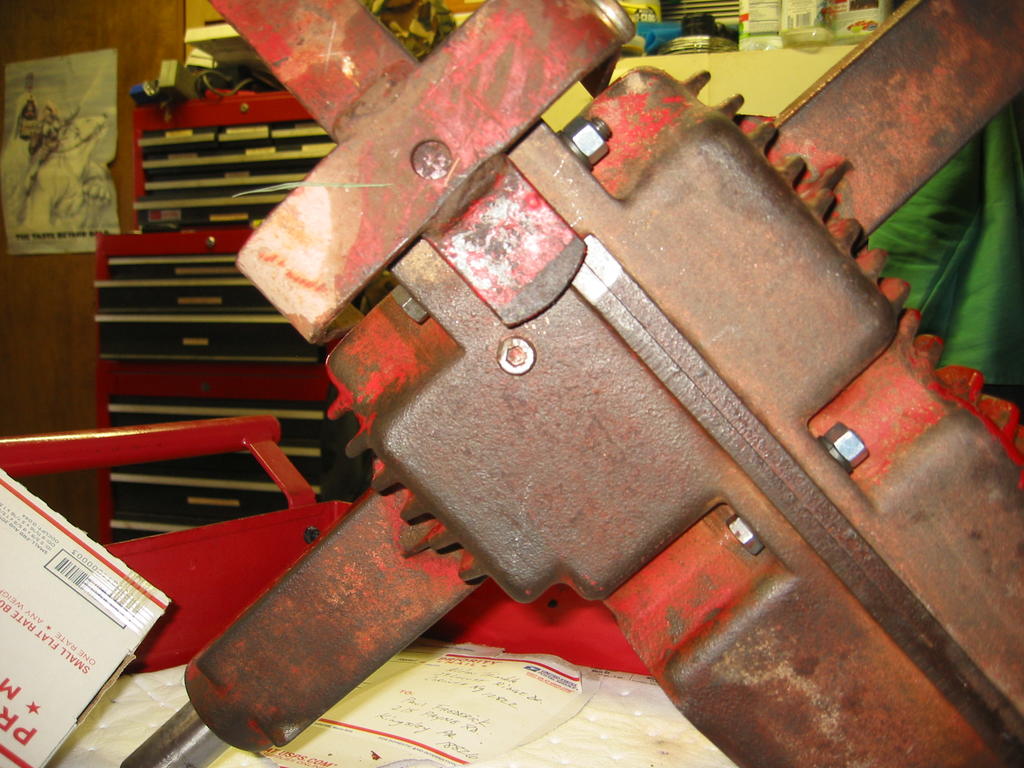

pfrederi 18,771 #16 Posted January 12, 2018 Bottom of the transaxle just to the left of the tongue of the hitch that is under the rear end. it is a 1/4" allen plug 1 3 Share this post Link to post Share on other sites
"Manic-Mechanic" 1,275 #17 Posted January 12, 2018 (edited) Another excellent picture! Well, that is amazing because even though I know the plug is there, I always have to reach around under there to find it! I filled the transmission back up with kerosene and sat and watched with amazement as nothing leaked! No complaints here though. Still I'll watch the underside of the transmission after filling it with the gear oil, again 90-140. Nice to have things work out for a change......."knock on wood". Oldman Edited January 12, 2018 by Oldman 1 2 Share this post Link to post Share on other sites
