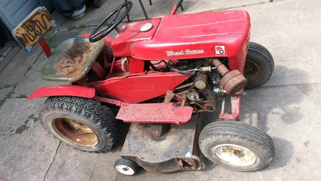

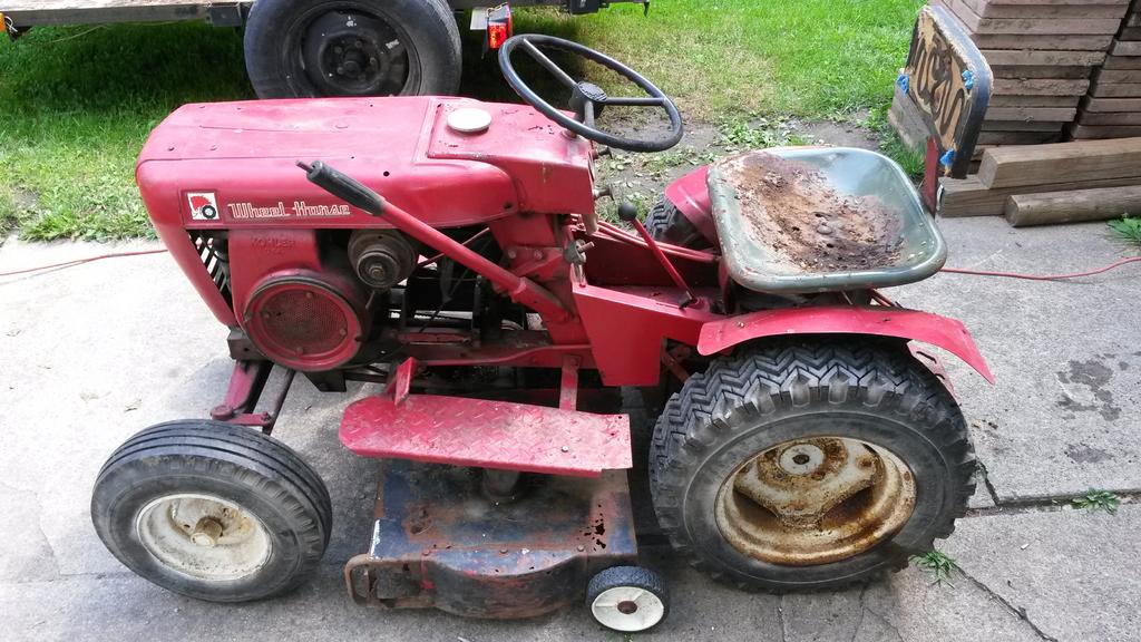

Chris G 3,369 #4 Posted January 6, 2018 I picked up a round hood this summer that had some homemade floor boards 1 Share this post Link to post Share on other sites
