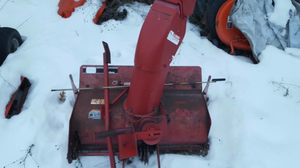

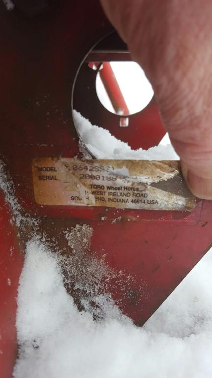

56servi 67 #1 Posted January 5, 2018 Looking at a Wheel Horse Snow Thrower for my 520H tractor. I have a short chute blower on it now. This one looks to be a tall chute, but I can not find any info on the Model number. Looking at the picture I think it reads 0642SS-81. I looked at the "What fits What" book & can't find any number that has "SS"in it. Snow Throwers seem to be "ST" numbers. Would like to know if it would fit my 520H before I drive 200 miles to look at it. It is on the Northern MI CL site. Share this post Link to post Share on other sites
roadapples 6,987 #2 Posted January 5, 2018 Looks to be for a vertical shaft tractor.. 1 Share this post Link to post Share on other sites
squonk 45,595 #3 Posted January 5, 2018 Yep that's for the vertical ones. 1 Share this post Link to post Share on other sites
56servi 67 #4 Posted January 5, 2018 Ok thanks. You saved me a trip. Just got my tractor 3 weeks ago & it seems to work OK. I had a C175 with the single stage tall chute for about 10 years and was very happy with the snow thrower. Sold it about 5 years ago and got a zero turn mower and walk behind snow thrower. After the 2st snow this year I asked myself why I was out walking to clean the drive. Bought the 520h with cab & blower (no deck) and am very glad I did. I liked the tall chute better and am looking for one now at a low price. Not the best time of year for low price but never hurts to look. will a tall chute bolt on my short chute (96-42st01-09662) if I find a parts unit Share this post Link to post Share on other sites
