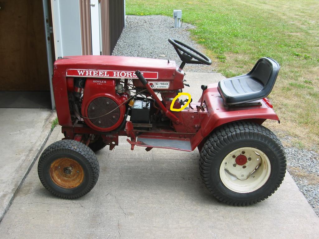

jellyghost 378 #1 Posted January 4, 2018 My snow plow could use lowered about half an inch. Is there an adjustment that will do that? I am using the Tach-o-matic system on a C-101. Share this post Link to post Share on other sites
pfrederi 18,638 #2 Posted January 4, 2018 Are you saying it doesn't touch the ground when you lower it? Unscrewing the circled knob will let the blade go lower. 5 1 1 Share this post Link to post Share on other sites
skrusins 128 #4 Posted January 5, 2018 It could be the lift rod. I think you can adjust with a 9/16 in. wrench. 1 Share this post Link to post Share on other sites
jellyghost 378 #5 Posted January 5, 2018 ok. Honestly, I hadn't ridden in quite a while, and I forgot about the circle knob! I was too excited with hooking up the snow gear. Share this post Link to post Share on other sites
