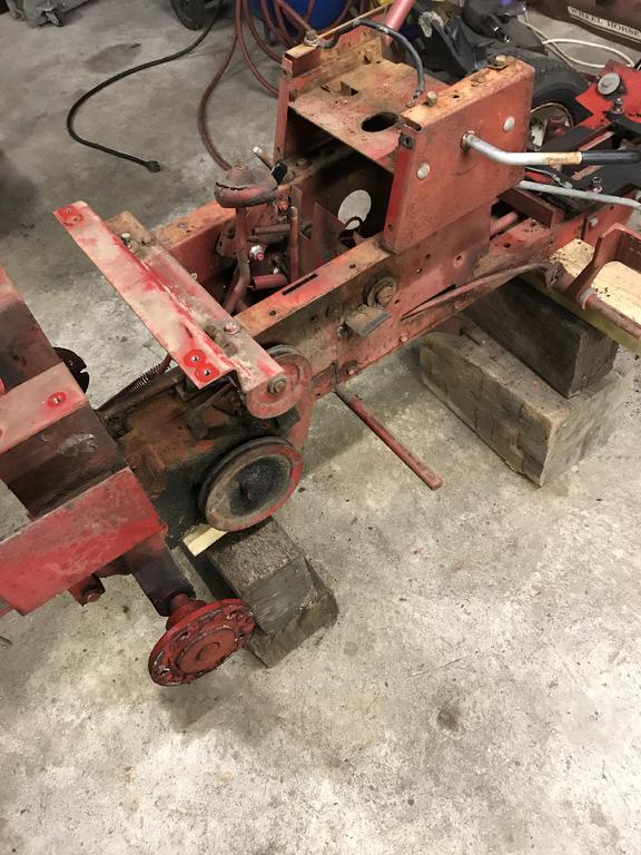

Twister 3 #1 Posted December 29, 2017 (edited) Hey folks, I'm new here. I am currently doing a frame up on my late 70's C-81 Eight Speed. Does anyone know if there are any NOS tillers left in the world? Edited December 29, 2017 by Twister Share this post Link to post Share on other sites

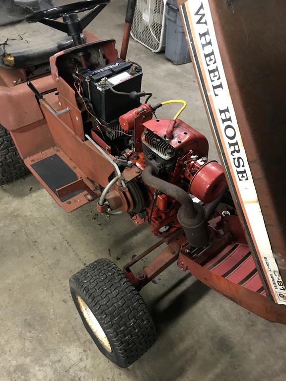

Twister 3 #7 Posted December 30, 2017 (edited) I bought this tractor in 2002, in non-running condition for sixty bucks. It had been sitting outside next to a barn. I wrung out the safety circuit with my ohm meter and found that the seat switch was no good. I put a battery in it, bypassed the safety's, added new gas, and it fired right up. Edited December 30, 2017 by Twister 3 Share this post Link to post Share on other sites
