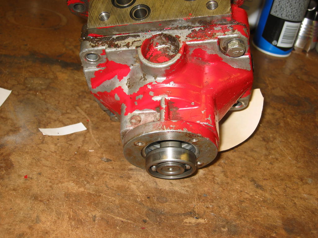

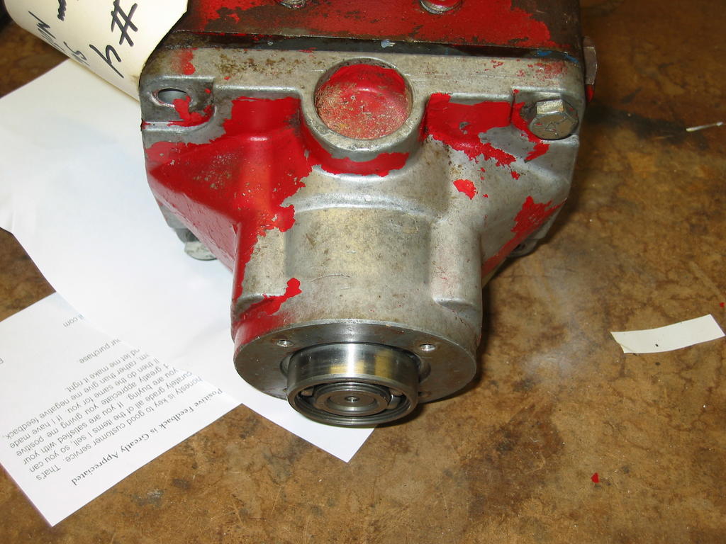

pfrederi 19,941 #3 Posted December 23, 2017 If it is a pistion to piston (not a hydro gear) if you put the hydro motor cover on upside down it will operate backwards. What tractor is this on??? 1 1 Share this post Link to post Share on other sites
mikeeyre74 290 #4 Posted December 23, 2017 Yeah, Pfred nailed it. if you took it apart at all and got this thing upsidedown, it'll do that to you. Four bolts, flip it around, and it'll work correctly again. 2 1 Share this post Link to post Share on other sites

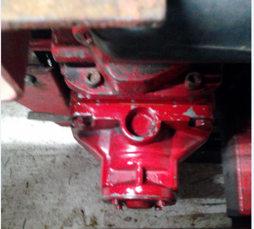

davidtmercer 81 #5 Posted December 23, 2017 Thanks for the replies gentlemen,. I will try turning the motor. I received it from an individual who did not know the history. I had to re-install the pump and currently have it installed on a C-121 and was pleasantly surprised that it moved back and forth with authority but disappointed that it was the opposite of the lever movement (reversing the motor could be a good practical joke if there wasn't any risk of injury, property damage). Will keep you posted. 1 1 Share this post Link to post Share on other sites

pfrederi 19,941 #7 Posted December 23, 2017 The webbed side goes up like mikes picture. The smooth side down 1 1 Share this post Link to post Share on other sites
davidtmercer 81 #8 Posted December 23, 2017 Problem solved. Thanks again for your assistance. After picture shown below. 1 1 Share this post Link to post Share on other sites
