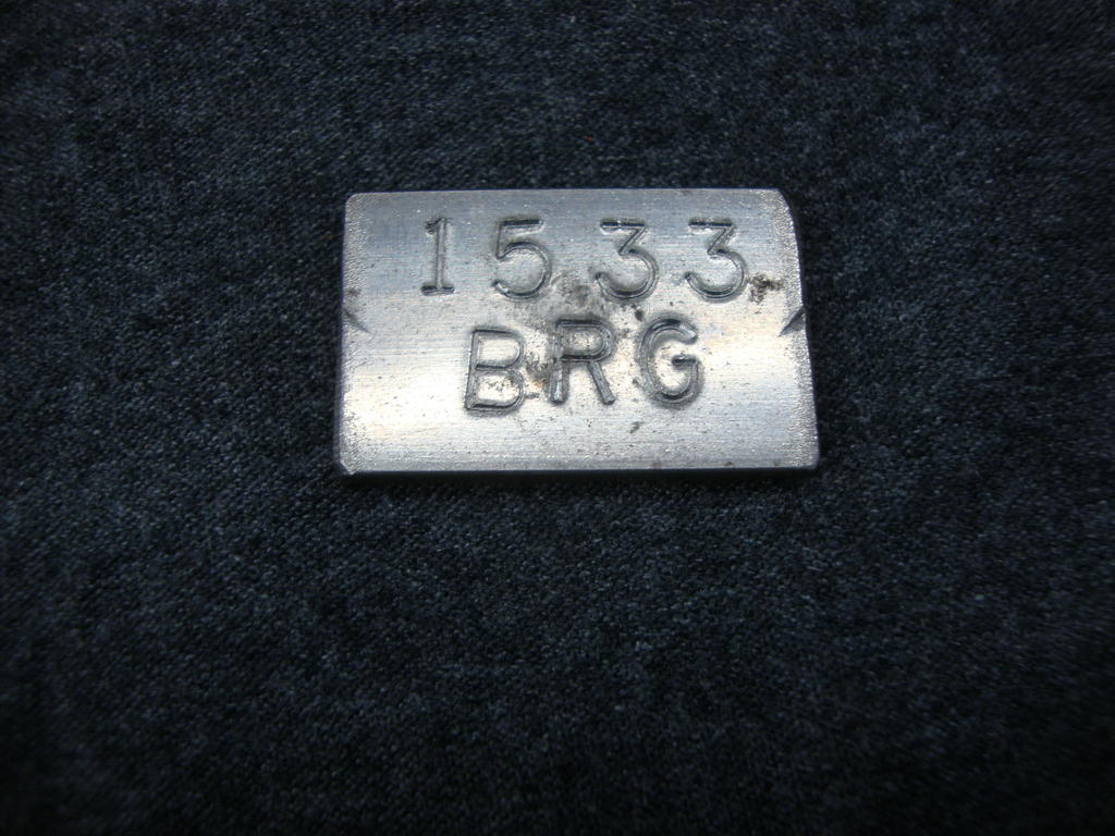

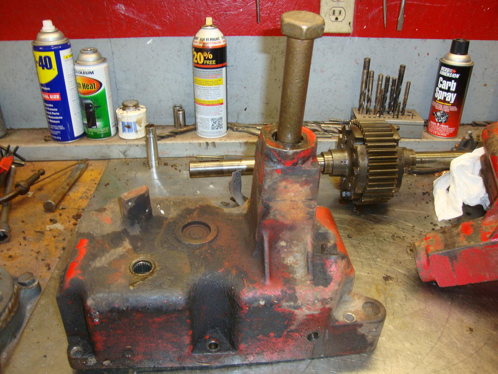

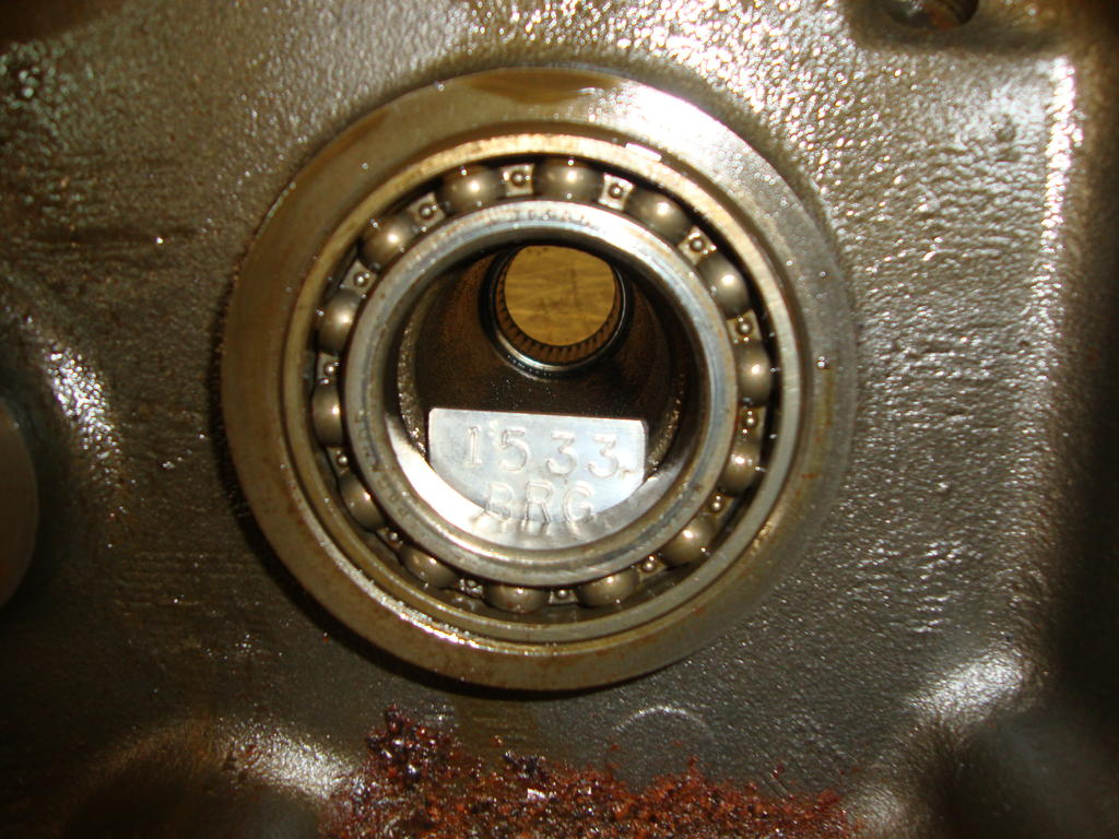

dclarke 4,117 #3 Posted December 17, 2017 (edited) This is what I use. A piece of flat steel, 1/8"x3/4"x1-1/8" and a 10" long punch (brass bolt). Cut the flat steel just long enough to slip thru the inner race of the bearing, place it as pictured and tap it out from the outside. Move the flat from side to side on the bearing as you drive it out. Edited December 17, 2017 by dclarke 6 Share this post Link to post Share on other sites

wheelhorser 7 #5 Posted December 19, 2017 THANKS FOR ALL THE FEEDBACK,USED DENNYS IDEA WITH A PIECE OF SMALL FLAT STEEL UNDER THE LIP HIT IT TWICE WITH LONG BOLT AND HAMMER AND IT FLEW OUT. 3 Share this post Link to post Share on other sites
