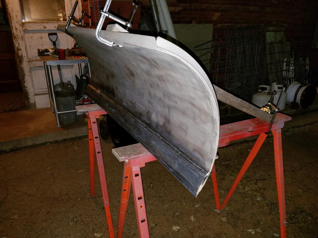

Sarge 3,470 #8 Posted December 15, 2017 One of the best things I've learned is to keep a good sharp cutting edge on your blade . I run loaded tires , weights and such as well as ag's on the front axle - they all help a lot but if those tires can't get to the pavement they can and will side slip . I upgraded the D's 56" blade to a hardened 1055 cutting edge and it scrapes hard enough to damage black top - but that front axle always goes where you point it and there is no added weight to the front of the D . It will easily windrow frozen material off the edge of the streets long after the city plow has done it's work and left a mess - I'm pretty impressed with how well that blade works now , as stock it wasn't very good . Got the iron off the big auction site - pre-beveled 1055HC . Pretty reasonable price for a length of pre-beveled hardened steel . AR400 would be nice , but I can't afford that stuff , lol . Sarge 1 Share this post Link to post Share on other sites
