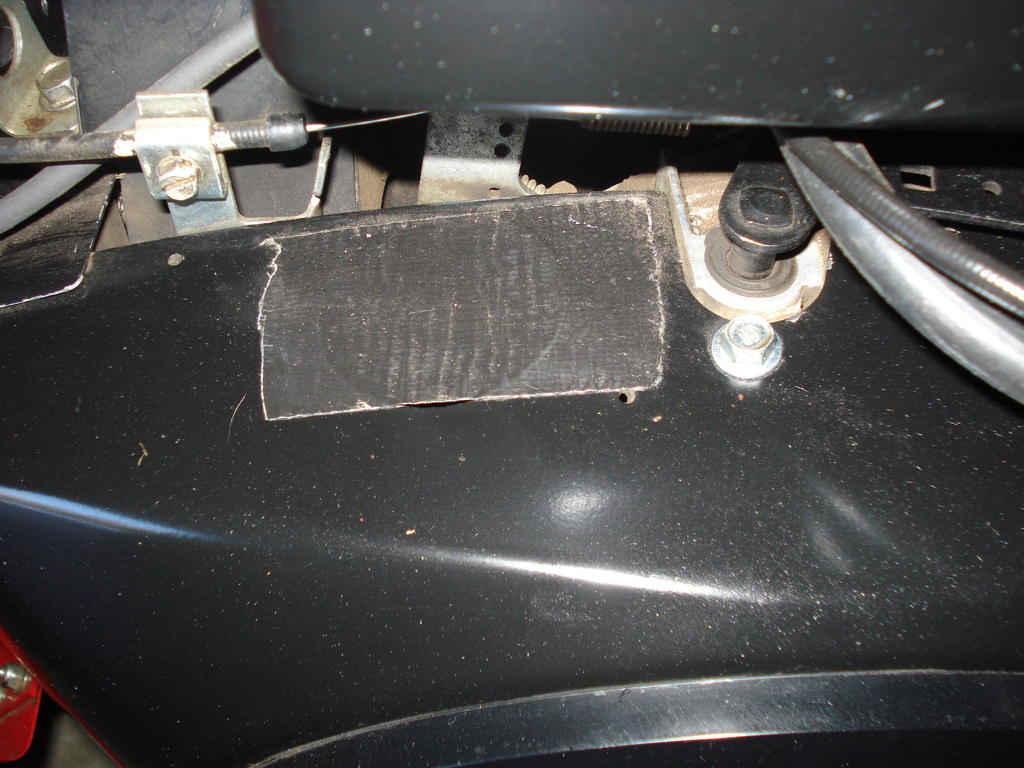

1995 520H+96+97 937 #2 Posted December 14, 2017 I took the tube off, and put duck tape on the flywheel cover hole. Share this post Link to post Share on other sites
ti-jean 45 #3 Posted December 14, 2017 2 hours ago, 1995 520H+96+97 said: I took the tube off, and put duck tape on the flywheel cover hole. Ok but the engin from where he will take is air after you put duck tape on that hole ??? Share this post Link to post Share on other sites
1995 520H+96+97 937 #4 Posted December 15, 2017 (edited) Tape on flywheel cover hole, not air cleaner housing hole. Edited December 15, 2017 by 1995 520H+96+97 1 Share this post Link to post Share on other sites
