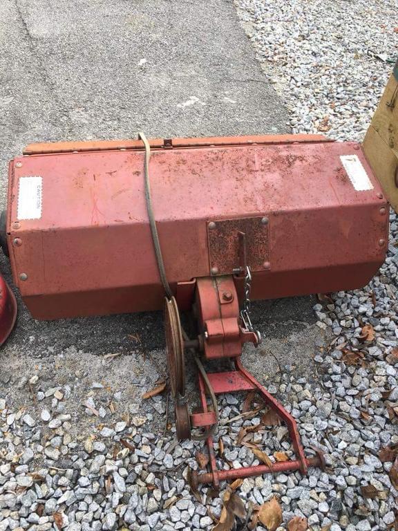

NRondeau94 0 #1 Posted December 11, 2017 I have found a tiller for sale but I am not sure if it will fit my c120. Was wondering if anyone could give me some insite. It for sale a few towns over for $75 Share this post Link to post Share on other sites
Racinbob 12,809 #2 Posted December 11, 2017 Yes, it will fit. This may not be the exact model # but it will show you what all you need that the seller may have. 1 Share this post Link to post Share on other sites

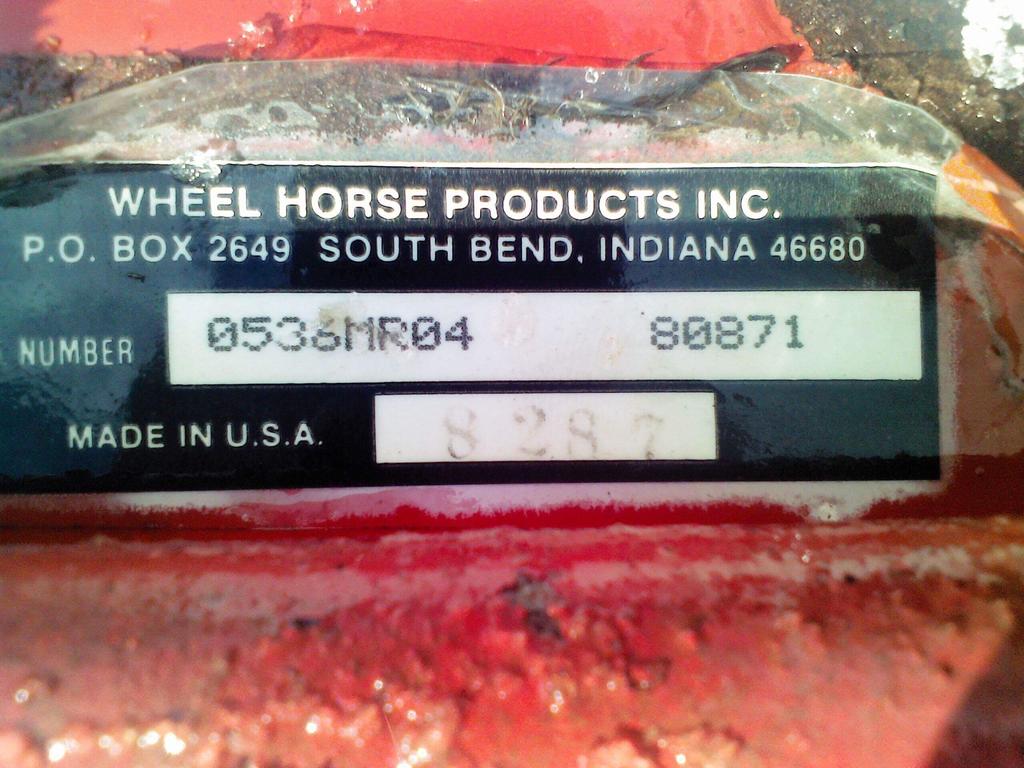

oldredrider 2,553 #3 Posted December 11, 2017 The serial # in the 1st pic is for a 36" mower deck....not a tiller. Share this post Link to post Share on other sites
