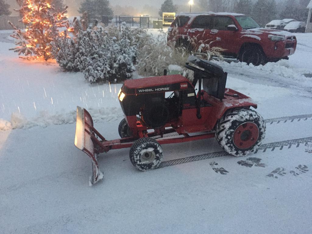

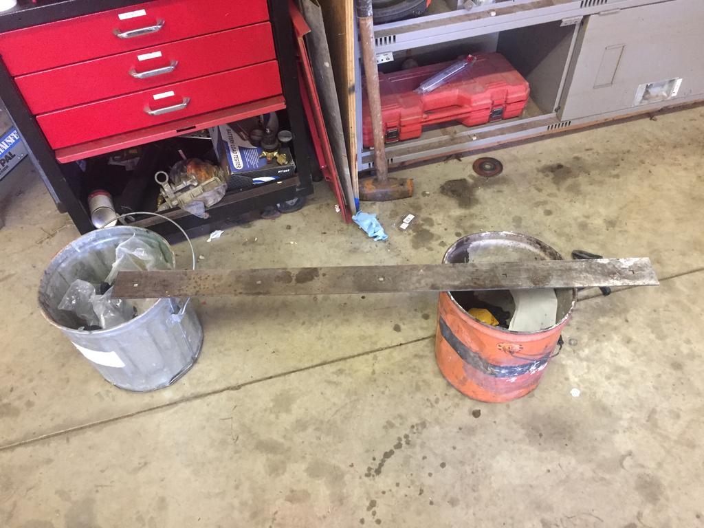

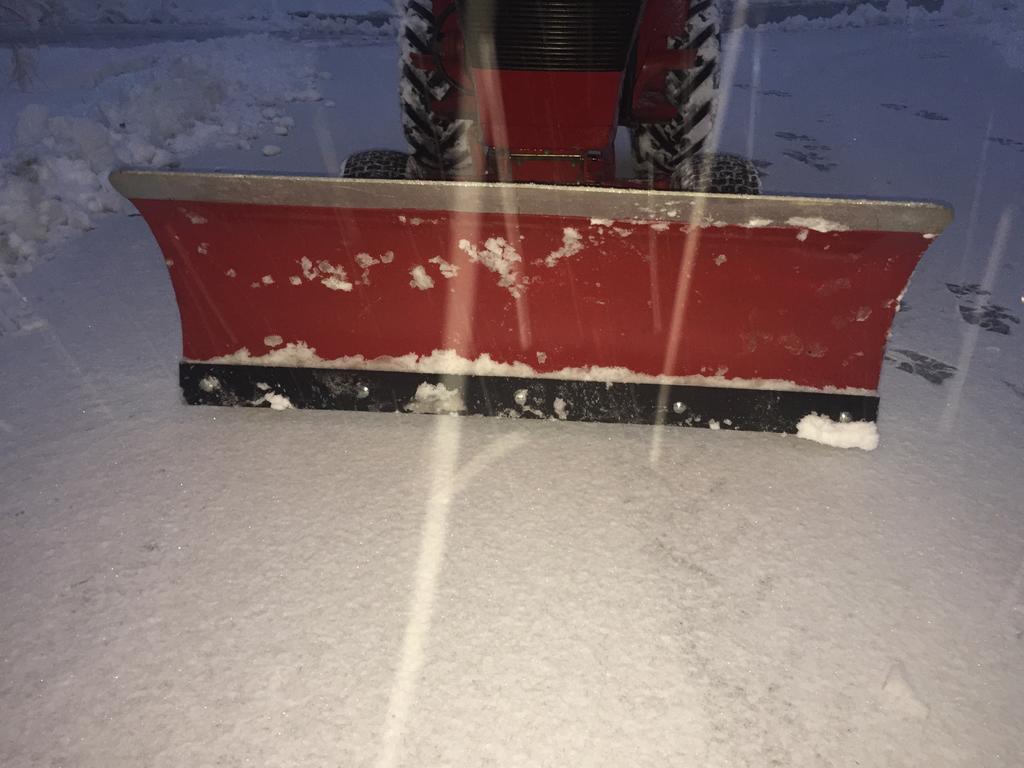

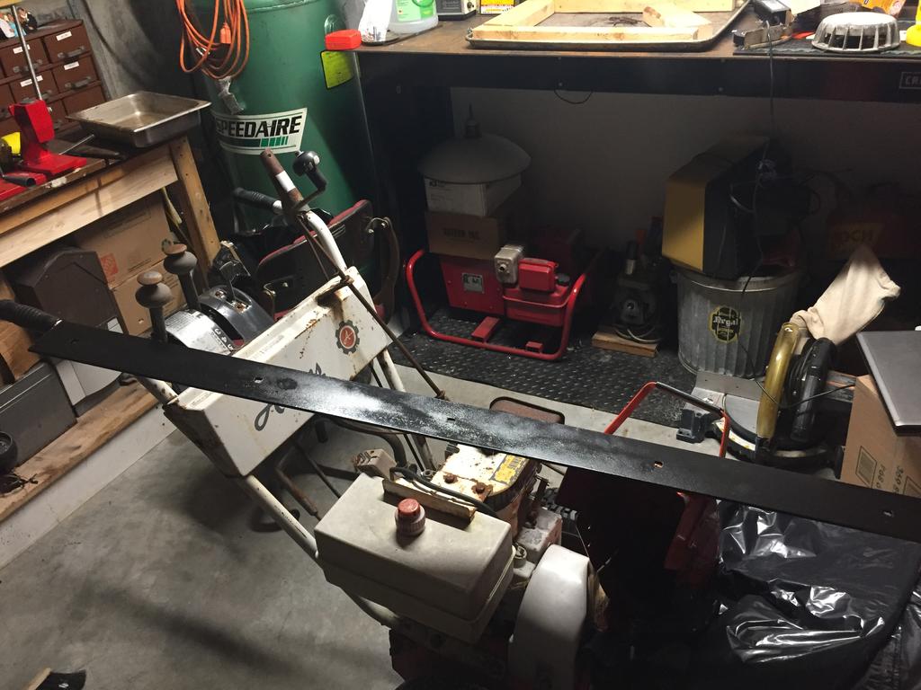

Red144runner 658 #1 Posted December 9, 2017 My 48" blade is in good shape, but last winter I know the cutting edge was worn out and the paint was faded a bit. First I gave it a wire brushing and light sanding. Primed some bare spots and brushed on some regal red. The cutting edge was a little mre work. I had some leftover 3"x3/16" from my frame repair last winter. I cut it down to 48" then drilled out 5 3/8" holes for my new carrige bolts. The time consuming part was filing the holes square. Finally primed it and three coats of gloss black. Tried it tonight and what a difference 5 3 Share this post Link to post Share on other sites
WHX?? 52,860 #2 Posted December 10, 2017 Couple of minor adjustments there Red in that third pic and we're talkin a calendar shot! 1 1 Share this post Link to post Share on other sites
