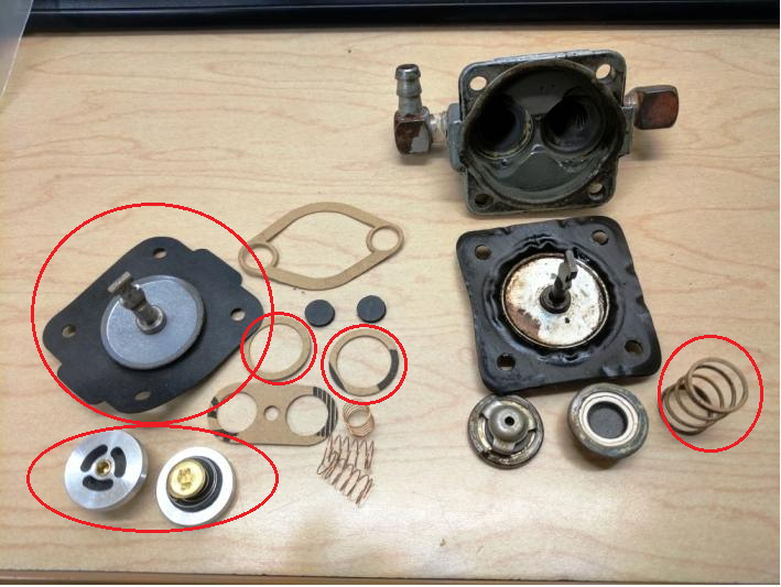

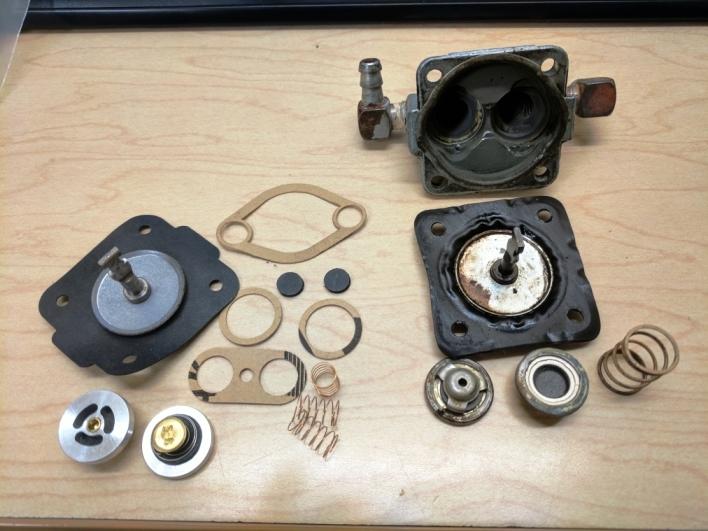

Rustyred 63 #1 Posted December 9, 2017 Hi guys. Last week I got great input about rebuilding an original fuel pump on my Kohler K181. I was directed to a supplier who sent me what I thought to be the correct kit to do the job. However, it includes parts that the original didn't have! Additional springs, gaskets, little black rubber pieces. The two little valves also look different although they are the same diameter... One of you must be able to look at my picture and explain. I want to put it together this weekend if I can. With many thanks, Rustyred Share this post Link to post Share on other sites
Anglo Traction 761 #2 Posted December 9, 2017 Parts supplied are for 2 versions of pump. You wlll only need the items circled in your image copy to fit back into the main body. Plus the Gasket to fit the Pump of course. 5 Share this post Link to post Share on other sites

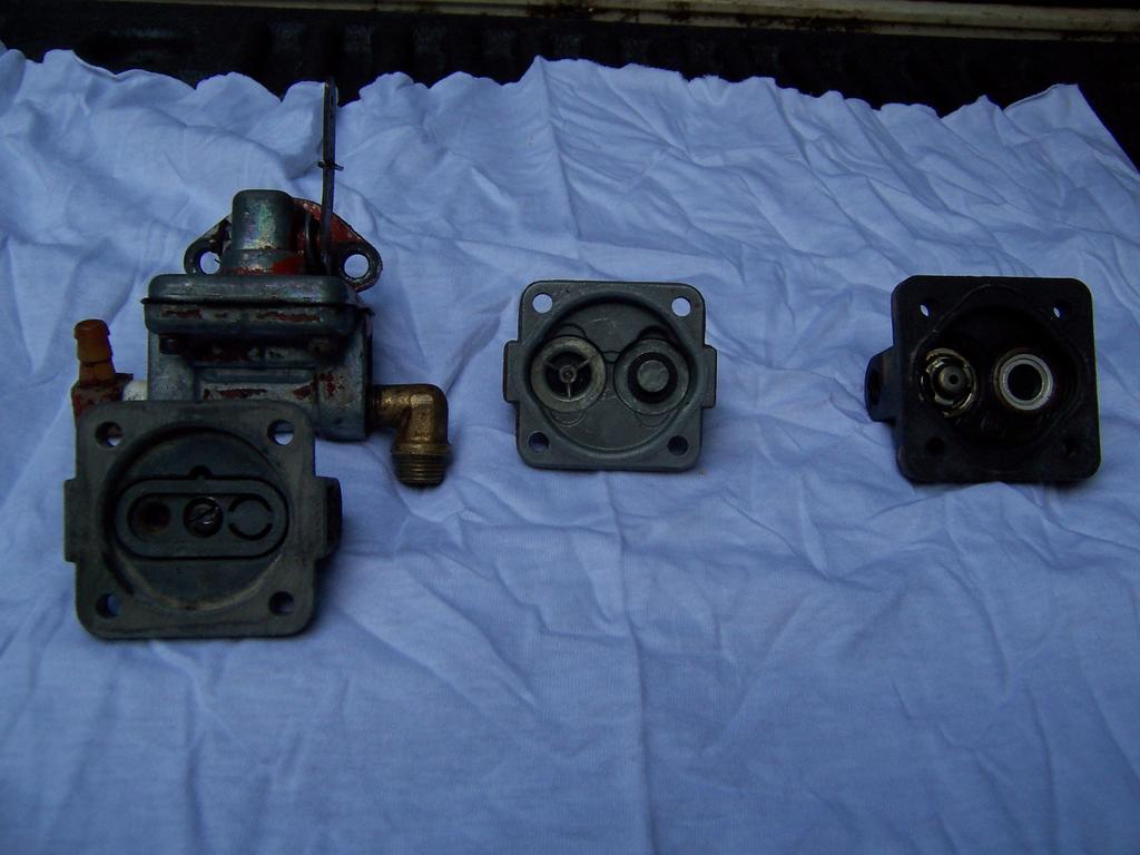

953 nut 63,918 #3 Posted December 10, 2017 That is a universal kit. The remaining parts would fit an older type pump like the one on the left. 3 Share this post Link to post Share on other sites
Rustyred 63 #4 Posted December 10, 2017 Thanks gentlemen. Thank you for taking the time for these responses. They were very educational. 1 1 Share this post Link to post Share on other sites
