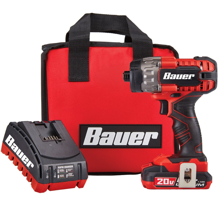

squonk 45,366 #7 Posted December 7, 2017 I would have tried one of these hand impact tools with a 3/8 socket. But it sounds like they would have broken anyway. 3 1 Share this post Link to post Share on other sites
KC9KAS 4,746 #8 Posted December 7, 2017 1 hour ago, squonk said: I would have tried one of these hand impact tools with a 3/8 socket. But it sounds like they would have broken anyway. This is what I was going to suggest! I have one that I used back in the early 70's on my 1967 Honda 305 Dream!. Wish I still had that motorcycle! 2 Share this post Link to post Share on other sites

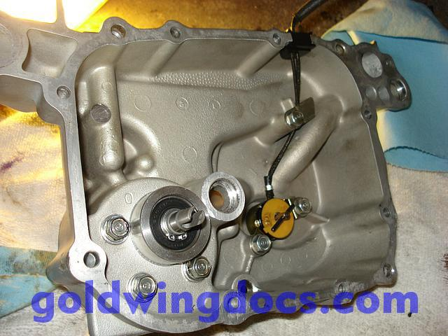

ohiofarmer 3,383 #11 Posted December 8, 2017 (edited) 11 hours ago, pfrederi said: Thanks guys...patience was never my middle name. Final score two broken off two came out. Tapping on a wrench with a hammer worked in two, Broke the third. As i suspected the plastic fan made an effective seal. the two that came out were bone dry in-spite of 18 hours of soaking.... "patience is not my middle name" Well, maybe it should be.... Ok, so if this is the bolt you have to take out, then you are saying that the flange head seals against the plastic. Just take a tiny drill bit maybe about the size of the little red straw on your penetrating oil and drill a hole off center so it comes through the head about where the threads are on the outside of the tapped hole in the cast iron. i would bet that you will feel it when the bit breaks through the flange and bites through the plastic. That is where you stop drilling and now your penetrant will get at those threads https://www.oreillyauto.com/detail/freeze-off-3327/chemicals---fluids-16461/grease---lube-16582/penetrating---fogging-oil-19005/super-penetrant/05002/4176059/2004/pontiac/grand-prix#availabilityTab_ I like this stuff ^^^ the best for loosening different metals joined together. It sure works well for steel screws in aluminum motorcycle blocks. i just succeded in taking out some Plillips screws 2" long that thread into the block of a motorcycle. Anyway, once you have that hole drilled, put that little red hose thingy in the hole you drilled and squirt a dab in there. Wait a day. Re-apply once a day or twice a day. Wait. You can also put a socket on the bolt and hit it square on the end each time you apply the Freeze-Off. wait another day. Do this for a WEEK. Finding a flat center punch and whacking on the end of the bolt will also help the penetrant go deeper into the threads. This little impact gun would have plenty of power to loosen your bolt at 1300 inch pounds. The impact action is like magic on stubborn fasteners. 1300 inch pounds might even be enough to twist off the bolt, so just give it a little burst or don't pull the trigger all the way to limit the power. My impact gun is only 500 inch pounds or so, and it is perfect for a quarter inch bolt . Just keep at this and be calm and patient and finally the bolt will loosen up. I once got a kid started on repairing old motorcycles and he took my advice about applying the Freeze-off. i went down to his shop a week later and smacked the case screws a lick on the ends, and even the ones with half buggered heads came right out. Now when he buys an old barn find, as a matter of course, be gets out the freeze-off and hits every fastener he can get to with a dab of the stuff and occasionally does them again Here is the beast that I got removed yesterday using these methods. Not one screw could be gotten at squarely, but they all came out.Just look at how deep the penetrant had to crawl down those screw threads. Edited December 8, 2017 by ohiofarmer 1 Share this post Link to post Share on other sites
