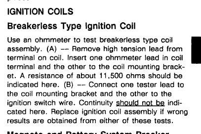

pfrederi 19,447 #2 Posted December 7, 2017 (edited) Based on the spec number if nothing has been changed you have the breaker-less ignition system. The Coil is a triangular shaped device mounted on the front of the blower housing. They are NLA. You should try a wanted add in the classifies section here. Also check ebay. Before you buy one are you sure it is your coil and not the trigger?? Here is a pic of teh coil and the way to test it (or anyone you may buy) You can download the Kohler Service manual that gives complete info on teh system here Edited December 7, 2017 by pfrederi Share this post Link to post Share on other sites
