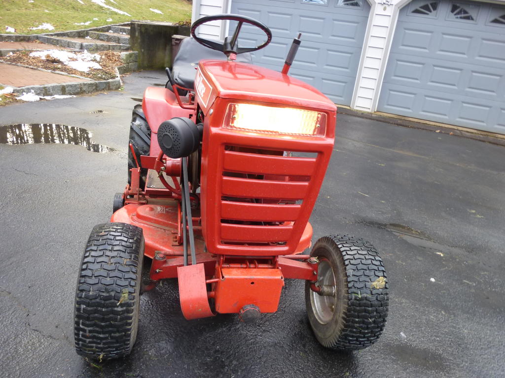

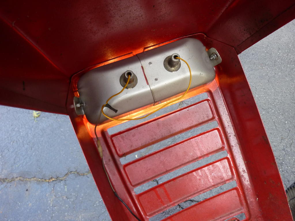

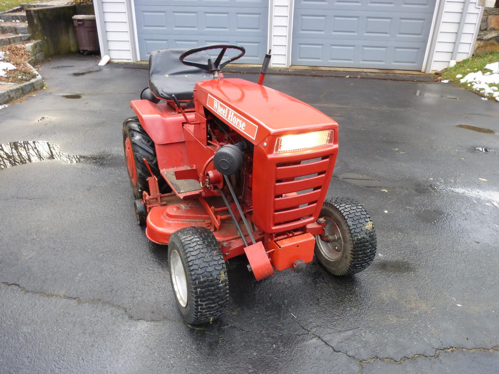

Rob R 981 #2 Posted December 3, 2017 (edited) I did my C-81 with a pair of headlights for a common Sears Garden Tractor and it work out great.....! Even used the plastic lens (2 pieces) for the front lens.... cost me zero..... Edited December 3, 2017 by Rob R 8 Share this post Link to post Share on other sites
