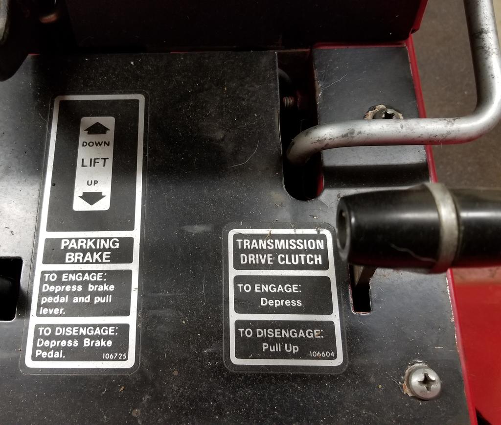

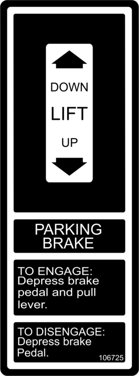

Vinylguy 4,691 #1 Posted December 2, 2017 Calling all Black Hood experts. Trying to find out which blackhood models used this brake and lift combo decal? Was it just hydros? Share this post Link to post Share on other sites
rmaynard 16,254 #2 Posted December 2, 2017 According to the part number at the bottom of the decal (106725), that decal is used on both the automatic and 8-speed models. Share this post Link to post Share on other sites
Vinylguy 4,691 #3 Posted December 3, 2017 2 hours ago, rmaynard said: According to the part number at the bottom of the decal (106725), that decal is used on both the automatic and 8-speed models. Thats what I found also Bob but now I have found this image of a c-175 hydro with hydraulic lift. looks like the hydraulic lift is the key here? Now to find more images. Share this post Link to post Share on other sites

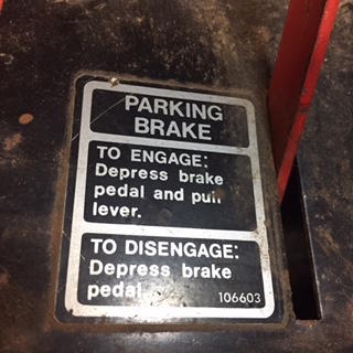

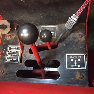

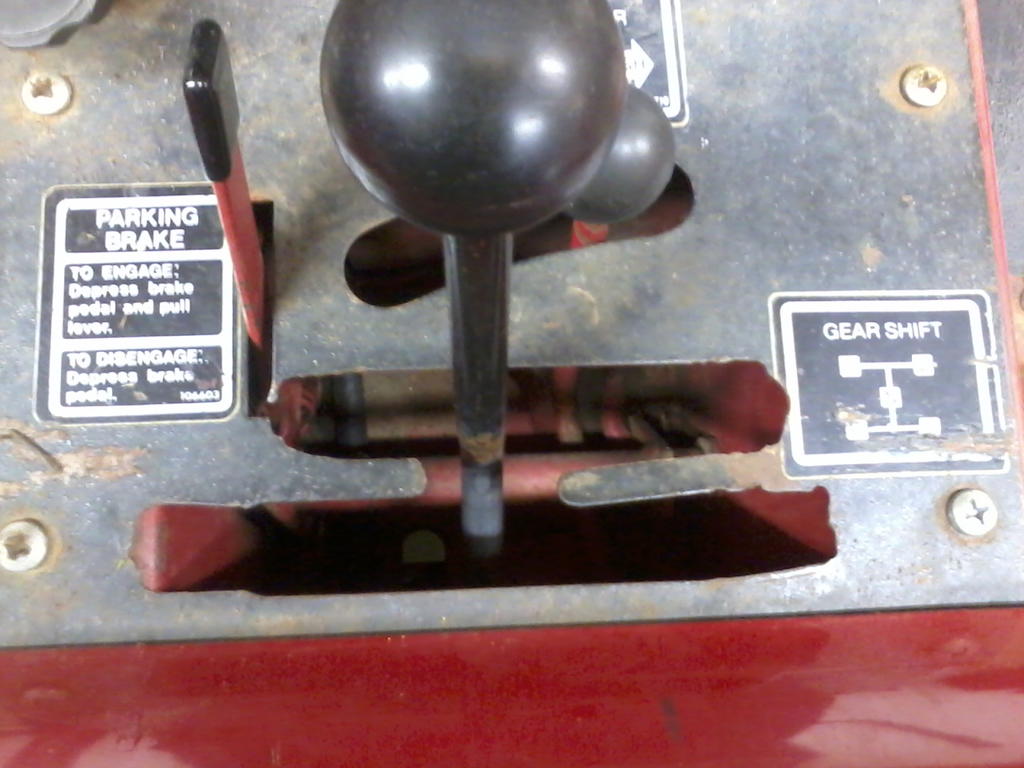

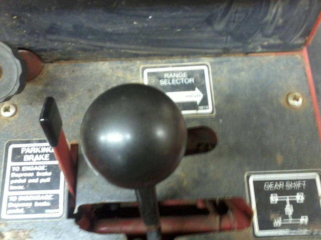

jay bee 913 #6 Posted December 3, 2017 (edited) Terry, here are a couple pictures of my son's 1980 C-125 8-Speed with manual lift. The part number on the Parking Brake decal is 106603, the part number on the Range Selector decal is 108710 and I can't make out the number on the Gear Shift decal. Also, thank you for the decals for my '83 C-145 Automatic. They look great and were very easy to install. Thanks again for what you do. Edited December 3, 2017 by jay bee Added copy 1 Share this post Link to post Share on other sites
Vinylguy 4,691 #7 Posted December 3, 2017 Thanks Jay Glad your satisfied with the decals. Can't seem to find any 8 speeds wit hydraulic. Also wondering if the c-125 autos had manua l lifts? The c-145 165 and 175 autos all had hydraulic lifts. The c-195 autos used a three point hitch so they have a different li ft decal. 1 Share this post Link to post Share on other sites

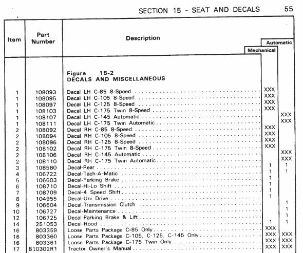

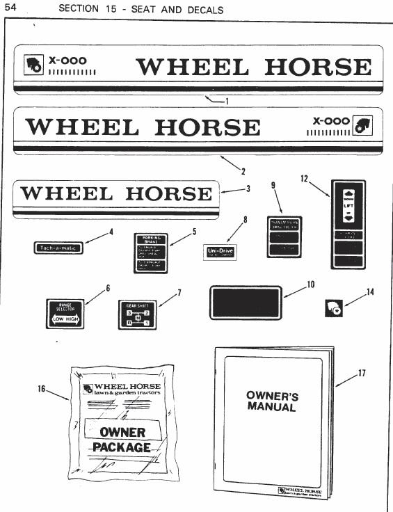

gwest_ca-(File Mod) 11,408 #8 Posted December 3, 2017 Here is the decal parts list from an original 1983 parts manual. One column for the gear models and the other for hydro's. Garry 3 1 Share this post Link to post Share on other sites

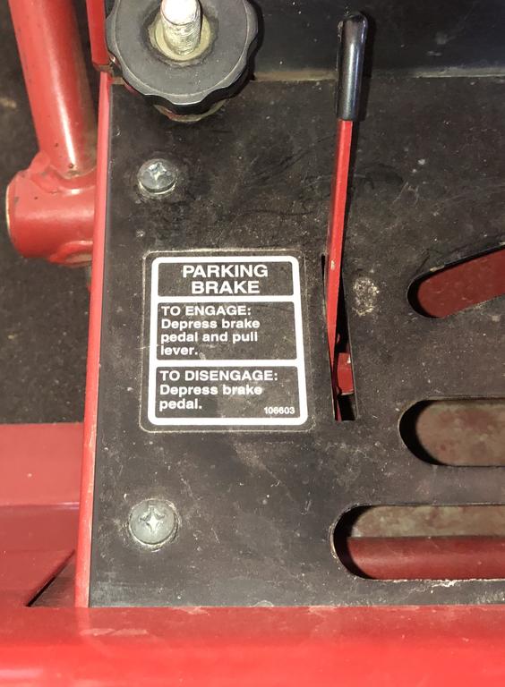

SylvanLakeWH 28,178 #9 Posted December 3, 2017 Here's what my 1982 C-105 8 speed has... 1 Share this post Link to post Share on other sites

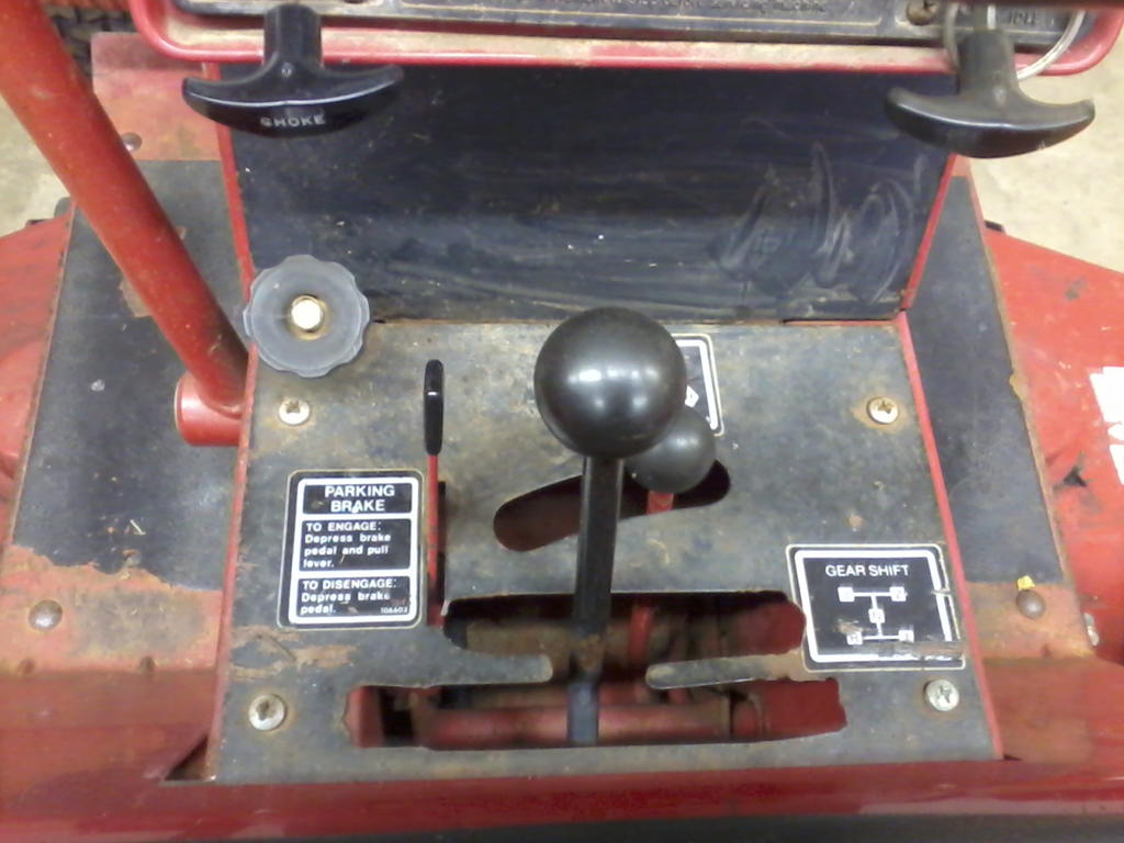

cschannuth 3,817 #10 Posted December 3, 2017 From my ‘78 C-161 with the Briggs and an 8 speed. 1 Share this post Link to post Share on other sites
gwest_ca-(File Mod) 11,408 #11 Posted December 3, 2017 The C-125 Auto models were produced in 1980 and 1981 only. The online parts manuals show the same 106725 decal. The gear transmission models don't have a hydraulic pump so no hydraulic lift. Many had an electric lift as an option. Garry 3 Share this post Link to post Share on other sites
Vinylguy 4,691 #12 Posted December 3, 2017 5 hours ago, gwest_ca said: Here is the decal parts list from an original 1983 parts manual. One column for the gear models and the other for hydro's. Garry That explains it. Thank you all so much. Now to get all those tractor kits updated and relisted. This will help a ton and simplify things for Lola's packaging. Thanks again for the pics and info. Terry 3 Share this post Link to post Share on other sites

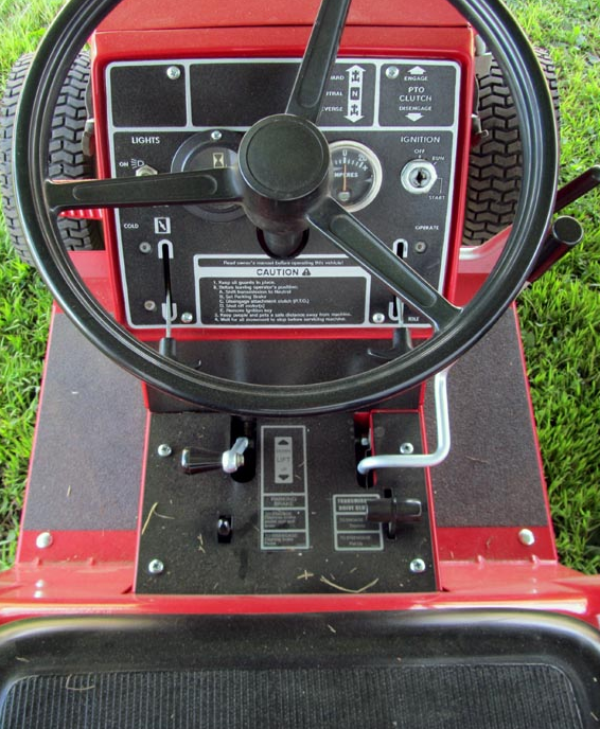

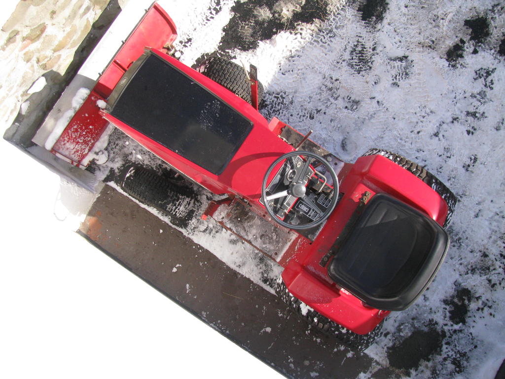

JERSEYHAWG / Glenn 4,498 #16 Posted December 6, 2017 Here's my 1988 Blackhood picture. Glenn 1 Share this post Link to post Share on other sites
Vinylguy 4,691 #17 Posted December 7, 2017 3 hours ago, JERSEYHAWG / Glenn said: Here's my 1988 Blackhood picture. Glenn Is this a 145 Glenn? Share this post Link to post Share on other sites
JERSEYHAWG / Glenn 4,498 #18 Posted December 7, 2017 (edited) 2 hours ago, Vinylguy said: Is this a 145 Glenn? Terry, no, this is from my C-175. 1983. If I can help in anyway just ask. I made a mistake of the year in my original post, sorry, its a , 1983 C-175 , hydro, kohler twin. Glenn Edited December 7, 2017 by JERSEYHAWG / Glenn Share this post Link to post Share on other sites
