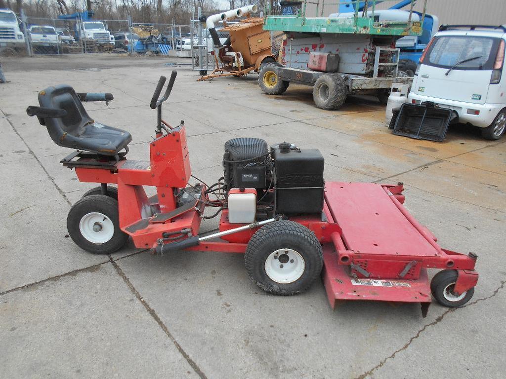

slim67 2,822 #7 Posted November 29, 2017 10 hours ago, Sarge said: Good deal - be careful with that engine and treat it well , rebuild parts are getting NLA real fast . Those flat twin K series iron engines are some of the best Kohler ever made , period . It's nice to have that massive torque and an oil pump to boot - probably a good idea to check the oil pressure at one of the many 1/8-27NPT plugs located in the block , should be around 50psi if it's in good shape . If I run across any used K series flat twins - I'm grabbing every one of them as they were used in a lot of industrial equipment and have a well proven track record of reliability . Sarge Is that the Magnum you're referring to? If so, my previous employer had three Gravely Promasters like the one pictured with Magnums that ran and ran, Smooth and powerful, 1 Share this post Link to post Share on other sites
Sarge 3,470 #8 Posted November 29, 2017 No , not the magnum - the K series flat twins are different . If you have a D180 it should have a K482 in it , unless someone has swapped it out for a later style engine . Sarge 1 Share this post Link to post Share on other sites
slim67 2,822 #9 Posted November 29, 2017 50 minutes ago, Sarge said: No , not the magnum - the K series flat twins are different . If you have a D180 it should have a K482 in it , unless someone has swapped it out for a later style engine . Sarge I just googled that engine and see it was put in some heavy duty tractors like Bolens along with the tractors your discussing. I don't recall ever seeing one in person. I will have to keep an eye out at the next tractor show! Share this post Link to post Share on other sites
