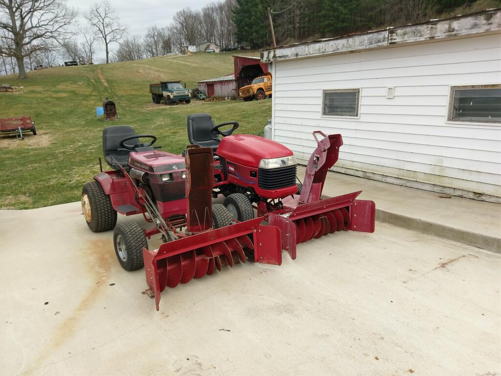

WVHillbilly520H 10,379 #53 Posted December 31, 2020 2 hours ago, Diesel_Brad said: I'm just jumping on this thread. I bought a used 48" blower for my tractor last year. I'm just tinkering with it now. Chain appears to be seized. It was missing the "yoke" that goes into the Lift rod. I just got it today. I'm going to work on getting that chain changed out and see if I can get it on the tractor and see if it will chew up a couple left over piles 48"? There are 2(3) sizes of WH/TORO snow throwers/blowers 1) the 36" single stage with side extensions goes to 42" (thrower) and then 2) the 44" 2 stage (blower), WH offered a "Berco" 38" 2stage before the TORO 44" came out. Also if not mentioned before the "xi series" version of the 2 stage blower, if I'm not mistaken is belt driven to the main pulley on the impeller therefore NO chain drive like that on the classic series with jackshaft gearboxes because of the side PTO which would eliminate that as a possible cause of noises/vibrations. Share this post Link to post Share on other sites

WVHillbilly520H 10,379 #57 Posted January 1, 2021 (edited) 32 minutes ago, Diesel_Brad said: The thread title is "Noisy 5xi Two Stage Blower" Sir, the 2stage blower is 44" wide not 48" same as the classic except for final drive and and tractor attachment points. Edited January 1, 2021 by WVHillbilly520H Share this post Link to post Share on other sites
