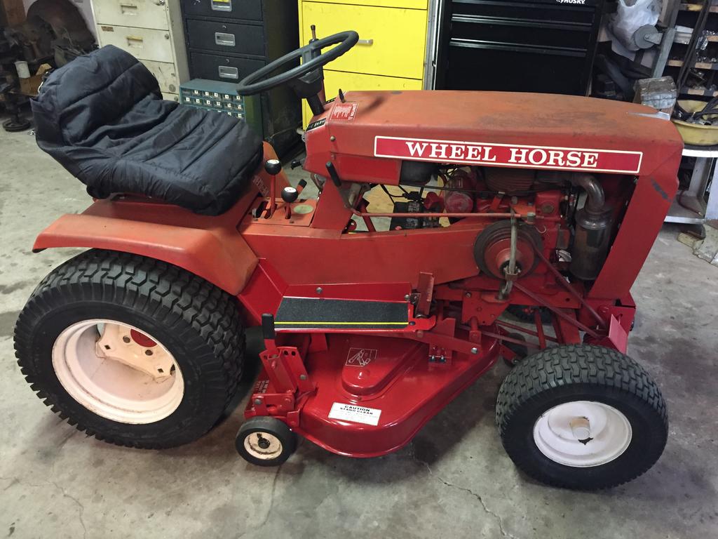

Michael Thompson 39 #1 Posted November 24, 2017 Hi guys, total rookie question here but I'm curious as to what the differences are between say a C100 or a C120 or C160 besides the engine and the decals? This of course is assuming we are comparing 8 spd transmission versions. I have a beautiful C100 that I love and have no plans on changing but should the Kohler tire I might be open to a torque upgrade. This C100 is the first K series Kohler I've ever owned and I really like them. If I ever have the chance I plan on picking up another K series or to just to tinker with. Wouldnt be a a terrible thing to have a freshened 12,14 or 16 on the shelf should the need arise. Thanks guys and Happy Thanksgiving! 9 1 Share this post Link to post Share on other sites

dells68 7,499 #4 Posted November 24, 2017 Hey Michael, gotta say, that's one very nice looking machine!!!!! 2 1 Share this post Link to post Share on other sites
