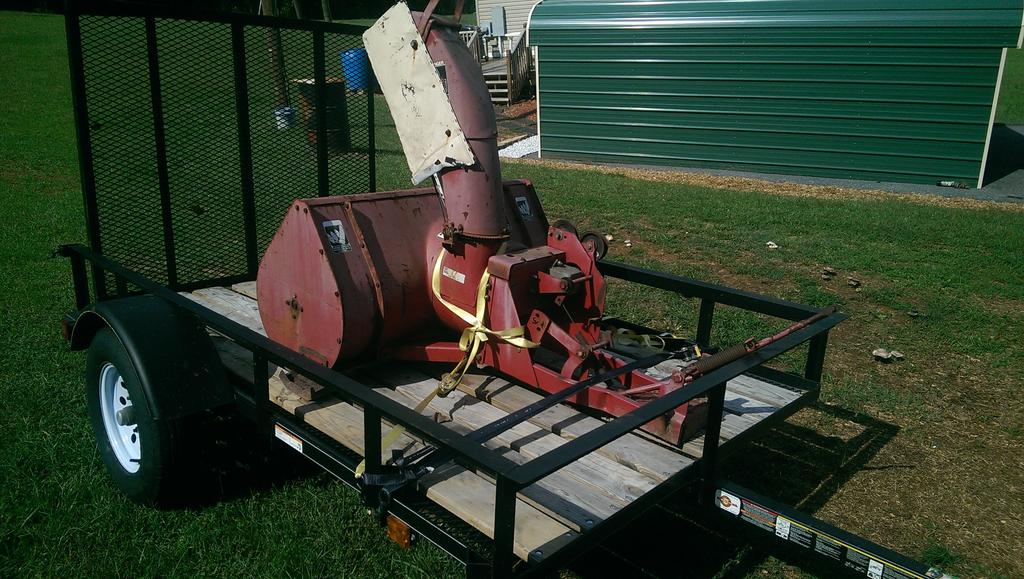

WVHillbilly520H 10,377 #3 Posted November 18, 2017 It'll fit but will you have enough power to run it, it was made for the 520H twin cylinder Onan, PO I bought mine from had it on a 314 then a 315 so there's something to think about too, Jeff. Share this post Link to post Share on other sites
formariz 12,352 #4 Posted November 18, 2017 Thank you. Found one looking almost brand new and I am contemplating getting it. I am not sure what they go for but this one certainly is not cheap. The C-125 will eventually get a NOS 16HP Magnum, hopefully that will be enough. Share this post Link to post Share on other sites
WVHillbilly520H 10,377 #5 Posted November 18, 2017 I picked mine up for $200 but had to rebuild/repair it to look new, and new they were $1200+, also make sure you get ALL the hardware (frame bracket with belt guard/sway bar mount and sway bar and lift linkages, Jeff. Share this post Link to post Share on other sites

WVHillbilly520H 10,377 #11 Posted November 21, 2017 Like I said above $1200+ when new, if in like new condition and you are willing then $800 with ALL the necessary linkage maybe not to bad, the big things to look for are the auger BUSHINGS they wear out non serviceable (replace only) and the factory wooden chain tension block now Toro replacement is nylon, the impeller to auger gear box seals shrink and leak requiring to keep a watch on fluid level, myself and others have upgraded the bushings to greasable cam lock bearings, and idler sprocket vs tension block, and a cab is almost a requirement when running a blower so you don't wear as much as you chuck, 1 final thought I had a tall chute single and it threw nearly a far but always clogged on D.O.T. plow banks at the end of the driveway but 2stage just keeps on chucking, Jeff. Share this post Link to post Share on other sites

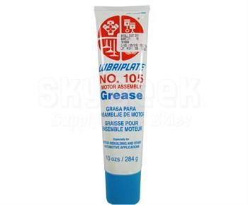

wallfish 18,791 #12 Posted November 21, 2017 50 minutes ago, WVHillbilly520H said: the impeller to auger gear box seals shrink and leak requiring to keep a watch on fluid level I filled mine to the brim with Lubriplate 105 engine assembly grease. Because I had a couple tubes around for rebuilding little O&R engines. It stays in place much longer because it stiffens up in the cold but quickly liquefies once the gears start turning. Haven't had any issue in the gearbox at all and it's been in there 4 years. Share this post Link to post Share on other sites
