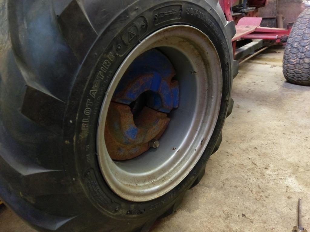

"Manic-Mechanic" 1,485 #28 Posted November 24, 2017 (edited) Alright, this is how they are starting to look. The anchor bolts are in with nuts & washers, but not too terribly tight, give a little here an there. The weights (should) slide right on and place pieces of rubber (bicycle tube) at contact points. Edited November 24, 2017 by Oldman 2 Share this post Link to post Share on other sites
Sarge 3,473 #29 Posted November 24, 2017 If those center holes are large enough to get to the hub's lugs - you could mount the weight to the tire and then install the whole assembly - that's how I've done mine on the D with the 12" WH weights and wheels . I almost always stud the hubs with the heavy duty 7/16" fine thread machinery bolts from the rear and use loc-tite to seal them in tightly . That acts as a stud , then lug nuts can be used which makes it much easier to mount the wheels when needed . I hate fighting those lug bolts when there isn't much of a center hub to steady the wheel but the D does have a thicker raised center than others . Sarge 1 Share this post Link to post Share on other sites
"Manic-Mechanic" 1,485 #30 Posted November 24, 2017 The hole isn't quite large enough. I had given that some consideration, however, I align the height of the hub to that of the wheel, and it is fairly easy to bolt on that way. I did install the carriage bolts with some minor movement to accommodate the weights bolt pattern. Once the carriage bolts are tightened that shouldn't make a difference.......I (hope) to be able and slide the weight forward enough to spin a nut two threads and then place rubber before the weight on the contact points. It is a theory, but I'm sure it'll work. Share this post Link to post Share on other sites
Sarge 3,473 #31 Posted November 24, 2017 I just use rubber cement to hold the pads in place - works good and easier to position the weight without losing a digit or two...lol . Wrestling those weights while vertical can be a challenge for sure , but the traction is totally worth the effort . Sarge 1 Share this post Link to post Share on other sites
"Manic-Mechanic" 1,485 #32 Posted November 24, 2017 (edited) I have the pads in place, letting them set. I took a rough picture of the plow,(Back is tight) or I'd put in on. Edited November 24, 2017 by Oldman Share this post Link to post Share on other sites
"Manic-Mechanic" 1,485 #33 Posted November 24, 2017 The finished product. 2 Share this post Link to post Share on other sites
Sarge 3,473 #34 Posted November 25, 2017 That looks absolutely perfect - they sure fit those rims just right and finish the look nicely . It should make a difference in how the tractor feels - should be a lot more "planted" with the weights . Just be careful on starting and stopping , no quick movements on the direction control as it can put some serious pressure spikes in the hydraulic system - which always go right back to that vulnerable engine coupling . Finally got mine back together yesterday and took it for a short test spin - nice to be in the seat of that big D again . Sarge 2 Share this post Link to post Share on other sites
