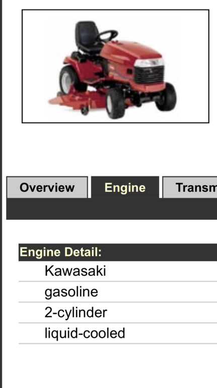

Al C. 1,429 #1 Posted November 17, 2017 I’m thinking about picking up a 520LXI that looks to be well cared for and in good condition. It has a 60” deck and 48” blade. I’m curious, does anyone have experience with the Kawasaki 20hp twin liquid cooled engine? I’m comfortable mataining old Koehler 241’s and 341’s. Will I have any problems handling this Kawasaki engine? Share this post Link to post Share on other sites

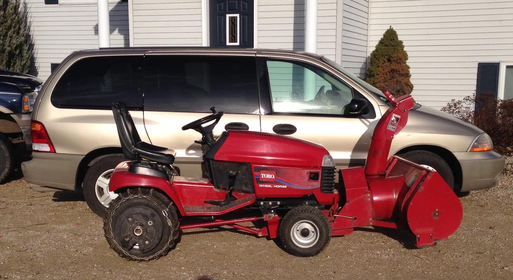

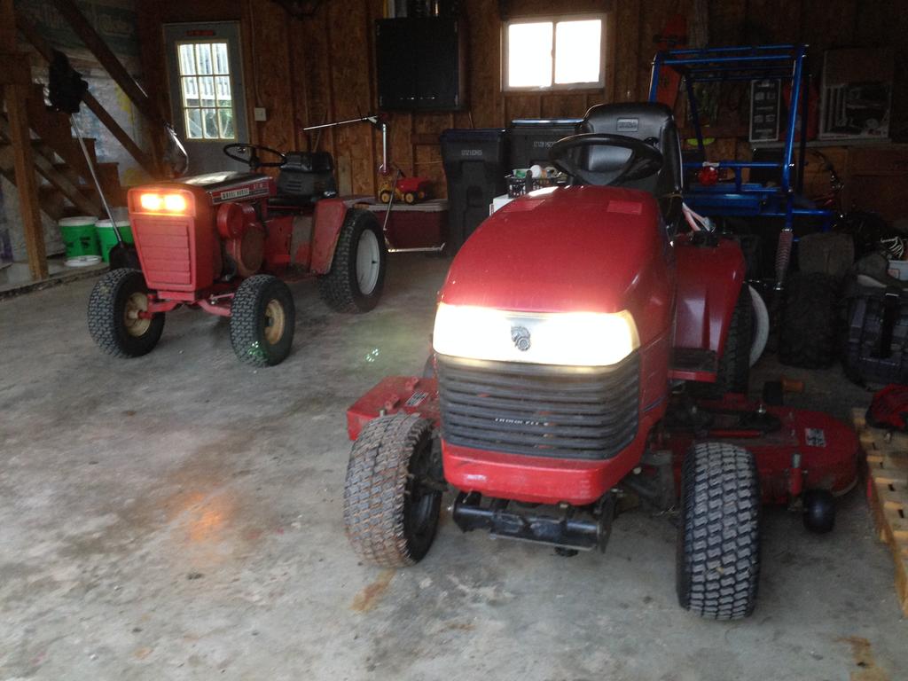

PeacemakerJack 10,863 #10 Posted November 23, 2017 I’ve never owned the Lxi but my buddy has a Cub Cadet 3205 with the FD620D Kawasaki engine in it! What an engine! Smooth and quiet yet powerful. People make a big deal about the plastic cam gears because that is about the only thing that one can point to as a failure point. You would definitely want to upgrade to the metal gears if that hasn’t been done. However, make sure you research the years that Kawi put the plastic ones in because it may not even be applicable with the tractor that you are looking at based on build date. On 11/17/2017 at 7:03 AM, Skipper said: You do know that machine also comes in a diesel version right My wife’s tractor “RED” is a 523D. It is the coolest work tractor that I’ve ever owned in spite of the nearly 1200 hours on the clock... They are big tractors as you can see compared to my minivan so I wouldnt recommend one for a small tight yard. The deuce will handle deep snow with ease! All in all a great working tractor... I personally think that the xi series tractors are one of the most underrated (invisible to the public) GT’s ever built. After two years of ownership, I wouldn’t trade mine for anything! plus—Momma would kill me! she loves her Diesel! 5 Share this post Link to post Share on other sites
