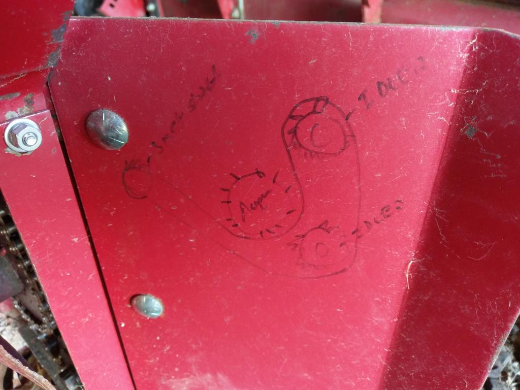

Chris1055 106 #8 Posted November 19, 2017 Ended up getting 10 ft of #40 chain. I'll put new chain on the 42 inch as well. Does anybody have a diagram for this? Share this post Link to post Share on other sites
WVHillbilly520H 10,377 #9 Posted November 19, 2017 Here's what I did for the 42" tall chute I believe it's the same for the short chute, Jeff. Share this post Link to post Share on other sites
