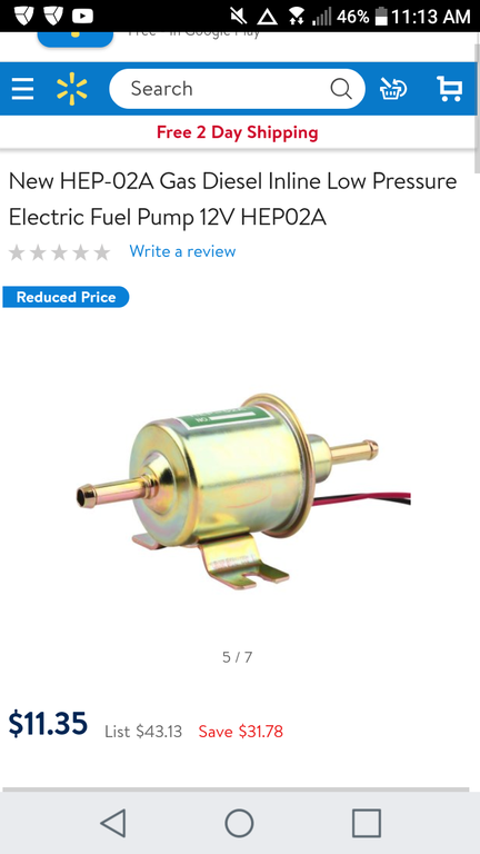

The fuel pump for the M18 is 95$ I think I'll go for one of the much cheaper electric ones
Edited by Devin
Devin
Would this work??
There's a lot of these inline fuel pumps for  8-12$ would one of them be a good idea?
