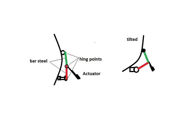

wallfish 20,677 #27 Posted March 4, 2021 8 hours ago, Handy Don said: (in @wallfish's schematic above, if you ram it into a dirt pile there aren't springs absorbing that "tipping" force, it's directly "pulling" on the actuator so it'll just strip the gears in the actuator) Maybe I'm missing something but... Push pull of an actuator is accomplished by an acme screw turning a threaded "nut" similar to something like a C clamp so the impact or pull force is equivalent to pushing a nut down a bolt without spinning it. It's striping limit of the threads is limited by the thread contact area and or the material used for the "nut" part. Some actuators use a spring loaded threaded piece designed to skip threads when too much force is applied and some are made of plastic but the forces cannot spin the acme screw to damage the gears. Maybe it's possible to ram that acme screw out the back or pull the clip out holding the acme screw in place. They are NOT designed for impacts and can certainly damage it but a good quality actuator should be able to handle normal use for this application. The pivot point of the blade will take the majority of the impact forces and that mechanical leverage point up on the back will reduce the forces quite a bit. As you know I'm not an engineer but just trying to understand as that's how learning goes. Maybe a spring added to the end or bottom of the actuator could accomplish a tripping of the blade? Share this post Link to post Share on other sites

wallfish 20,677 #29 Posted March 4, 2021 My drawing used an actuator for tilt up and down of the blade. Not completely necessary but does add some advantages over a fixed position. The clam shell can be pulled by a rope from the lever on the top or use of an actuator. This design isn't intended for scraping up or carrying 300 lb loads of dirt but more of a light duty carry tool for mulch and stuff like that 1 1 Share this post Link to post Share on other sites

wallfish 20,677 #34 Posted March 4, 2021 6 hours ago, Handy Don said: I do fully agree that this can be done with actuators. Just not casually or well or reliably with cheap ones Agreed. This is more of a work around type thing discussion for me to at minimum come up with a good design. Anything done with actuators instead of hydraulics is definitely going to be light duty and slow. What about using bar steel instead of springs to take the trip load impact and the actuator is then used to only tilt it and not take any impact loads? 1 Share this post Link to post Share on other sites
Handy Don 17,563 #35 Posted March 4, 2021 Interesting take and I agree that the solution is to isolate the actuator from impact forces. Isolation is, to me, one of the attractions of the clamshell. When closed, impact is not on its lift or opening actuators but carried directly to the blade and its frame (operator responsible for fully closing before ramming, right)?! With the clam fully lifted, the blade is accessible for use, as well. In your sketch, if the green and red linkages were perfectly aligned an impact on the blade (yellow straight arrow) would cause it to pivot (yellow curved arrow) around the axis (yellow circle) and the force would go into the pivot and into the hinge at the base of the red link. The pivot and hinge base together would exert torque on whatever frame was holding them both, However, if the Red and Green are misaligned, even a little, then the impact is shared by the actuator, the axis, and the hinge base. The effect depends on the forces and angles involved. It could be done like a human knee -- it bends one way easily but locks when straightened out. So there is a lift somewhere, and this lets you tilt the blade back. Now, if there is a bucket attached to the front of this blade, how do you dump it? Share this post Link to post Share on other sites
DennisThornton 4,773 #36 Posted March 4, 2021 7 minutes ago, Handy Don said: Interesting take and I agree that the solution is to isolate the actuator from impact forces. Isolation is, to me, one of the attractions of the clamshell. When closed, impact is not on its lift or opening actuators but carried directly to the blade and its frame (operator responsible for fully closing before ramming, right)?! With the clam fully lifted, the blade is accessible for use, as well. In your sketch, if the green and red linkages were perfectly aligned an impact on the blade (yellow straight arrow) would cause it to pivot (yellow curved arrow) around the axis (yellow circle) and the force would go into the pivot and into the hinge at the base of the red link. The pivot and hinge base together would exert torque on whatever frame was holding them both, However, if the Red and Green are misaligned, even a little, then the impact is shared by the actuator, the axis, and the hinge base. The effect depends on the forces and angles involved. It could be done like a human knee -- it bends one way easily but locks when straightened out. So there is a lift somewhere, and this lets you tilt the blade back. Now, if there is a bucket attached to the front of this blade, how do you dump it? I was concerned and going to take the other approach, but now I'm thinking you are on to something. If those "hing points" were a tad overcenter they have to take the brunt! Maybe a good way to use linears for over their stress limits! Gads I love this forum! Why not? Just a tad overcenter and take the linear out of danger? Not sure how that I see how to do that everywhere but seem simple here! Share this post Link to post Share on other sites
Handy Don 17,563 #37 Posted March 4, 2021 10 minutes ago, DennisThornton said: I was concerned and going to take the other approach, but now I'm thinking you are on to something. If those "hing points" were a tad overcenter they have to take the brunt! Maybe a good way to use linears for over their stress limits! Gads I love this forum! Why not? Just a tad overcenter and take the linear out of danger? Not sure how that I see how to do that everywhere but seem simple here! Putting the green-red linkages past center alignment where the hinge is on the blade side and up against the red block (blue arrow), isolates the actuator. Still don't see a dump option here Share this post Link to post Share on other sites

DennisThornton 4,773 #39 Posted March 5, 2021 1 hour ago, Handy Don said: Putting the green-red linkages past center alignment where the hinge is on the blade side and up against the red block (blue arrow), isolates the actuator. Still don't see a dump option here Just protects the actuator. Not sure about everything else. Share this post Link to post Share on other sites
wallfish 20,677 #40 Posted March 5, 2021 1 hour ago, Handy Don said: Still don't see a dump option here See previous drawing with the clam shell for dump Share this post Link to post Share on other sites
Handy Don 17,563 #41 Posted March 5, 2021 1 hour ago, wallfish said: See previous drawing with the clam shell for dump Separate actuators for lift, tilt, and dump then. In the design I'll get back to as soon as I stop reading and responding to posts here I've got only a clamshell actuator. Lift is done separately. Share this post Link to post Share on other sites
