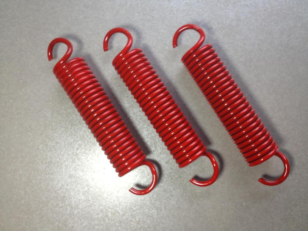

GlenPettit 1,718 #2 Posted November 9, 2017 (edited) Those Springs are still available, same a is used on rear tillers: (see the Venders section. Glen Pettit Restoration Parts ) (exact specifications are in there also). Edited November 9, 2017 by GlenPettit 1 Share this post Link to post Share on other sites

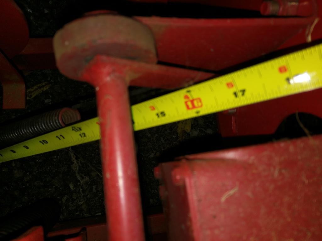

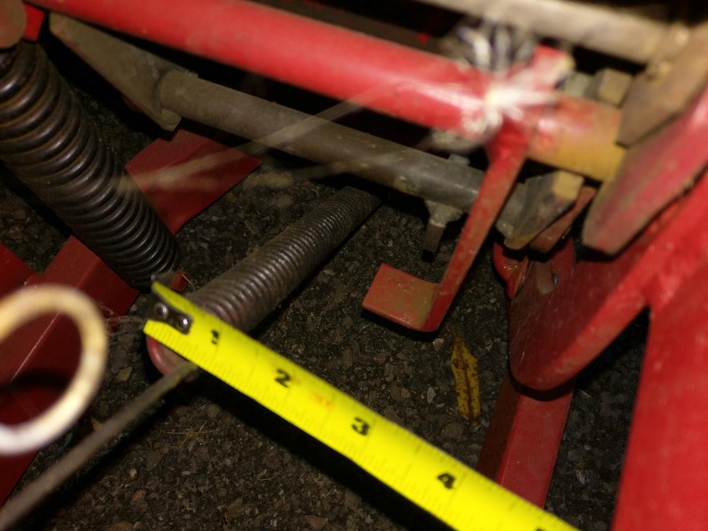

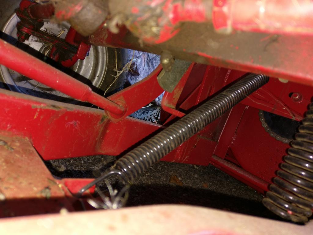

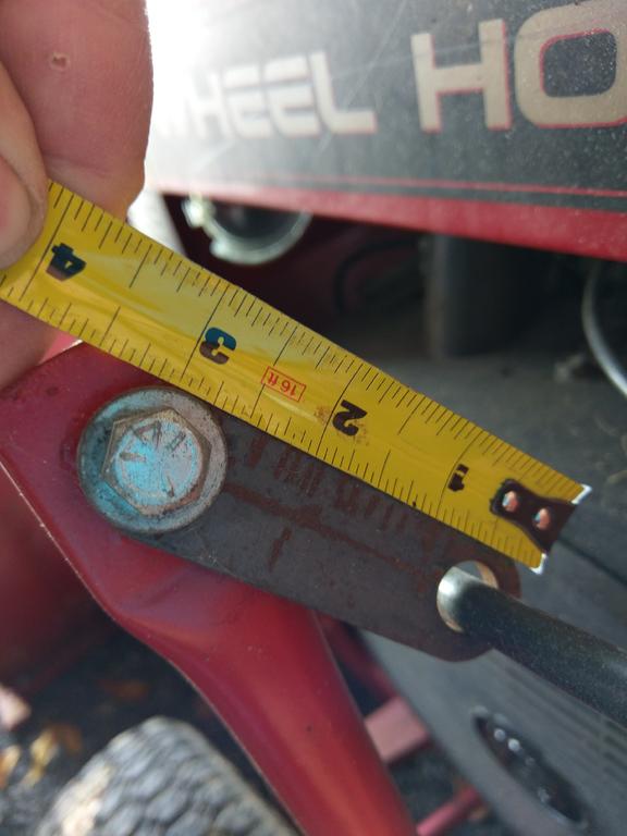

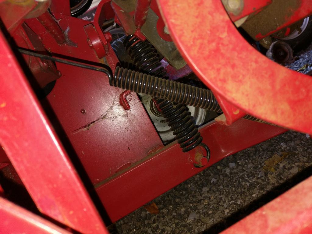

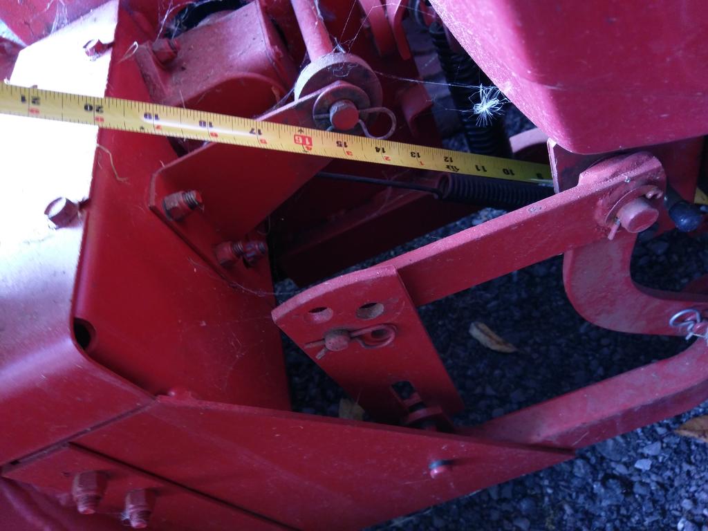

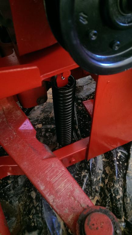

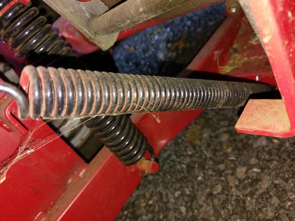

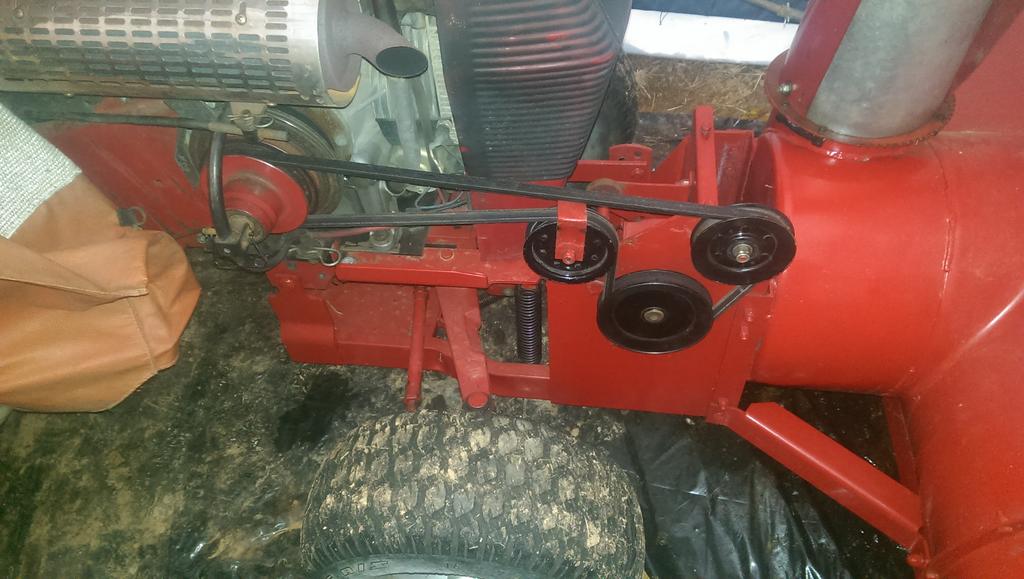

WVHillbilly520H 10,376 #7 Posted November 10, 2017 (edited) 1 hour ago, RJC1965 said: WVH thank you for the pictures I did see an old post regarding the anti sway bar and It showed the one you made. How big of a wheel did you mount on the bar. I like your modifications for the chute rod what did you use to off set it I can not tell by the picture and did you make yours longer it looks like you have an extension on it. Yes I made a rod extension (WH actually made a kit) so it comes back into the cab, the other piece is 1/4" thick by 3/4" wide 2-3" long with 3/8" holes drilled in both ends and bolted to the rod support really easy to make I'll get some close up pics later, Jeff. And the long spring is actually for the belt tension Edited November 10, 2017 by WVHillbilly520H Add pictures 1 Share this post Link to post Share on other sites
lynnmor 8,105 #8 Posted November 10, 2017 My spring is 6-1/4" overall length, 1" diameter with a wire size of .120". The closest thing I found at McMaster is: https://www.mcmaster.com/#9654k424/=1a71goi 1 Share this post Link to post Share on other sites
WVHillbilly520H 10,376 #9 Posted November 10, 2017 I took a few more pics...16" OAL 1" diameter and probably 1/8" wire thickness. Share this post Link to post Share on other sites
