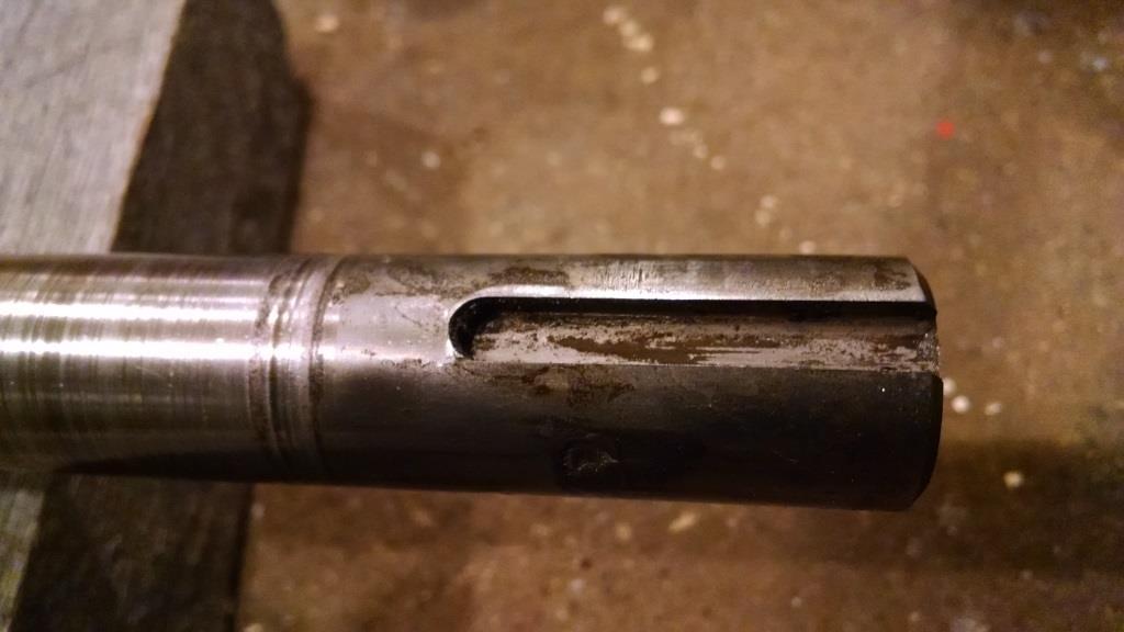

nj1052 15 #3 Posted November 9, 2017 Well done! A spot on diagnosis! I have pulled both hubs and both keys are wrecked as are the slots in the shafts but the hubs look fine. Any suggestions for a fix would be very much appreciated! 1 Share this post Link to post Share on other sites
Achto 31,114 #4 Posted November 9, 2017 A new set of keys and an addition of a second set screw 90 degrees from the original set screw (if your hubs don't already have a second set screw) will buy you some time. Eventually you will probably need to repair or replace the axles. I have removed the axles, welded the original key way shut, and cut a new full length key way in some of my axles. I realize not every one has this ability, but a machine shop should be able to do this for you if you take them your axles. 3 4 Share this post Link to post Share on other sites
Ed Kennell 45,025 #5 Posted November 9, 2017 Here is a key way fix I did in 2015. 2 5 Share this post Link to post Share on other sites
nj1052 15 #6 Posted November 9, 2017 Many thanks to you all for taking the time to give me your thoughts/solutions. I think I will pull the transmission, extract the shafts and take then to a friend who has more skill than me and also has a Bridgeport mill. The idea of welding up the damage and re-cutting new slots sounds like a good long term proper engineering solution which will see me out! Once again thank you from the UK 3 Share this post Link to post Share on other sites

nj1052 15 #13 Posted December 6, 2017 I am aware how annoying it can be when help is requested and given but then no more is heard so here is my update on my transmission problems. As suggested I went ahead with cutting new keyways in my driveshafts. After a bad job by a so called professional, not my friend incidentally as he was too busy, I bought a solid carbide cutter and did it myself on my worktop milling machine. This is a fairly light weight machine but if you go gently it is pretty good. In the meantime I had ordered the parts I needed for my gearbox from Lowell who was very helpful . Many thanks Lowell! Delivery took a while but it was quite fun tracking the package from the USA to home. Once the parts arrived it was just a case of assembling the new bearings, seals and 3rd gear into the box and buttoning it up. My old wheel hubs were very bad from the woodruff key walling so I used a pair from a gearbox I found from Ebay. The tractor is now back together and is fine. I am now carrying out a refurbishment of my 10 year old mower deck so I am ready for next season. Once again many thanks for the help given by the members of this forum. 3 1 Share this post Link to post Share on other sites
