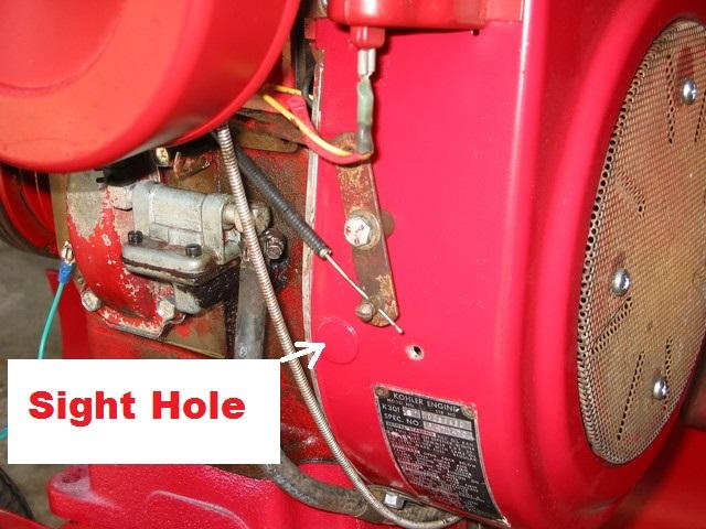

953 nut 64,486 #17 Posted November 10, 2017 10 hours ago, Bill D said: If you change the points and condenser be sure to set the timing You may need to remove the flywheel cover tin to do this if there is no sight hole. Kohler static_timing.pdf Share this post Link to post Share on other sites
