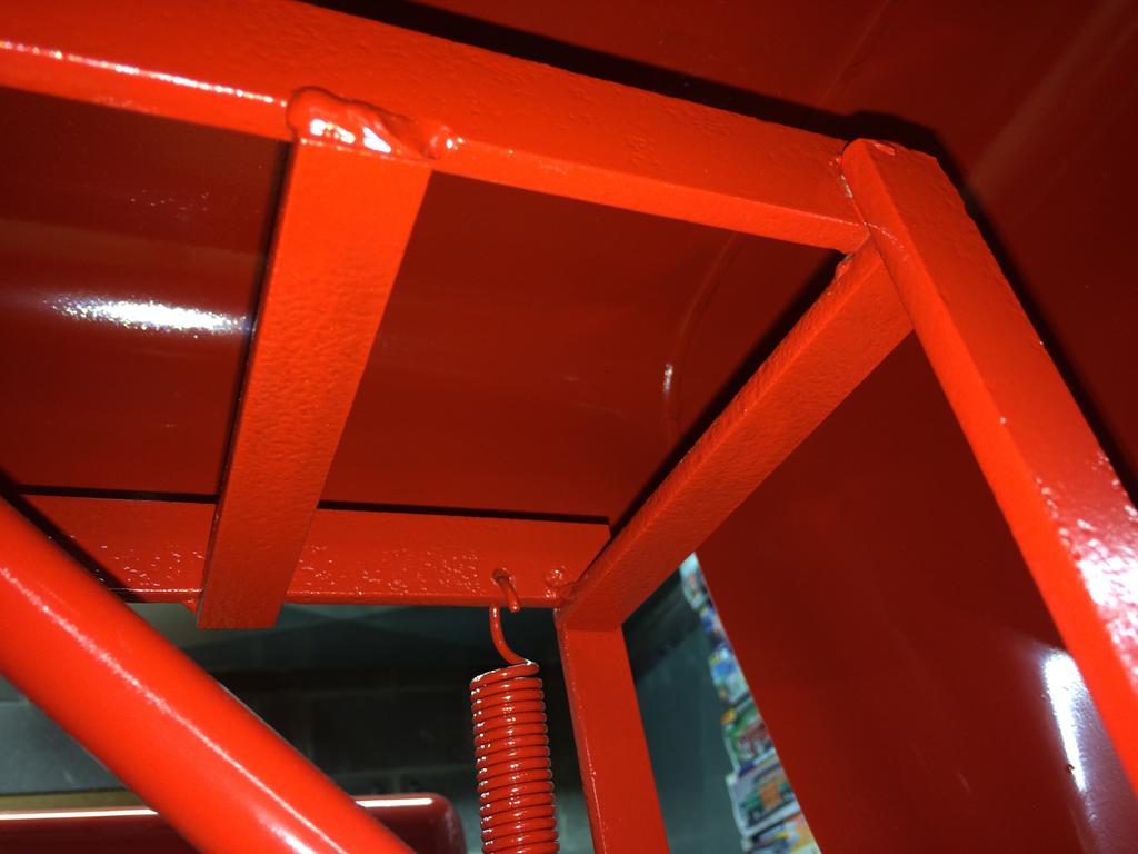

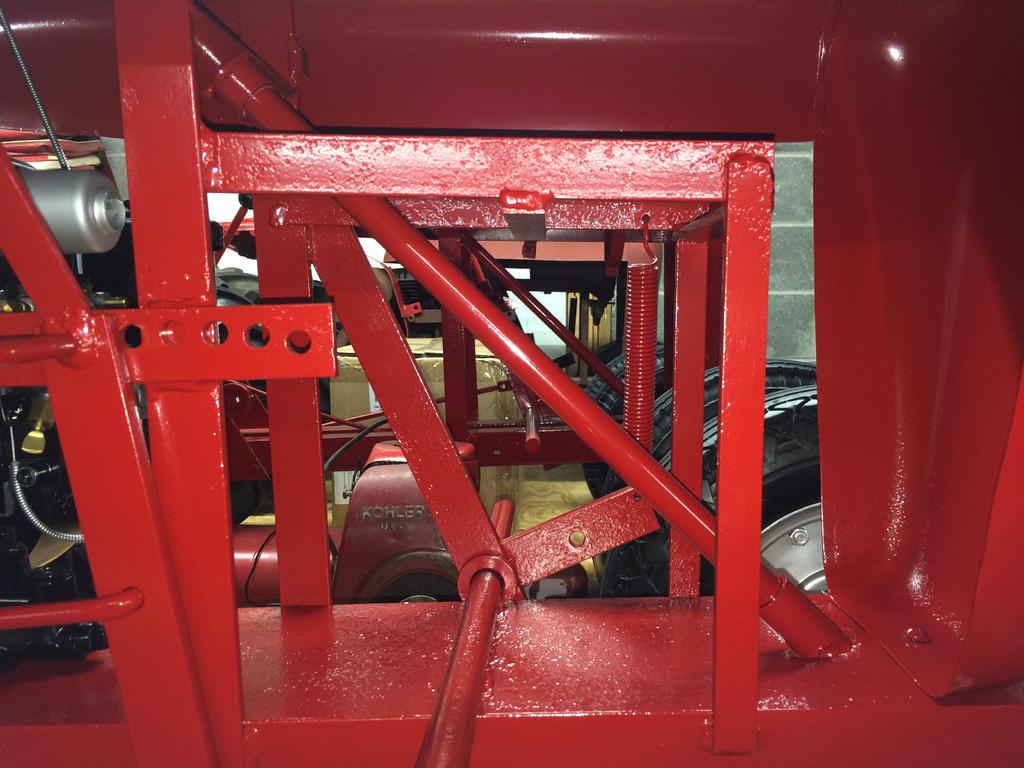

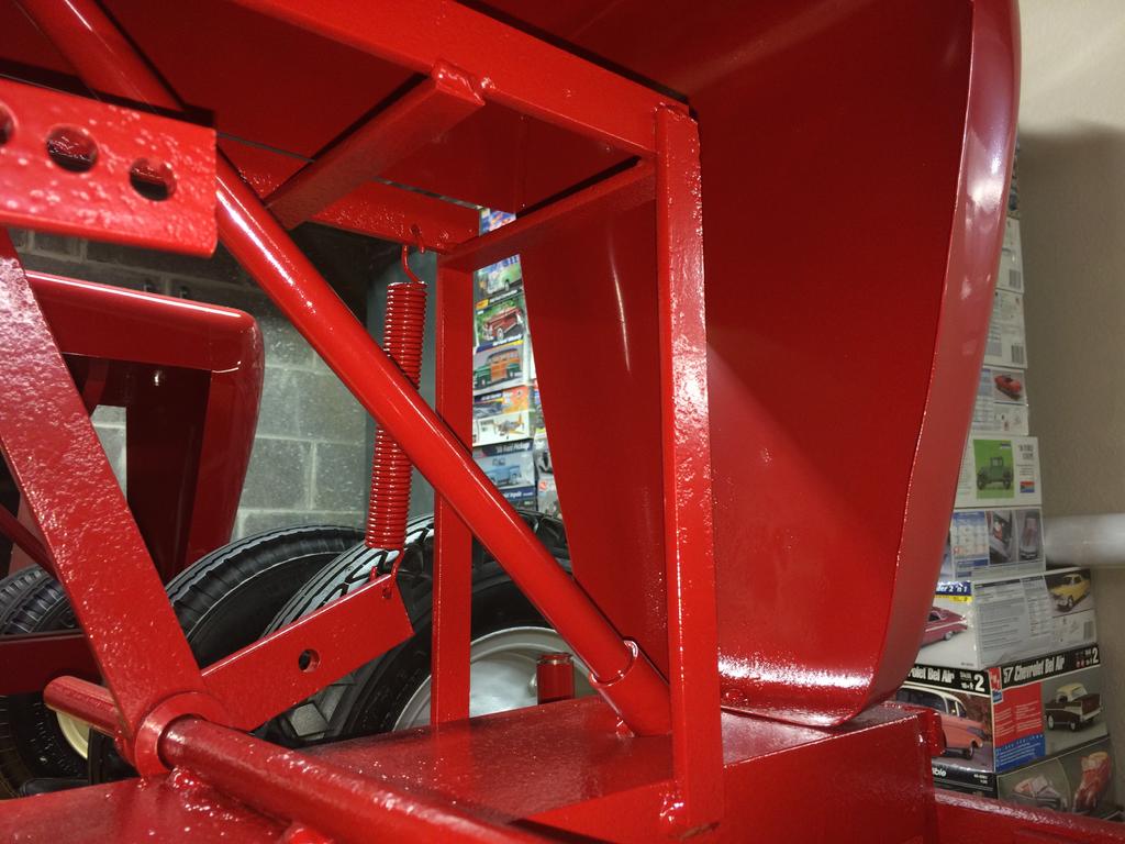

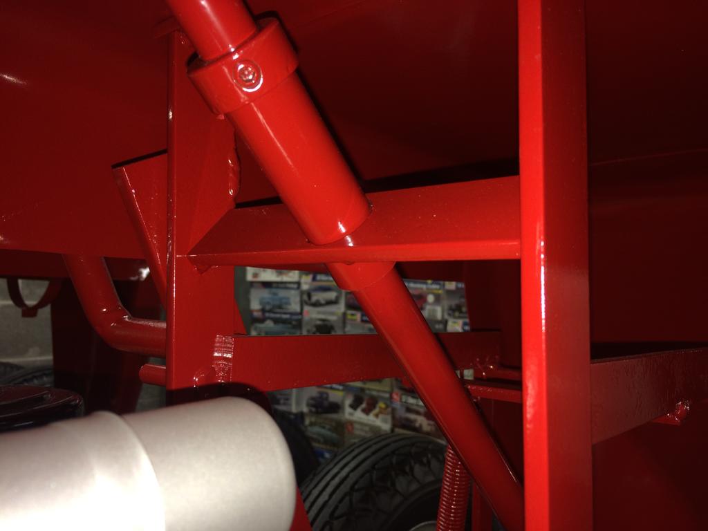

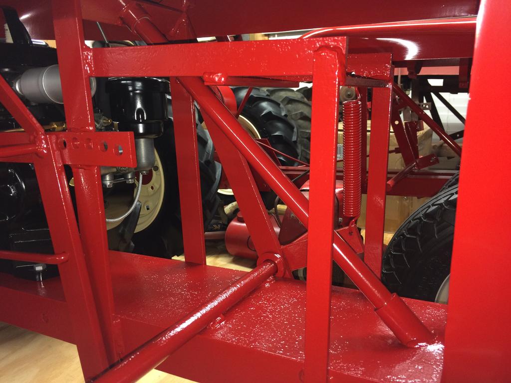

rj35hunter 289 #2 Posted November 7, 2017 I can provide you pictures and dimensions if needed when I get home tonight..... 1 Share this post Link to post Share on other sites
formariz 12,045 #3 Posted November 7, 2017 45 minutes ago, rj35hunter said: I can provide you pictures and dimensions if needed when I get home tonight..... Thank you . Dimensions will also be greatly appreciated. Share this post Link to post Share on other sites
rj35hunter 289 #4 Posted November 8, 2017 Flat stock going up from frame to stand is 10" long 3/4" wide 1/4" thick. Piece going front to back is 10" long 1" wide and 1/4" thick. 2 pieces going side to creating the bottom for the tank are 6" long 3/4" wide and 1/4" thick. Let me know if you need any different pics etc Clay 1 Share this post Link to post Share on other sites
formariz 12,045 #5 Posted November 8, 2017 (edited) Perfect. Thank you very much. Does tank in that system just rests on supports, or is it also strapped to same? What year tractor was this frame in? Edited November 8, 2017 by formariz Share this post Link to post Share on other sites
rj35hunter 289 #6 Posted November 9, 2017 Your welcome. The tank sits on the bottom pieces and a strap Ins around the tank....this is my 1955 RJ25 which doesn't have the tank. I used this one so it will show the pieces better. This framing for the tanks should only be in 1955 models. 1 Share this post Link to post Share on other sites
