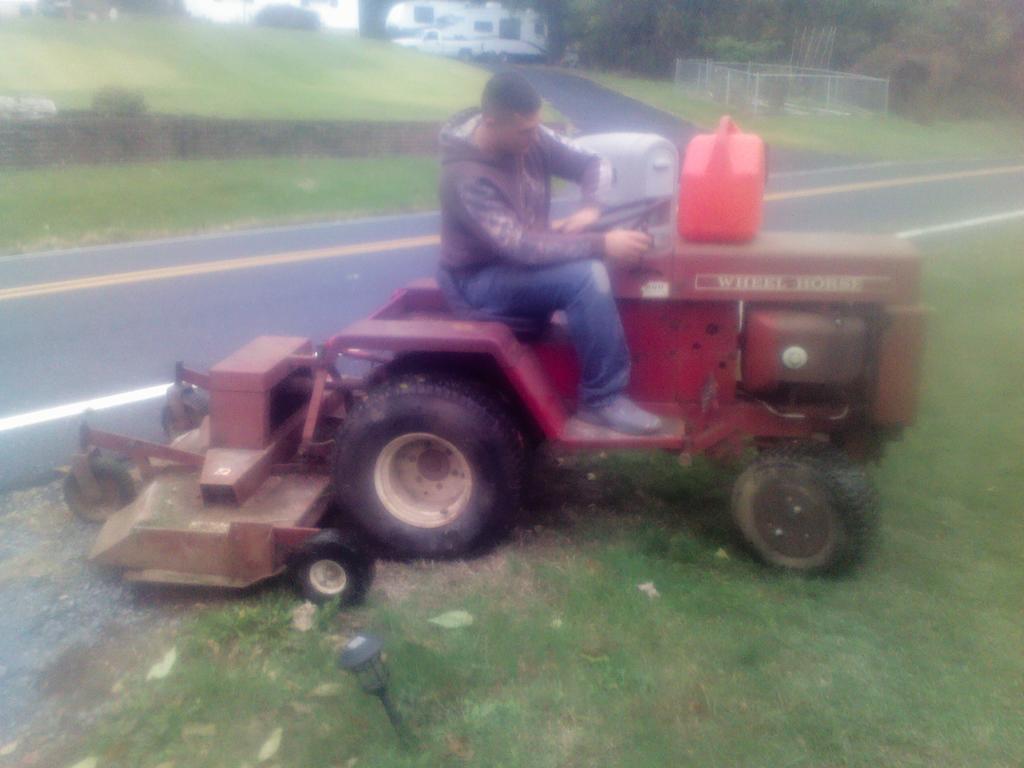

Big_Red_Fred 1,548 #6 Posted November 4, 2017 I will post pics when i get home, here's my Son on his 200, his Butt is glued to the seat every time i go there ! Nut Bag LOL 2 Share this post Link to post Share on other sites

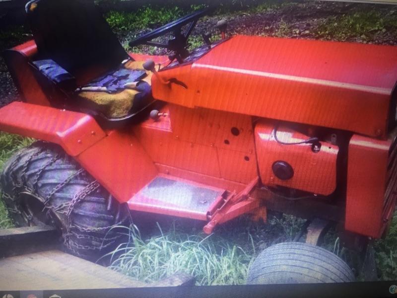

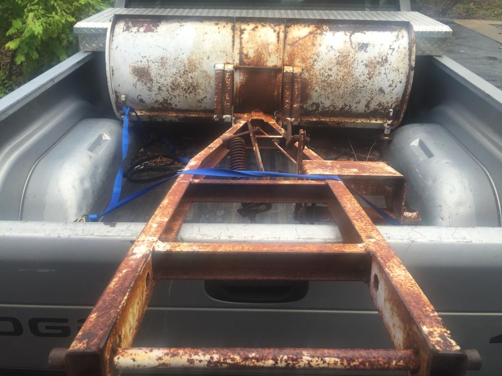

Big_Red_Fred 1,548 #12 Posted November 5, 2017 Well, i didnt make it yet To Burgettstown Pa, i went west but North west of there to Washington Pa to Collector Ricks House & picked up a Plow for Farmer Alex's D, Blade Rusty from sitting out doors for 43 years, but ill clean it up & some Fabricating a Handle for Turning blade, Ericj said i can use his to Fab 1 up, Trying Next Sunday Early for that other place with the D, Its a D200, not a D180 Good Eye Ericj ! Evidently the man has no clue what it is, i will make a Offer, but grabbing that plow too before i make the offer, heres a pick of the plow i brought home & a pic of that D200 below Pittsburgh, Pa, You Guys know where i can Pick up a control Lever for blade let me know, save some time, BRF Share this post Link to post Share on other sites
