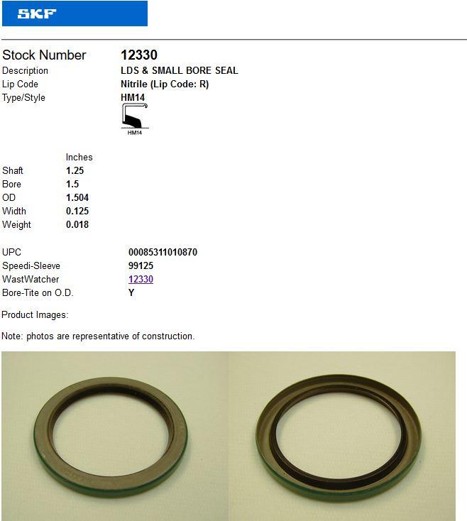

doc724 925 #4 Posted November 8, 2017 Yes, there are two seals. On the inner seal, the lip faces in. On the outer seal, the lip faces out. If you pull an IPL, you can see the two seals and the info I just provided. The old ones will be a ***** to remove if you do not disassemble the unit as you cannot get behind the outer seal to remove it when the shaft is in the way (and the trick of drilling two small holes in the seal shell does not work well when the lip is facing out). BTW, get good SKF seals to reinstall. I know on some of the 3/4 transaxle shafts, Toro seals are plastic. Not good when your spouse leaves the brake engaged and drives the machine Share this post Link to post Share on other sites
