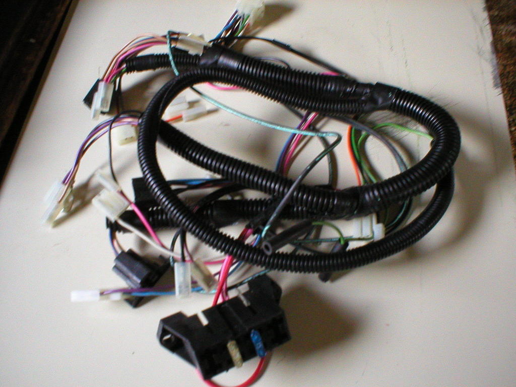

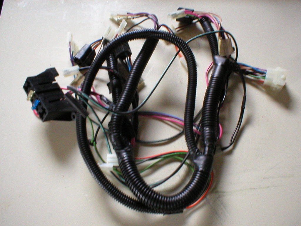

echoffmann 2 #1 Posted October 30, 2017 I have a 1995 416H Model: 73421 / Ser: 5900214 that I picked up running. Sadly for whatever reason the electrical has been butchered and what was taken out was handed to me in an ice cream bucket. Previous owner stripped it down to hot-wiring the starter to a push button , that is ran by a toggle switch to turn main power on or off. Can I at a bare minimum get the charging feature back, right now I have to keep it on a tender? It’s a mess, I don’t know where to start. There are wires tagged “Relay 1” and “Relay 2” but I don’t see any relays, no clue where the fuse block should mount or relays, all the ends for the gauges or micro switches are gone. The 9 pin connector is still on the motor side. If anyone can send me photos of their wire harness by the cab showing connections and ends, that would be super helpful, or if anyone knows how to just get charging function added back I could live with that. I did pick up a wire harness from another year 416, Harness #116724-a (attached images)...though not the same part number as mine calls for, when I compare the drawings from the online microfiche, they are the same wire layout...maybe different wire color differences? Thanks! Share this post Link to post Share on other sites

cleat 8,723 #4 Posted October 31, 2017 That harness you picked up looks great. You may need the engine harness as well if that has been destroyed also. Other than that, download the manual and carefully follow the wiring diagram. I would begin with the basic stuff like run, start, and charge, then work up to things like warning lights etc. 1 Share this post Link to post Share on other sites
